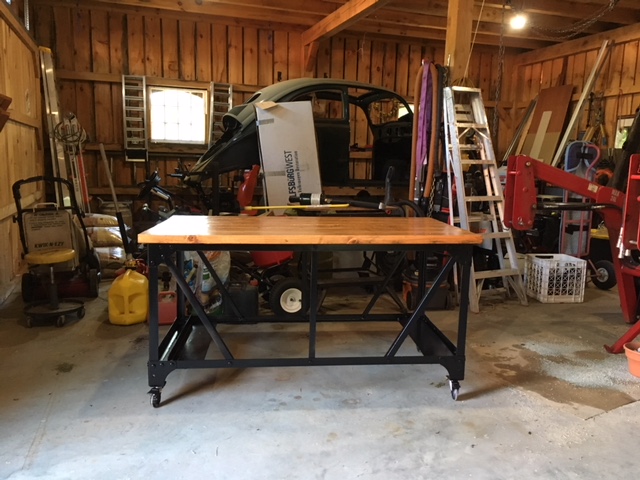

By the way the real reason I like my Woodmaxx is the shipping container makes an awesome work table
