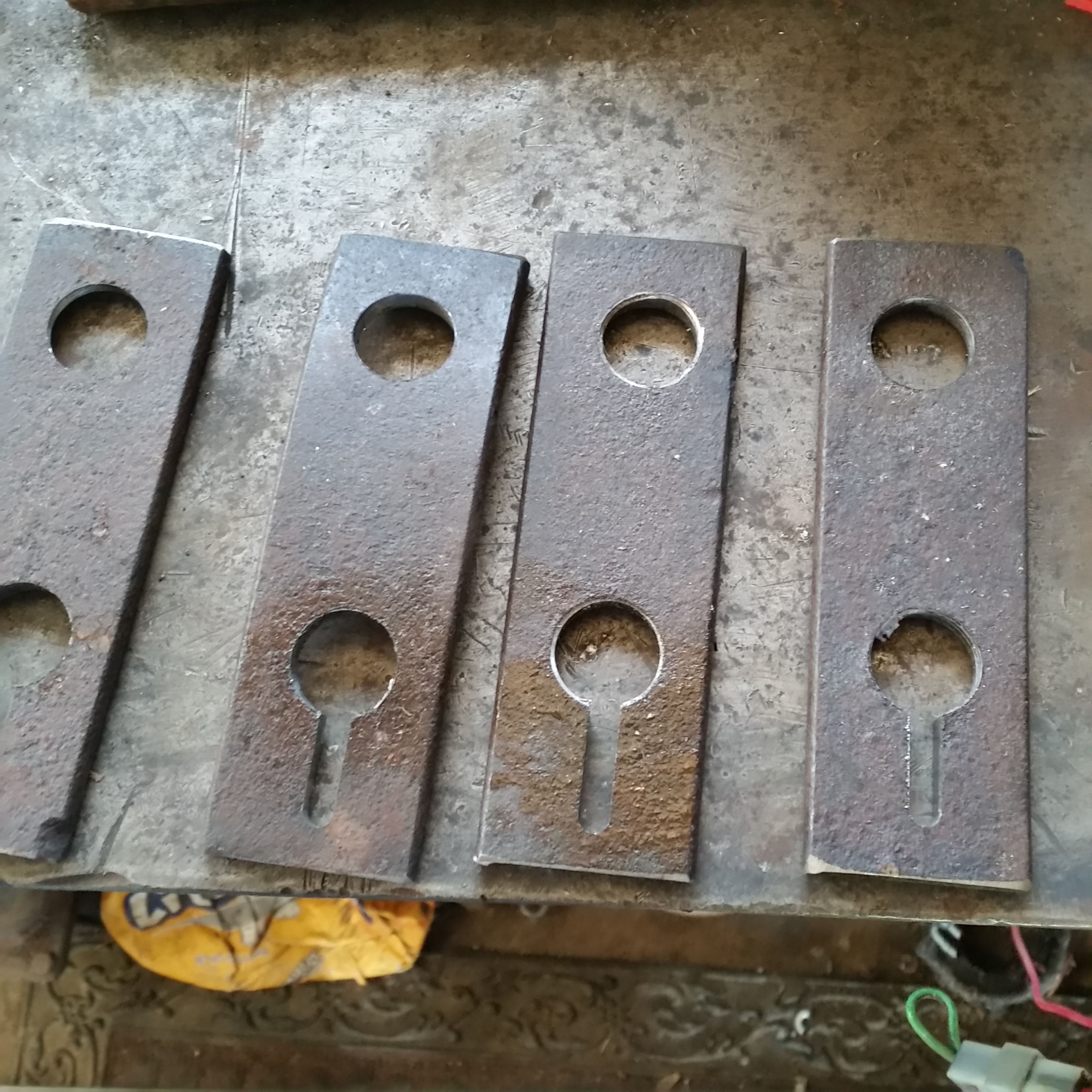

I mow a pasture that I want to leave about 8" high. I made some links to connect the 3 point at the toplink. I can adjust the cutting height easily. I don't need a pretty cut, just want the tops (weeds) cut off.
