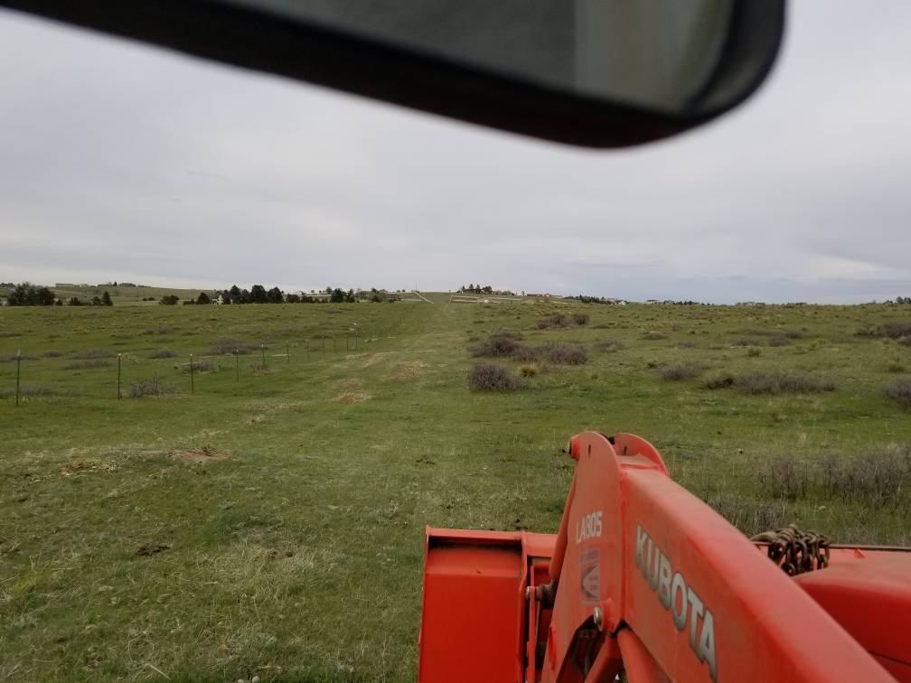

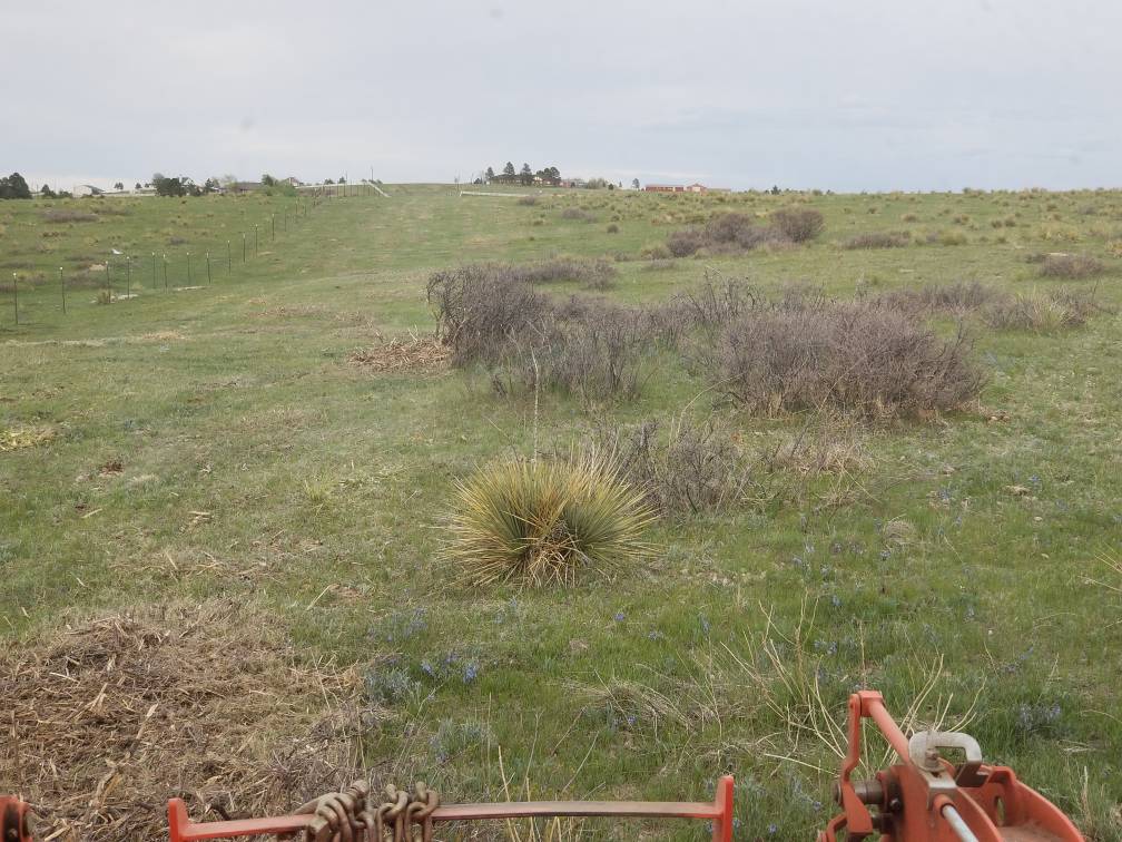

RoyJackson,
This actually is my yard and not a field as it might have come off.
Aaron,
Thank you. It'll all be more clear once I actually get everything together I'm guessing.
Thank you both
