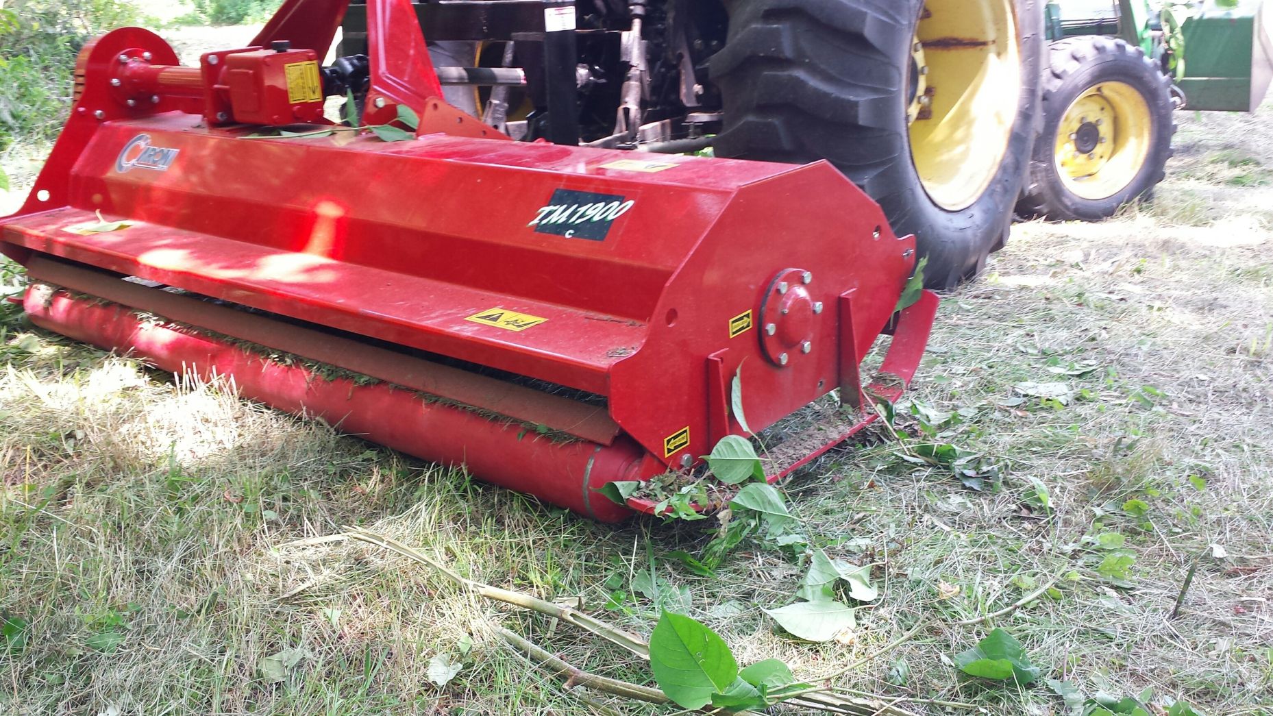

Your field looks great! It looks like your skids are very low, are you getting any scraping at all? When in use, those skids shouldn't be touching the ground. The flail should be supported by the rear roller and the 3pt hitch.
   / Let's talk flail mowers #4,683
Agree Roy's skids are set pretty low. If he's not gouging turf then I guess his field is nice and smooth and level. I'd tear up the grass in areas I mow if my skids were that low. And, remember, the skids are just there mostly to protect the rotor and knives when the mower is dismounted. I suppose it isn't good to leave the knives in contact with wet soil for long but certainly no harm will come from being left on soft turf for a week or so. Mine lives outside on turf over sandy soil during the off season. No harm after ten years.
   / Let's talk flail mowers #4,684

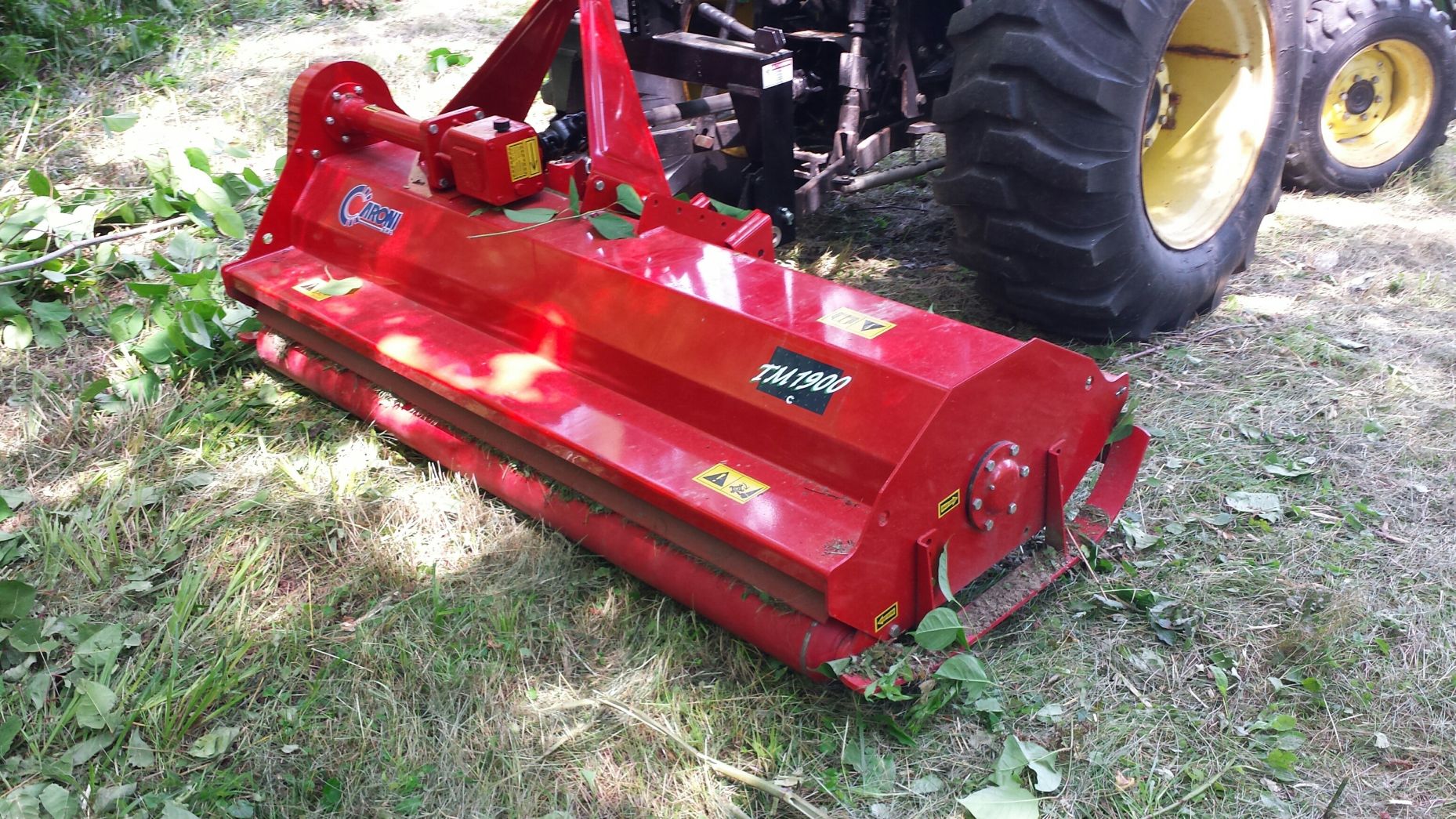

The one picture with the skid shoes set so low was taken before any mowing...I re-positioned the shoes much lower before mowing (one hole up). I'll re-position them again (lower) before mowing again to see how that works.
These pictures clarify the skid shoes.
I set them when I lowered the roller...I reckon I can re-position them. I'll admit, I a novice when it comes to flail mowers...I'll learn as I go and heed the advice of fellow TBNers with more experience than I.

The pics you posted above are good, that's exactly how you should be running the flail mower, with the skids not making ground contact. No need to readjust! The first pics you posted had the skids touching the ground. If they touch the ground you'll get gouge marks all over unless you have perfectly flat ground.
You've got it figured out, nice looking unit!
