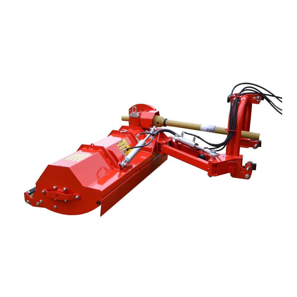

You mant to look at a Del Morino Super Centurion as well...
Tractor Tools Direct | T62 Hydraulic Offset Flail Mower
Also, makes it easy to replace the hammers...:)

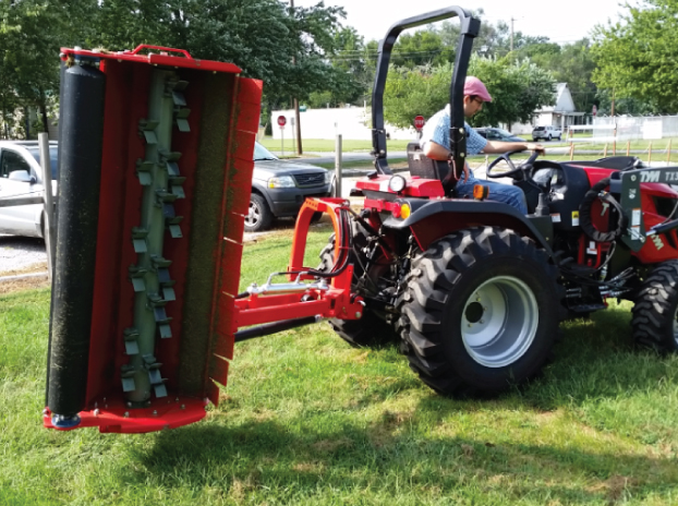

I noticed these can also be raised/tilted vertical to cut trail edges or along woods. They look very versatile, but the 180SI and 180SE I looked at were $6,900 - $7,400.
The nice thing about these flail mowers is that they were are designed and built for vineyard work to save on labor expense and eventually became effective for pruning nut and fruit trees.
They have always made high quality vineyard and orchard equipment that is used to prune vertically in vineyards and berry farm rows and also for pruning/trimming estate hedges that are extremely long in total length to save time and money.
Their use for trimming along trails and mowing ditches came along with the ability to be shifted to the side to allow the flail mower to prune hedges, along grapevine trellises etc.

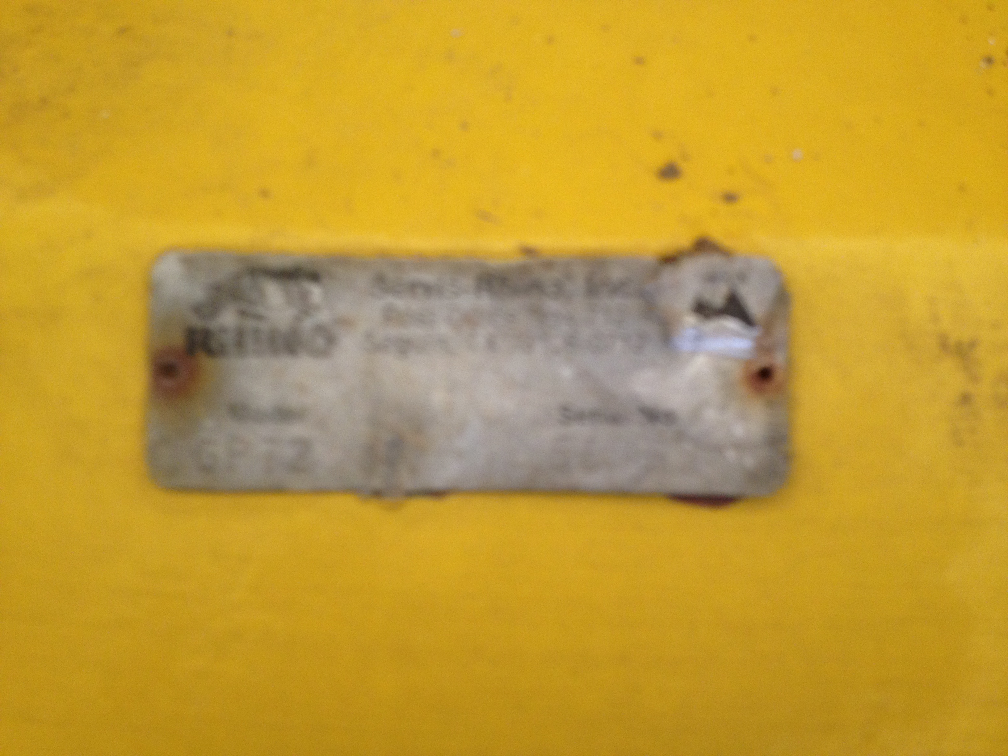

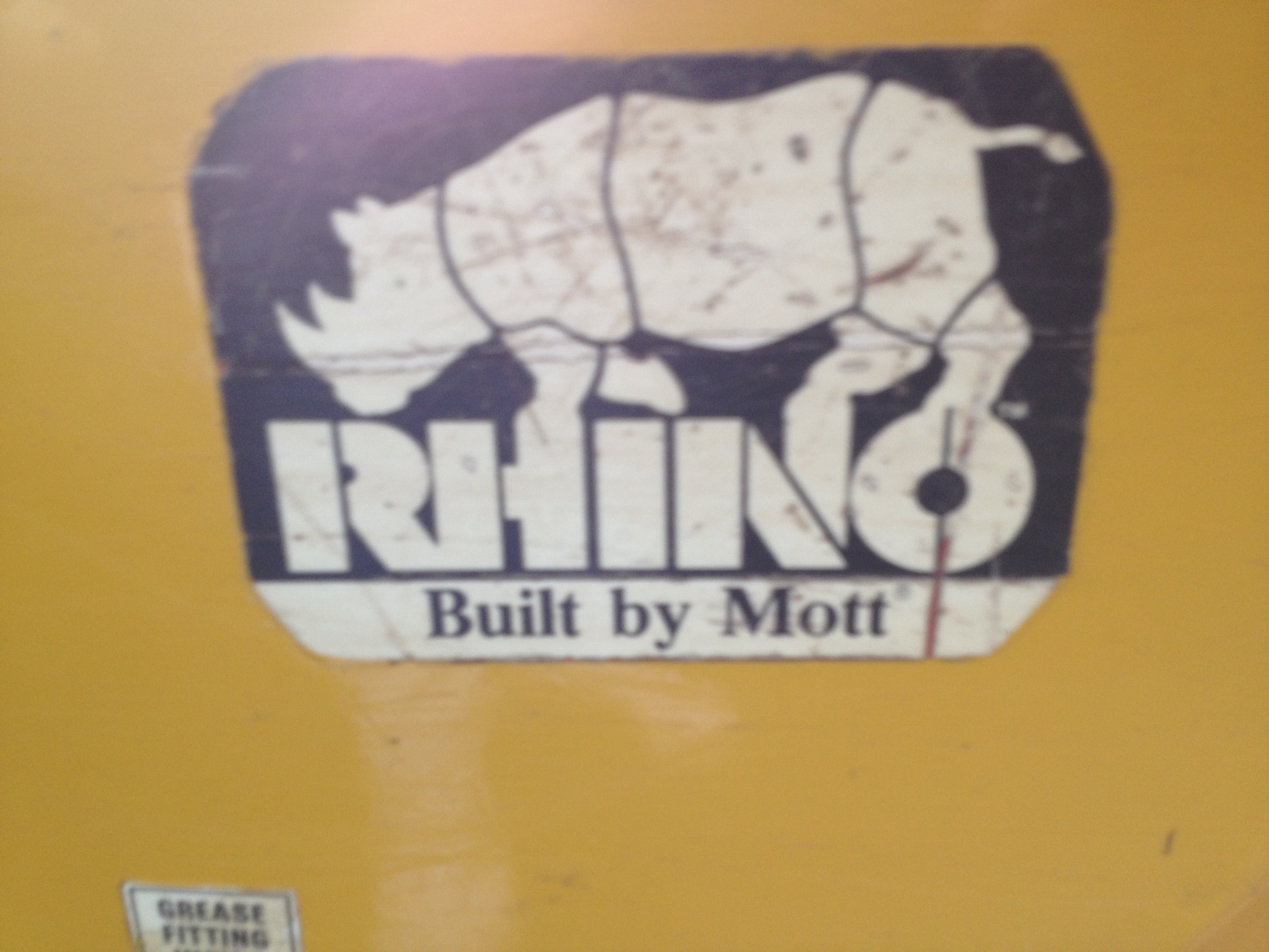

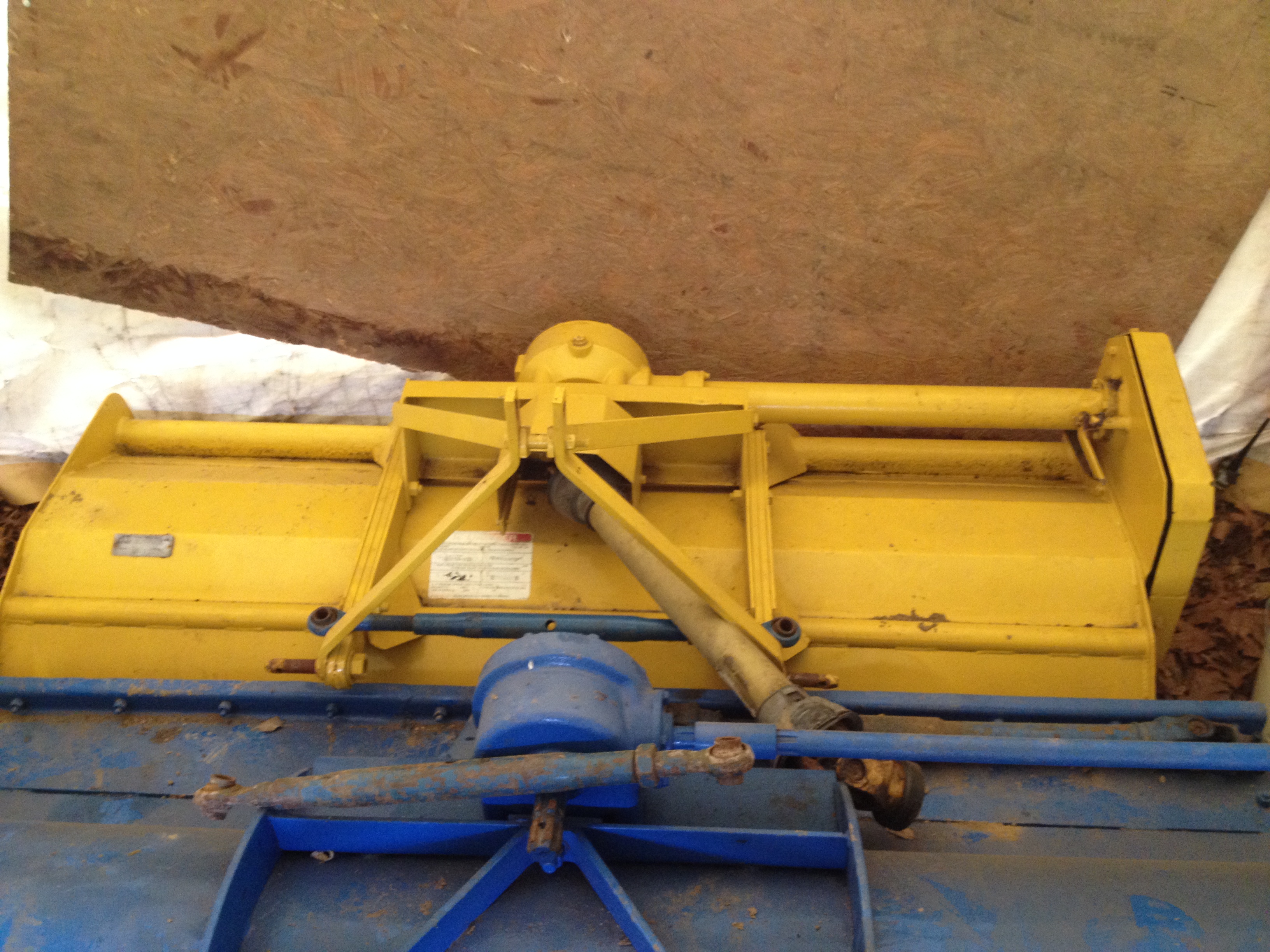

GENTLEMEN, I have been reading this thread from page one for quite a while, actually a very long time, tremendous amount of information, 16 mega tons of info, I currently have a 1999 DEERE 670 compact tractor, I do not have a loader nor loaded tires, nor any front weights, I currently cut three acres with a 4 foot Deere rotary cutter looking to upgrade to a flail mower, I would also like to do some trail cleanup, I have located a 6 foot MOTT RHINO flail mower in great condition it has new drum bearings, new belt, looks well taken care of, it has some cutters of the y-type that are broken, do I want to replace the cutters with a paddle cutters, I only cut the field twice a year, the brush does start growing in during that time, maybe cut it with rotary then the flail ? even field tested the mower on the owners old Ford tractor only vibration was getting the drum up to speed, the sheet metal is not even rusted badly, will I be able to lift it and spin it with my 18.5 hp engine, and will I have to replace the driveshaft due to length, the reason I ask is the flail is about 265 miles away, did not think of measuring the shaft or looking at the spline, Many thanks EDDIE

Generally we want to see 4-5 PTO hp per foot of mower. Your 670 would handle a 4' easily, a 5' in most conditions. A 6' would generally be considered to be too large for your HP. As far as driveshaft length, it is pretty hard to tell without hooking up and measuring. A 6' flail would be great behind a 870 JD. The mower looks pretty good.

I had a 670...great little tractor, but with about 17 PTO HP, I think that 6' flail would be too much for it. At best, it would be very slow going as the engine would bog down if the brush has any height to it.
I think the 670 could lift it...but not much lift capacity to spare. You would need 4 front suitcase weights, at least.
As much as I hate to say it...but I think you should pass on the flail mower and look for one 4-5 feet wide.
