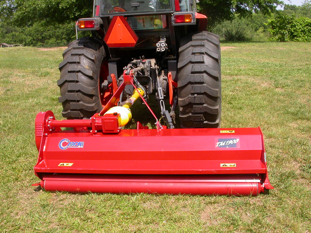

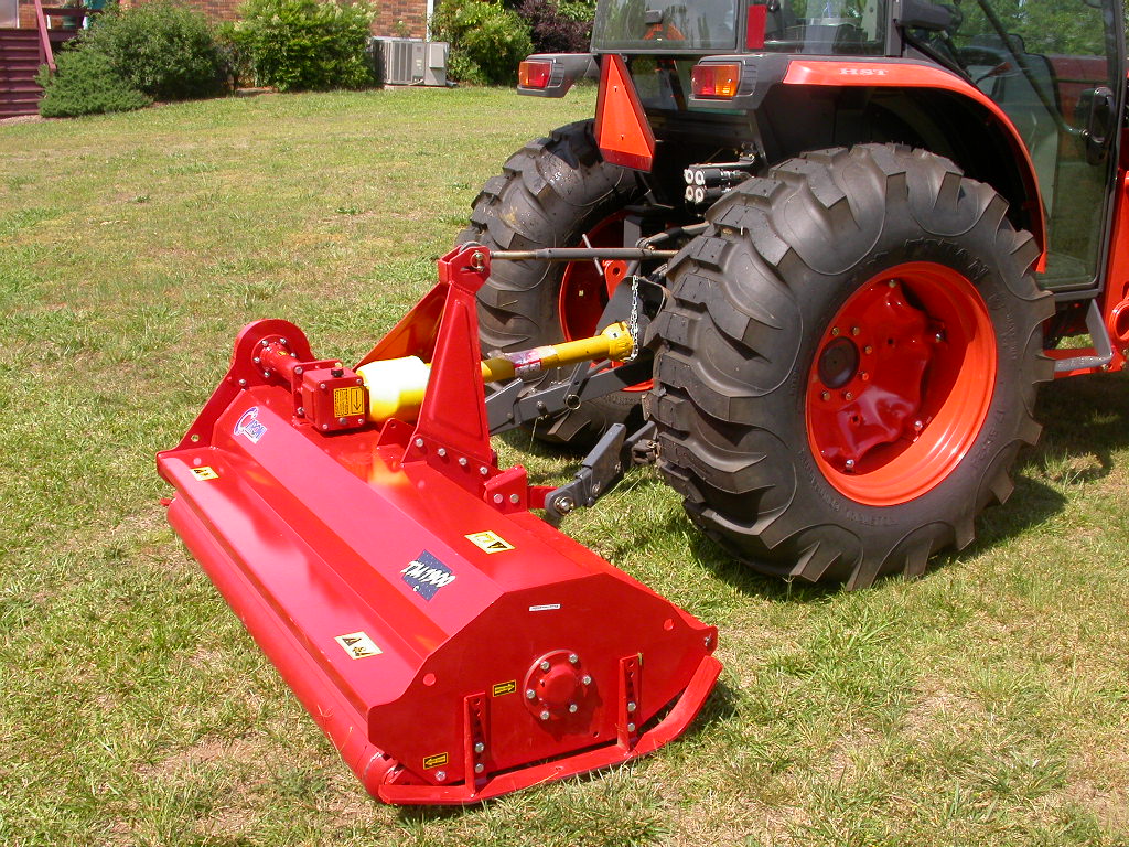

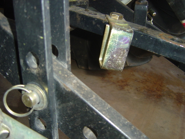

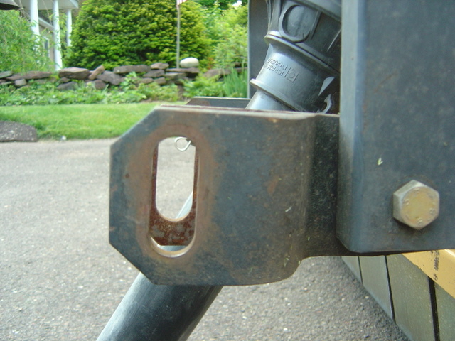

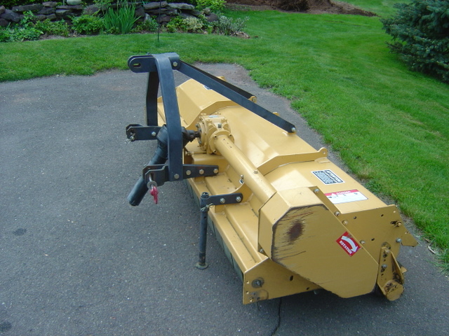

My Caroni TM1900 arrived today...........looks well built and can't wait to try it out.....here is a few pics.....Mike

Haven't seen one that clean in a while. Don't be upset when the gearbox vent cap burps a few ounces of oil after heating up. It's just like a two month old kid that burps up a bit of dinner on a regular basis. You can either let it burp up all the excess (it doesn't need as much oil as the dipstick suggests) or you can put a riser extension on the vent cap which some of us have done. Do a search in this thread if you want to do that as you need a very specific metric sized extender that you will not find in Home Depot or Tractor Supply. Easy to get by UPS from a place in Maryland for about ten bucks. Details are buried in this thread somewhere.

Good looking unit and good pic

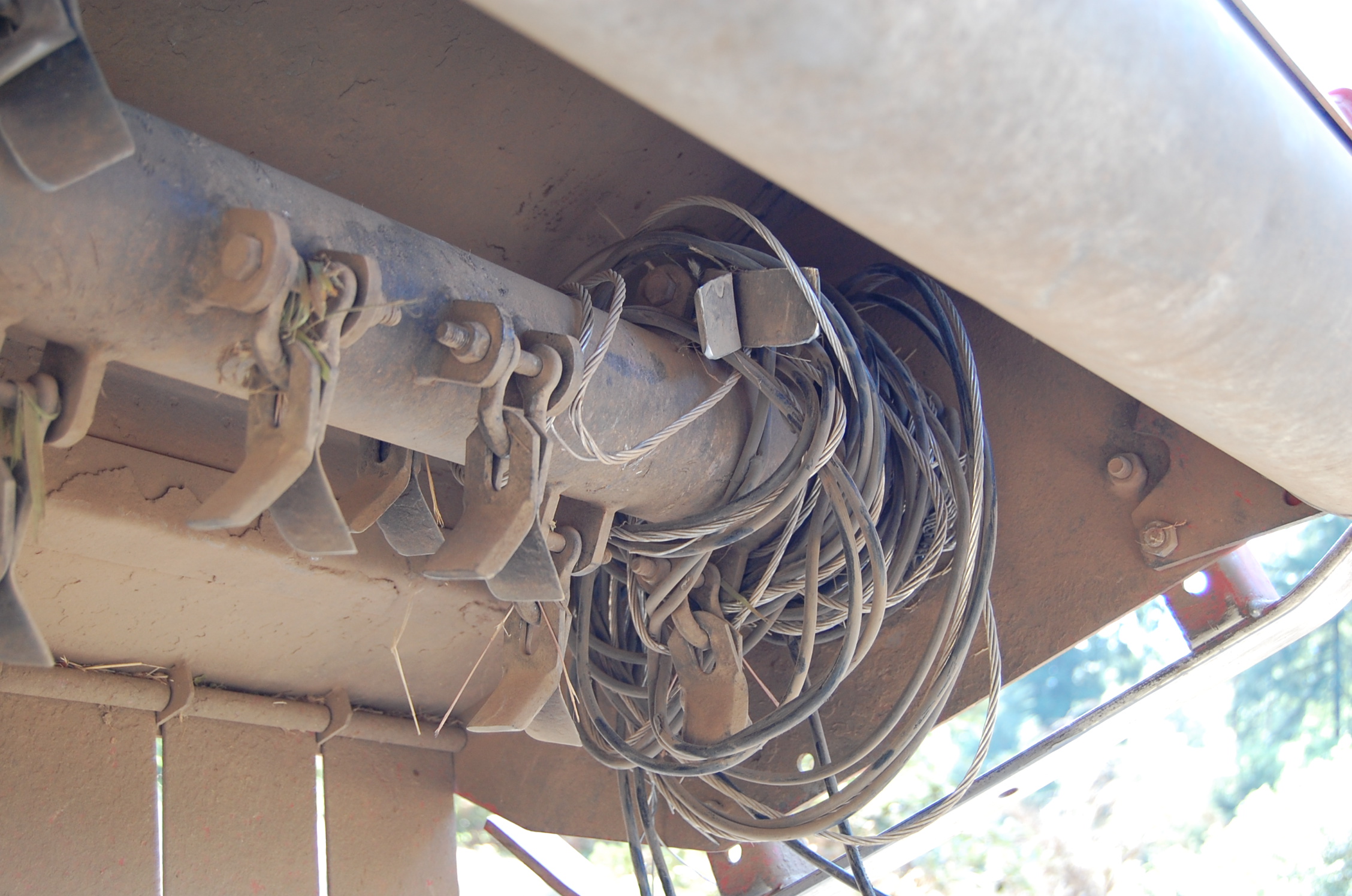

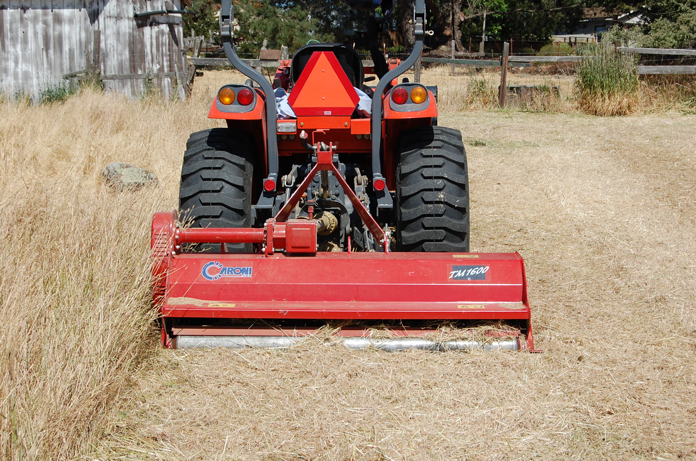

I have two customers fields that I mow every year with my Caroni flail that are very rocky (seems I'm the only fool who'll do it!). I carry spare clevises, bolts/nuts and blades just in case. I have broken clevises in the past on these fields and have had to search for missing blades afterwards. I wouldn't dare use a rotary in these conditions. The other great thing about a flail is they tend to find things that you never knew were there! But they also do a nice job.
Notice the "little" rock peeking out of the grass to the left of my tractor?
