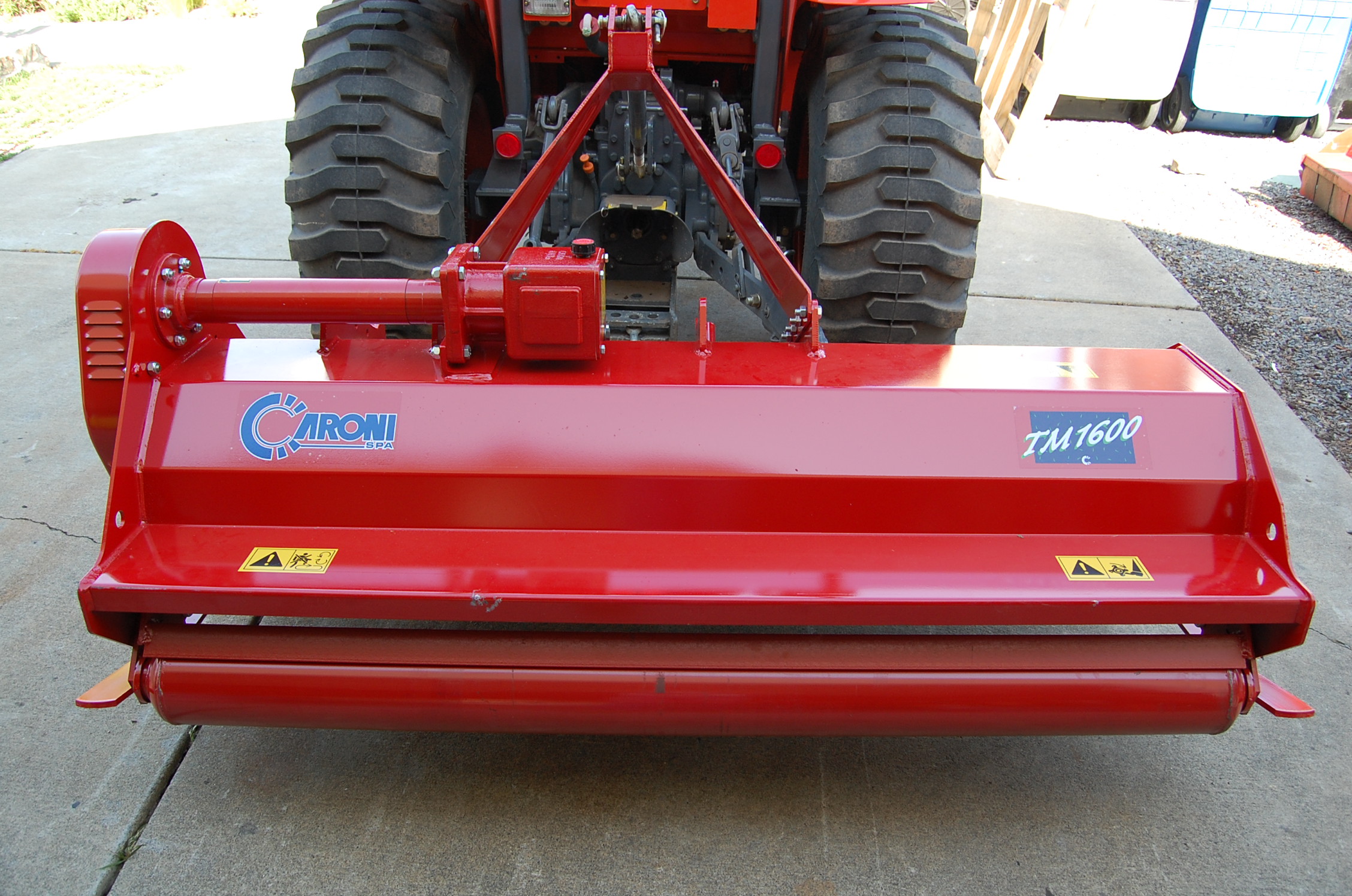

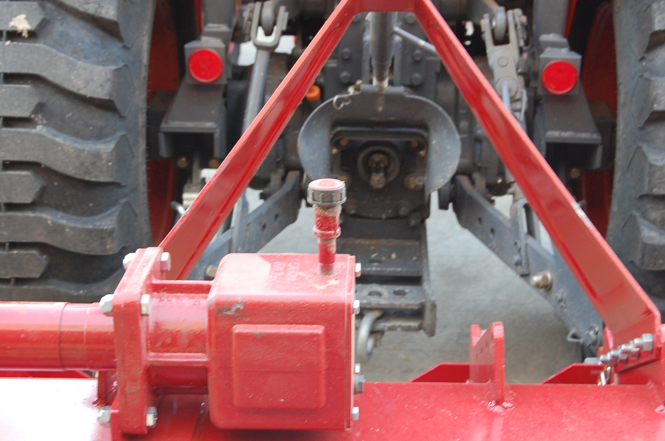

Newest addition!! Been looking at a finish and brush combo. After reading this thread made the plunge. Picked up the flail from ASC from Statesboro store on Sat. Hope to set up and try out by the weekend. Thanks for all the input.

Looks great. How much?

That's nice. I'm jealous.
Let us know how it works.

Ok by fri afternoon got everything checked out, belts, grease, fluids. Pto shaft cut to length. Set all linkages like I wanted and tried a round. Set the lower arm hookup on the flail to float by pulling two pins. Went around the field, nothing rough its been mowed with a rotary. The wife likes to walk there and wants a cleaner trail. The difference is huge almost like I done it with a finish mower. Went to some rougher areas less than 2ft that started growing up since cleared it. Again it did a great job. Less noise more agile and better results. Now I need the adapters to help with the oil all over the gear box.:thumbsup:
