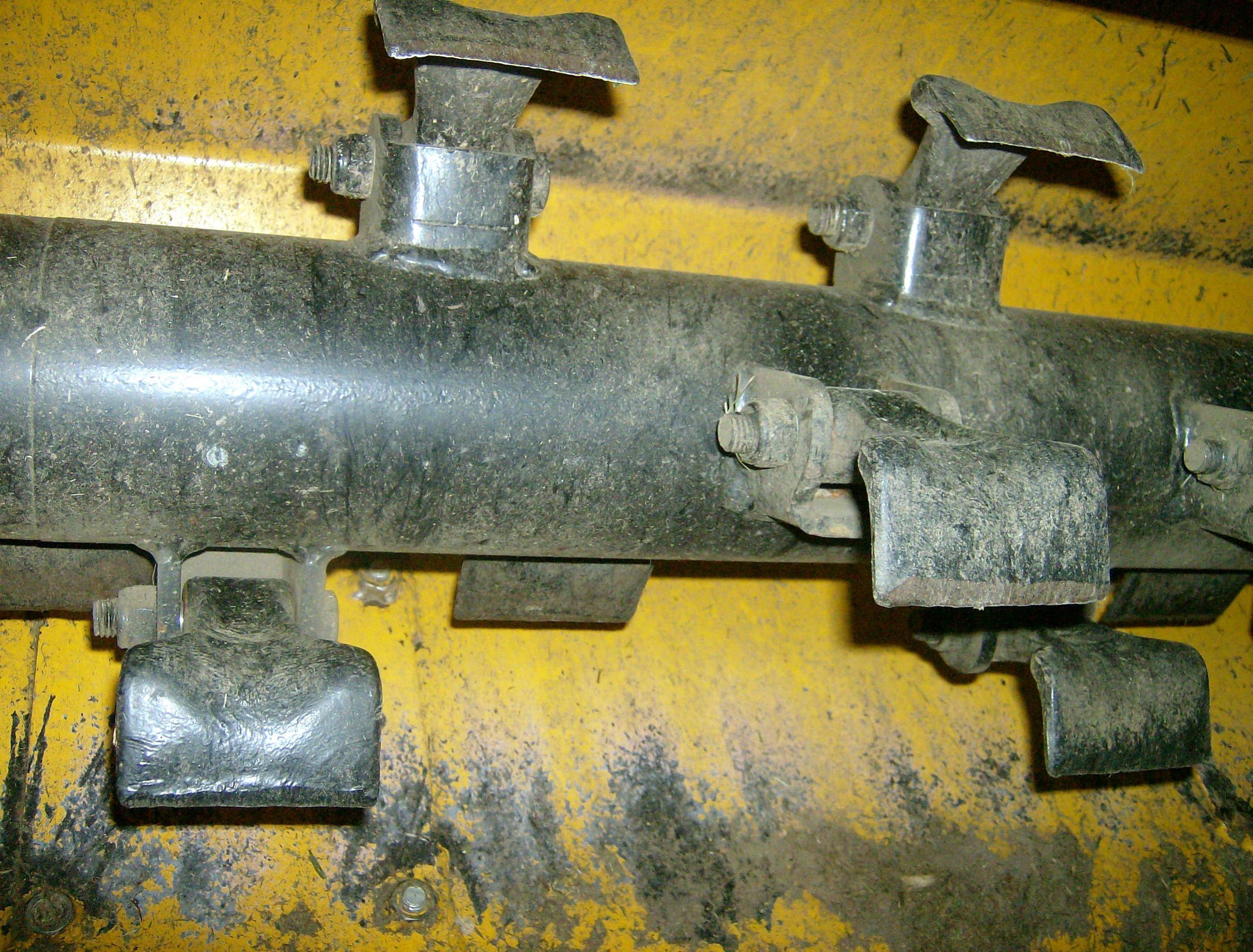

jab-law , An old heavy duty flail with cast hammers is what you need
Here's a photo of the hammers on the Bobcat Flail.

that is quite formitable looking

IronHorse, didn't you suggest using the hammer blades over the y blades for cutting grass when using a flail with only 28-30 stations?
The cut with the y blades, to me, is worse than with my hog.
/ Let's talk flail mowers #744
I believe the flail mowers are made for certain situations. For finish cut, I believe the Y type blades are mad for just that, where as, the hammer type flails have a different number stations on the drum, and the blades are wider. My flail has 88 sets of blades, and is designed for finish mowing. You can put a heavy duty blade on the finish mower to cut heaver and trash type stuff. On the hammer flails, you can not reverse them also. Some of the blades have three categories. reg, harden blades, and cast. I have also used a slicing blade on mine for lawn regeneration/dethatching. Cuts little slits in the sod. Supposed to help the root system to expand.

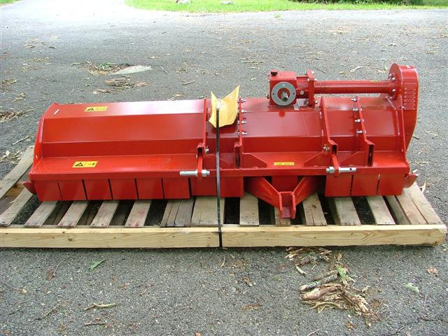

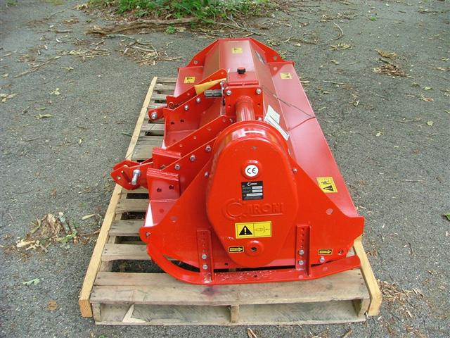

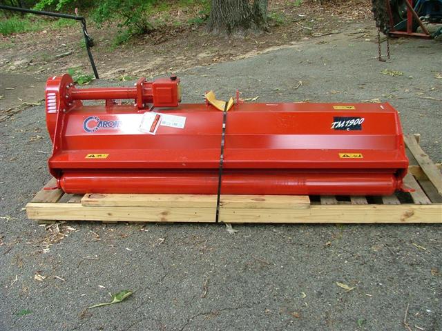

I've never seen much less used a Ford 917H but do have three seasons of experience using a Caroni TM1900 for pasture mowing and bush hogging. The Caroni has been a very good unit and if I needed another flail I'd buy another Caroni without question. The Italians make very good mowers that I think are on par with (non flail) mowers I've owned from Bush Hog and Rhino.
Parts have not been an issue. AgriSupply is the importer and they run a pretty efficient website and series of stores in the southeast. I've only had to order extra flails and a few spare shackles but that has been easy. I note on the website that you can order the whole gearbox, flail rotor and rollers.

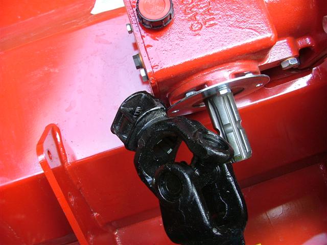

Maintenance for me has been mostly greasing it (3 zerks about every 4 hrs of mowing). After two and a half seasons I did finally burn up a set of belts (about $30-35 for a new set of 3 Gates B43). There is one other zerk behind the belt cover that gets annual greasing. I modified the gearbox oil dipstick hole by adding an extension (the Caroni's love to spit oil but it is a cosmetic issue only as best I can tell). You can either manually (would take half an hour) or hydraulically (extra kit) shift the mower further to the right by about another 18 inches or so. The mower is normally offset about that much so with the shift you can get the offset to about three feet (from memory).
Again, I cannot compare to the Ford and I don't know what type of flail the Ford is. What is important is to realize that the Caroni is what I would call a medium duty flail for pasture, lawn, agricultural use, it is not a DPW type heavy duty flail that is designed to chew up cinder blocks along side highways. It does fine "bush hogging" into brush up to about an inch or inch and a half and does a much cleaner job than my real Bush Hog on such material.

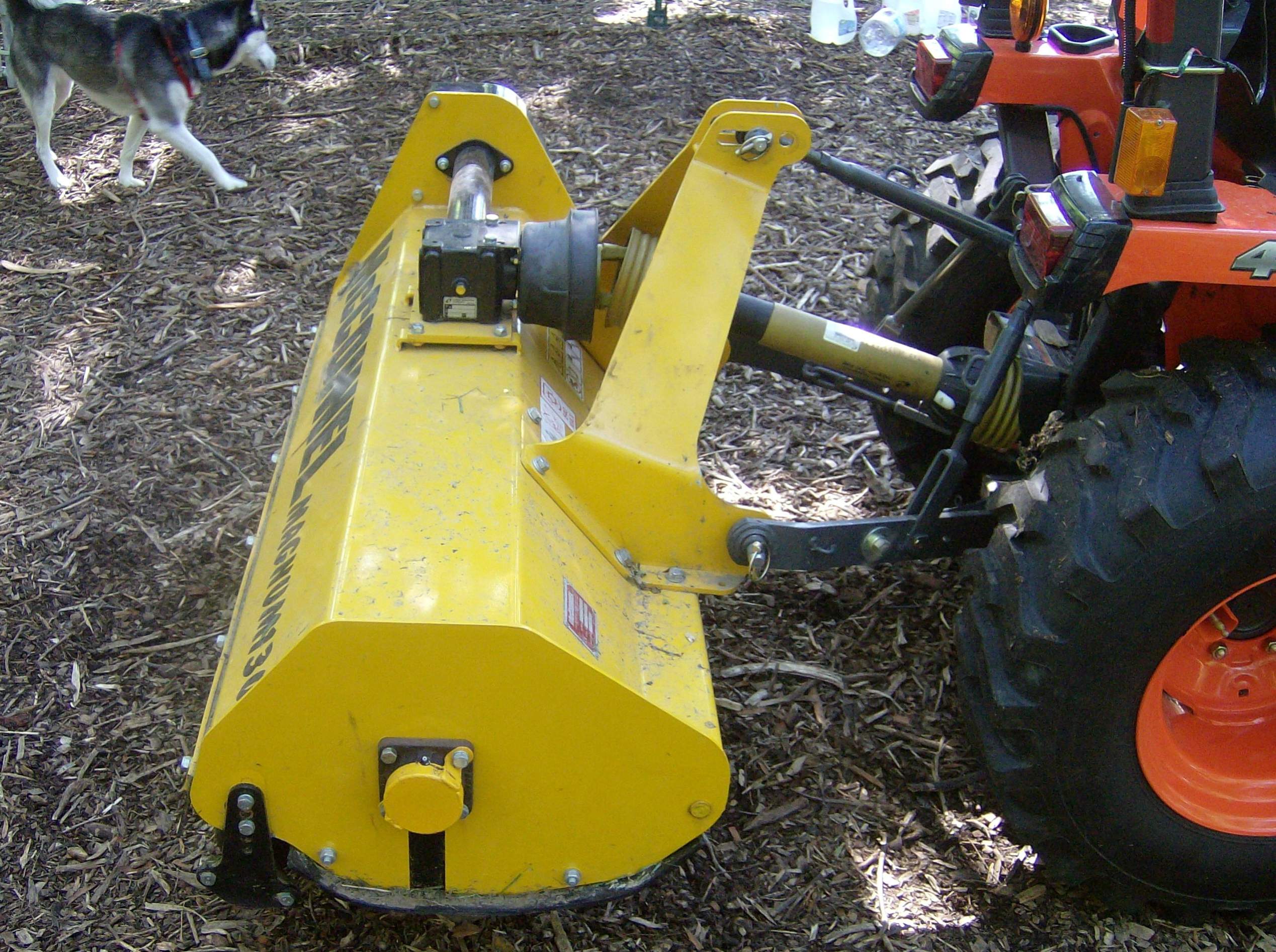

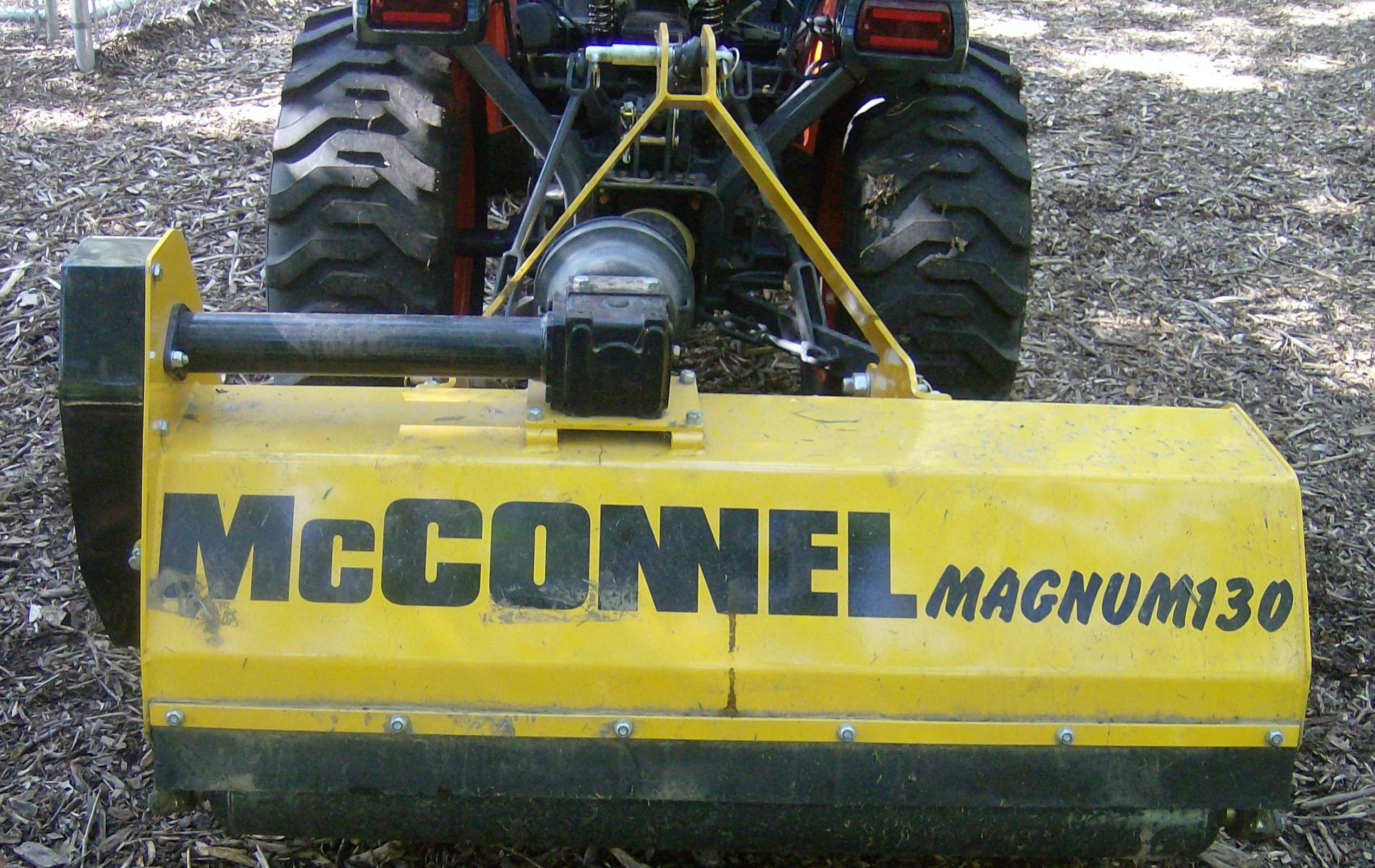

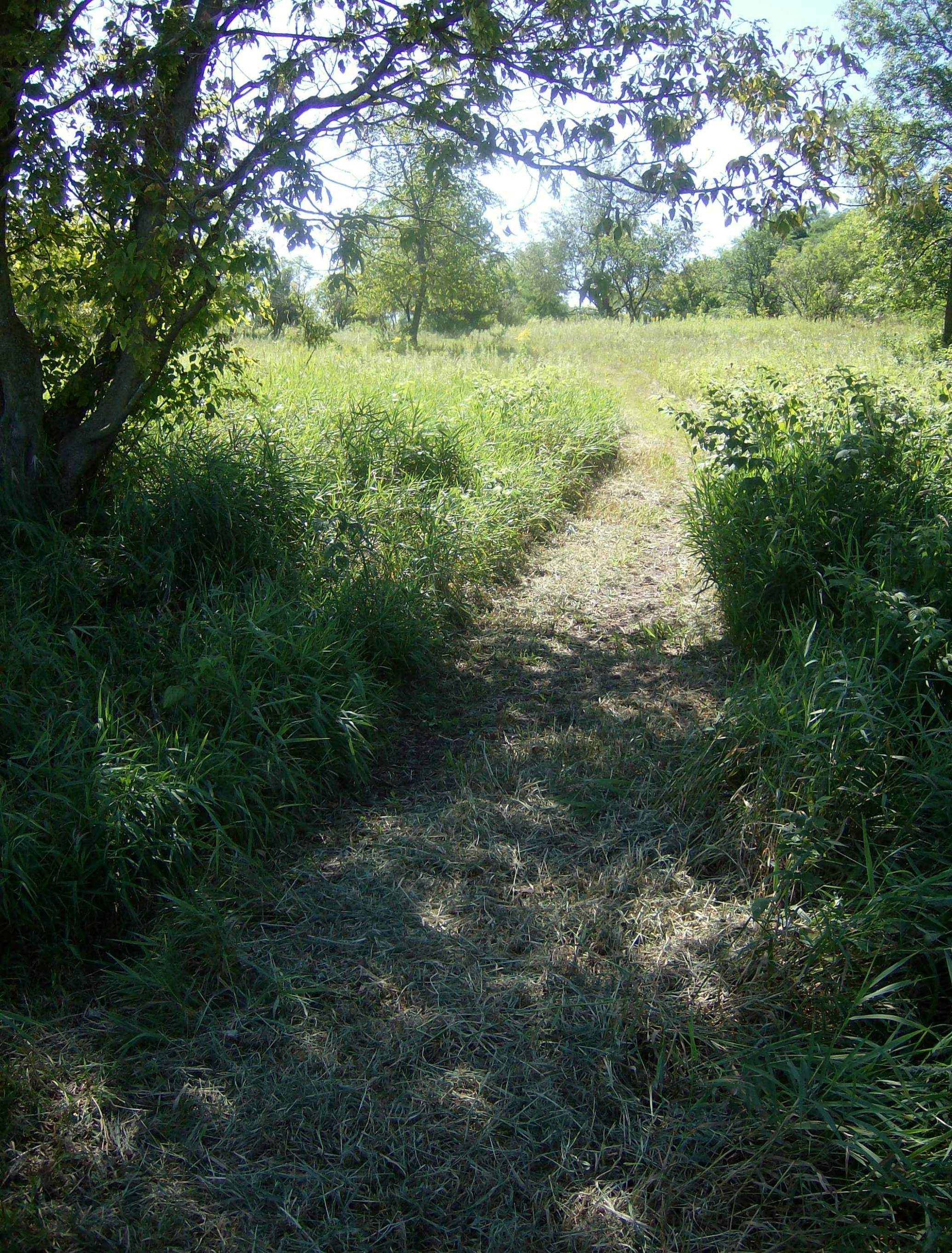

I picked up a McConnell Magnum 130 flail mower off e-bay a few weeks back. I have had the mower for about a week now and have to say, I am very pleased with it. It will really go through some heavy material, and stumps and boulders have not damaged to mower. This is a nice sized mower for my B2320, I would not want any thing wider or that sticks out the back farther.
