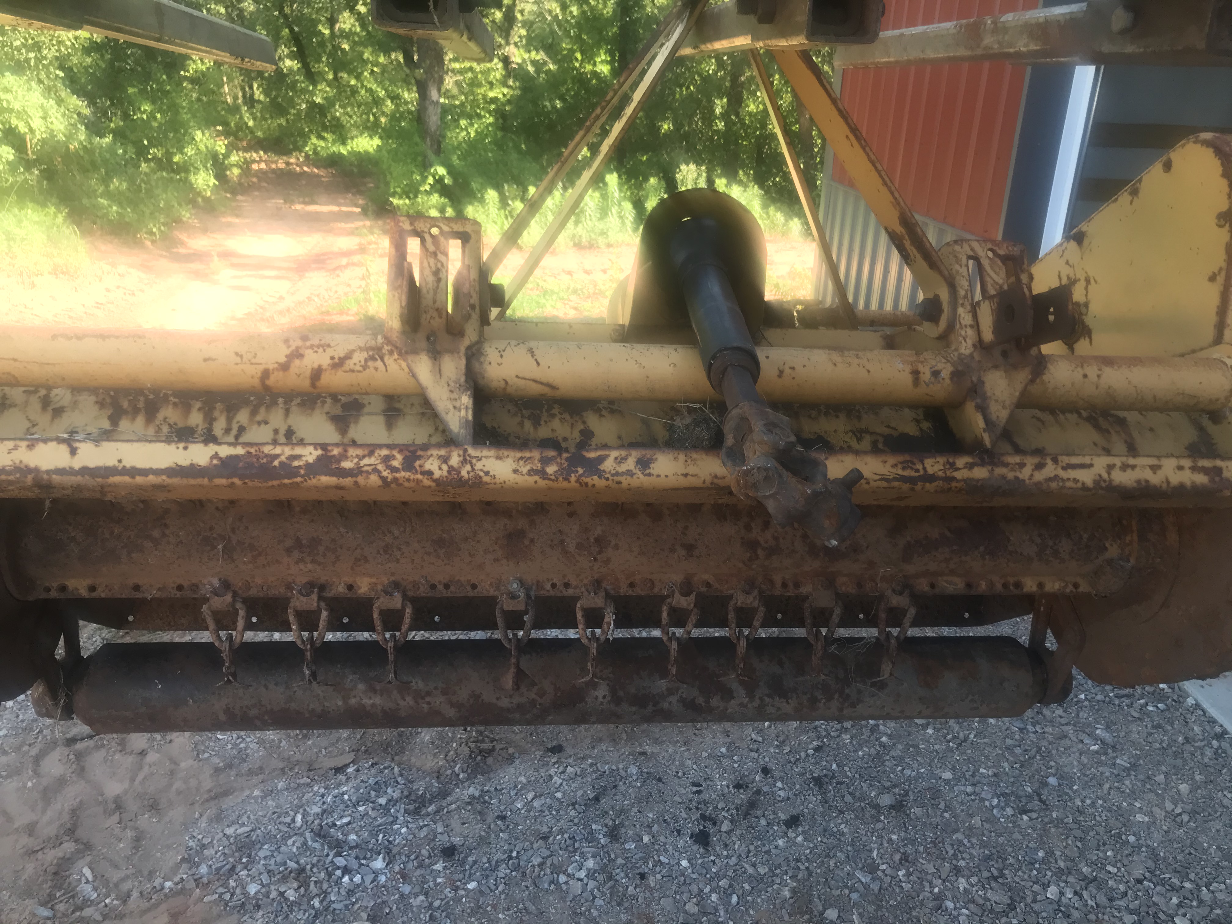

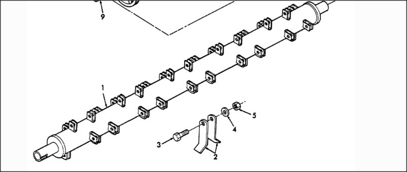

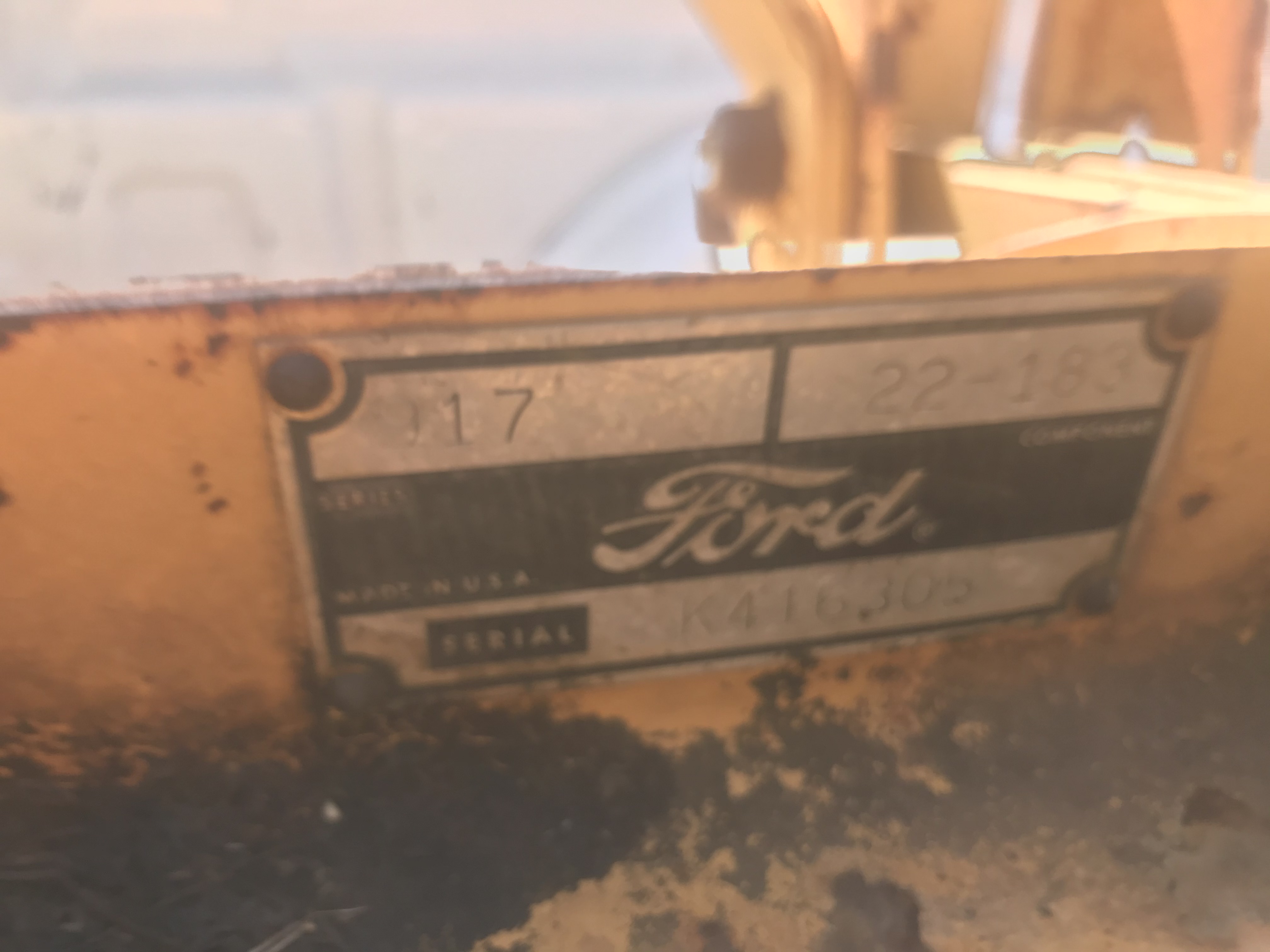

Hello all, I purchased a Ford 917 22-183 Flail yesterday, that seems to be in good shape mechanically but I can't seem to find the flail hangers anywhere to replace the missing flails.Also, when I go to replace them do I offset each blade from the previous mounting point in rotation? I have already ordered a new belt as well. Thanks for any help. View attachment 658168View attachment 658169View attachment 658170
The blades should be in ever 3rd (evenly spaced) hole. If I remember correctly they should be about 6-3/4" apart (each blade covers about 2-1/4"). You start each row 1 hole off from the last row. You can re-use the holes as long as they're not torn out. If they are, then adjust everything so you don't end up in a torn out hole. Is that a 5' mower (62")? Then you should have 9 "stations" per row for a total of 27 stations on the unit.
For hangers search for "7502617". Now that Flailmaster is gone Ford flail owners are almost out of luck for replacement parts. For blades you can use the standard Ford "airplane wings" or you can switch to the Alamo "Y" type blades for a less expensive option.
For the belt, make sure you get a banded belt. "B54/02 Banded Belt, 21/32" x 57" OC" is what you're looking for. I got mine from D&D PowerDrive (sold on Amazon) for $17.

None of the holes are torn out on my mower, I am looking for a complete set of the "Y" type slice (7501971) to replace all of the blades, as that seems to be what is recommended vs the single blades.
I believe I have 11 stations per flange which would call for 66 single slicers. 72" cut.
I did order the belt you referenced from Amazon already.

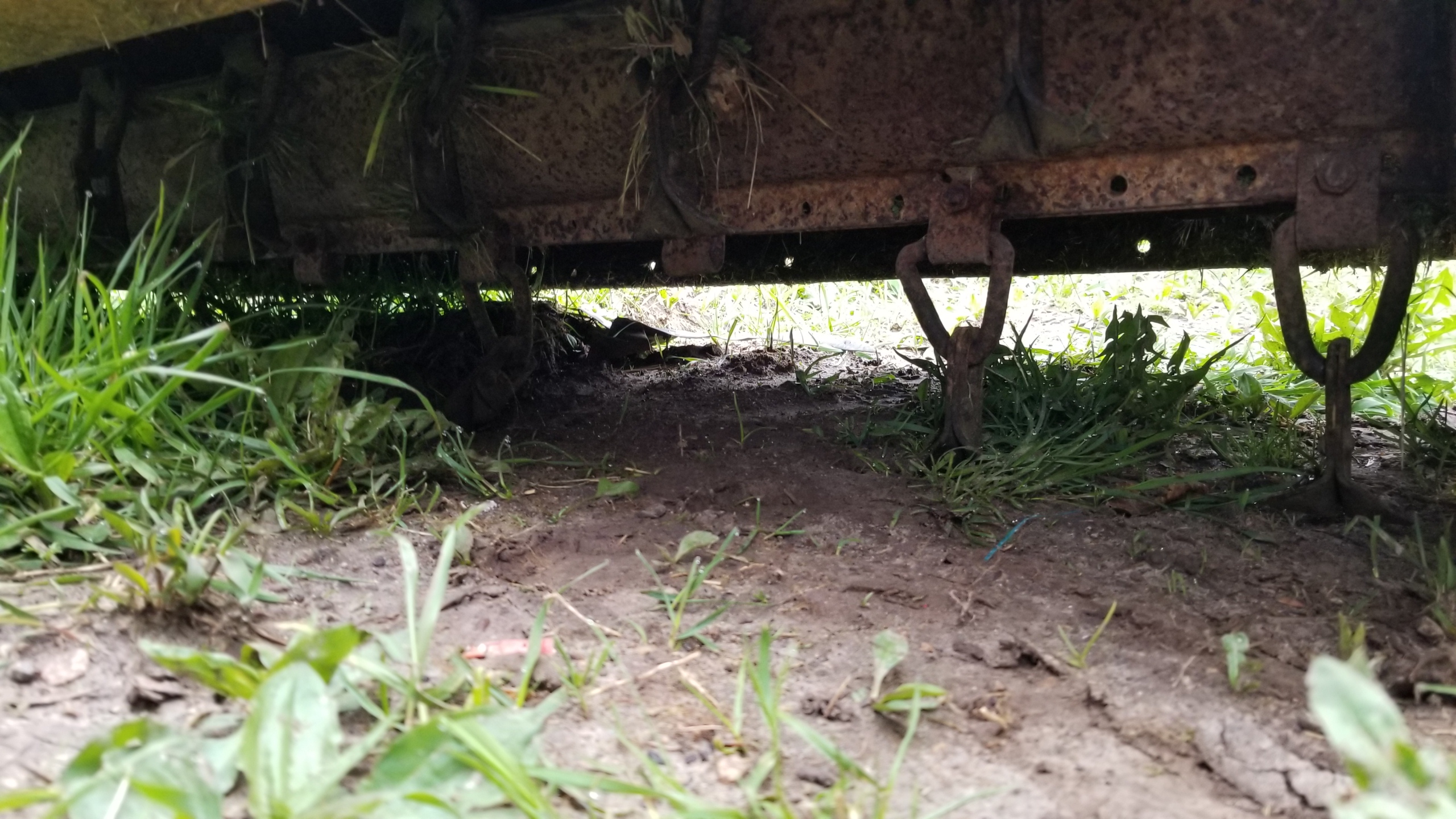

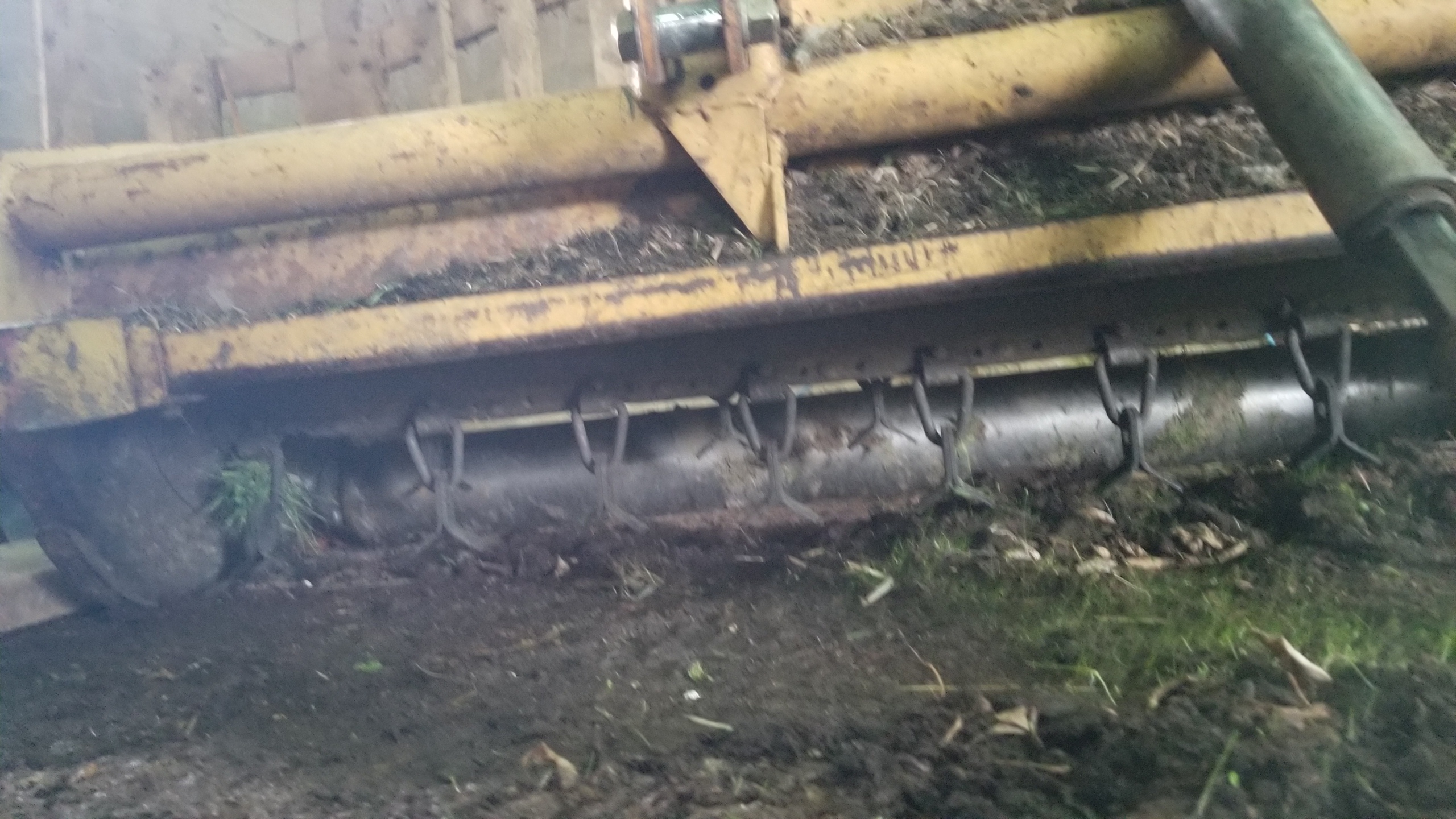

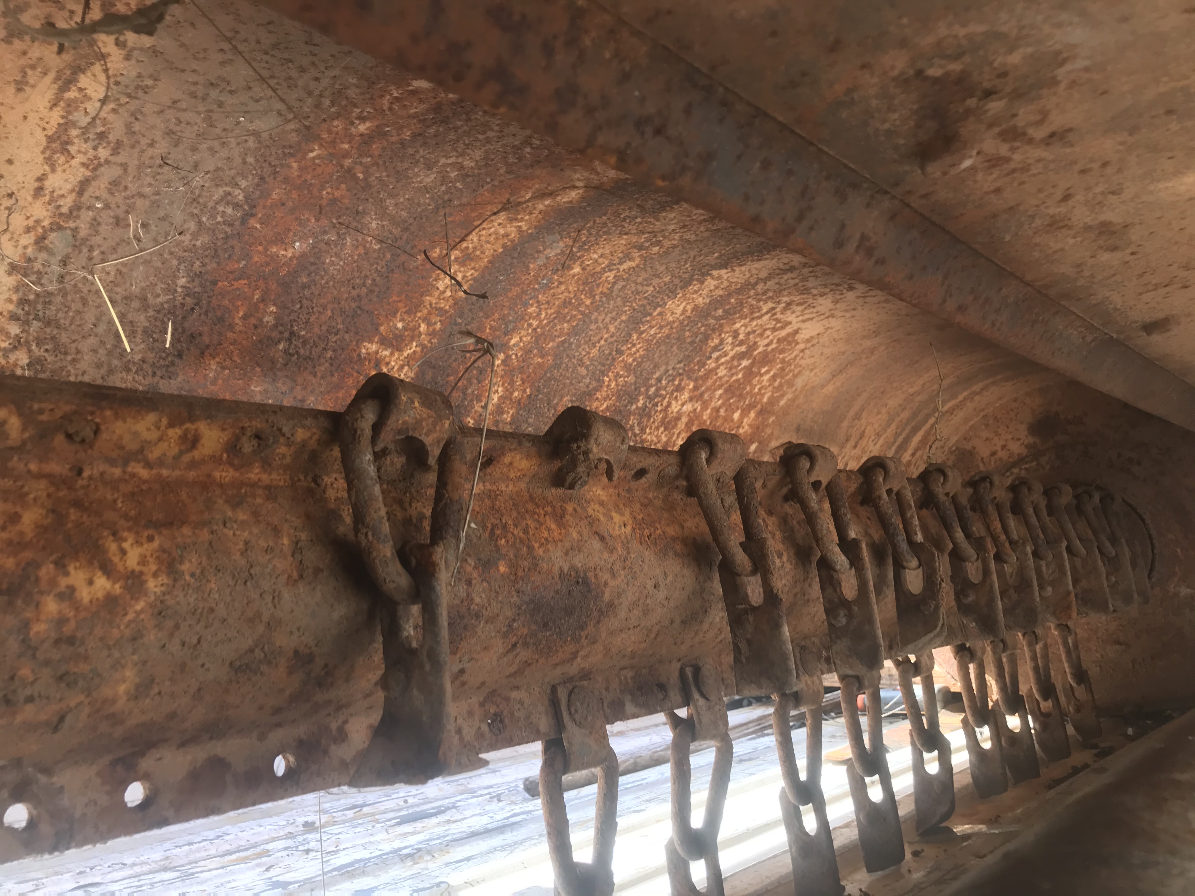

Look for M-100759 or M-105319M. Those are the Alamo blades that fit the Ford mower. M-100759 is the standard duty, M-105319M is the "extreme duty". I put the M-105319M on my Ford, but I was using the mower to reclaim CRP land. I have heavy duty ones made by Flailmaster on my Alamo. They're 0.130" thick instead of 0.106" thick like the standard blades. For reference, the extreme duty is 0.192" thick. Forged blades are available as well (M-108381), but they're more expensive. Alamo blades will be far more available because that seems to be what m highway departments use.
Your model number is the same as mine, and mine was a 62". Messicks has the number mixed up on their parts site. 22-183 says 72" but Ford never made a 72" in the 917, just 62", 74", and 88". If you look up 22-184 it comes back as 74", and 22-185 is their 88". So you should have 9 stations per flange.
A few (not real good) pictures of what my 917 looked like under the hood (before new blades and after new blades):

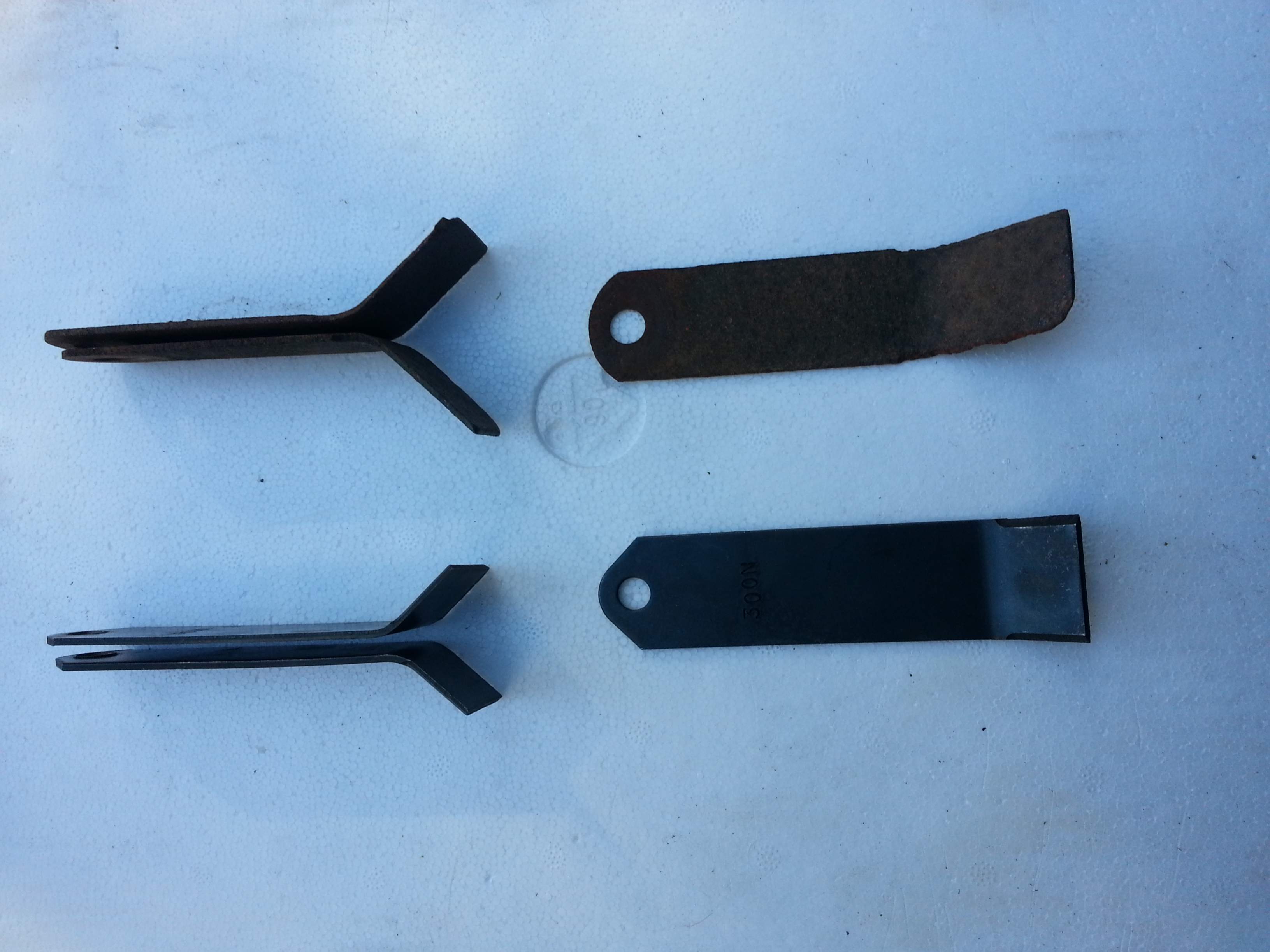

I ordered a set of replacement flails from them on June 5th for Ford 917L Special mower.
These are Alamo / Mott flails and will need slight drilling of holes from 5/16" to 3/8".
Here is someone else's photo of Mott vs. Ford flails:
I will give update once they have been installed.
