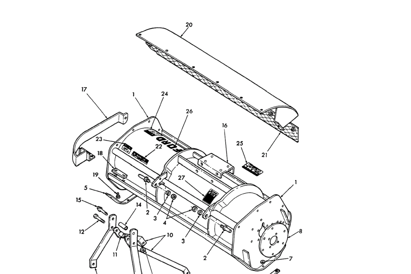

Anyone for a rousing game of "name that flail?
This one has come up for sale near me for what I consider a decent price. 48" in width, so a nice size for the little yanmar.
I think its a Ford 917 of some flavor but some parts look significantly different than what I remember from the one I had previously. The lift pin attachment also seems to be missing the float arms I remember? Could that be factor or is that a hack job somebody did?
Ended up buying this little 4 footer for $500. Little more than I intended to pay but mechanically it was in good shape aside from the lack of float arms. The blades even look good on it.
Interesting bit of info for historical reference. Based on the Messicks parts diagrams, it appears to be a 48" Ford 917A, which does NOT have float arms. Guess it doesn't need anything at all....
/ Let's talk flail mowers #6,648
I always wondered what the difference between the 917 and the 917A was. Now we know it's the float arms. Honestly I disliked the float arms on my 917. My Alamo doesn't have float arms and I don't really see them as necessary unless you're mowing very uneven ground.
