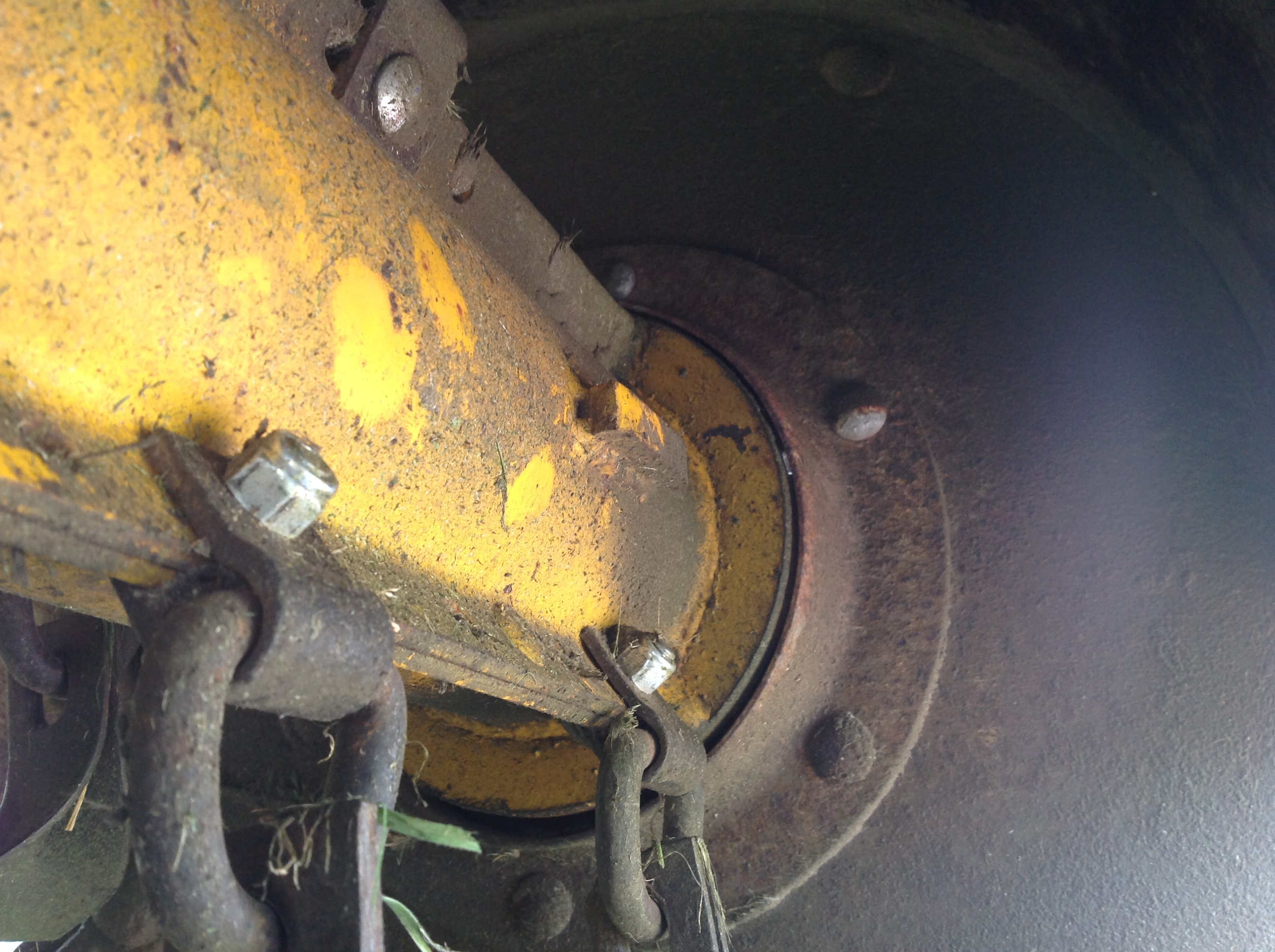

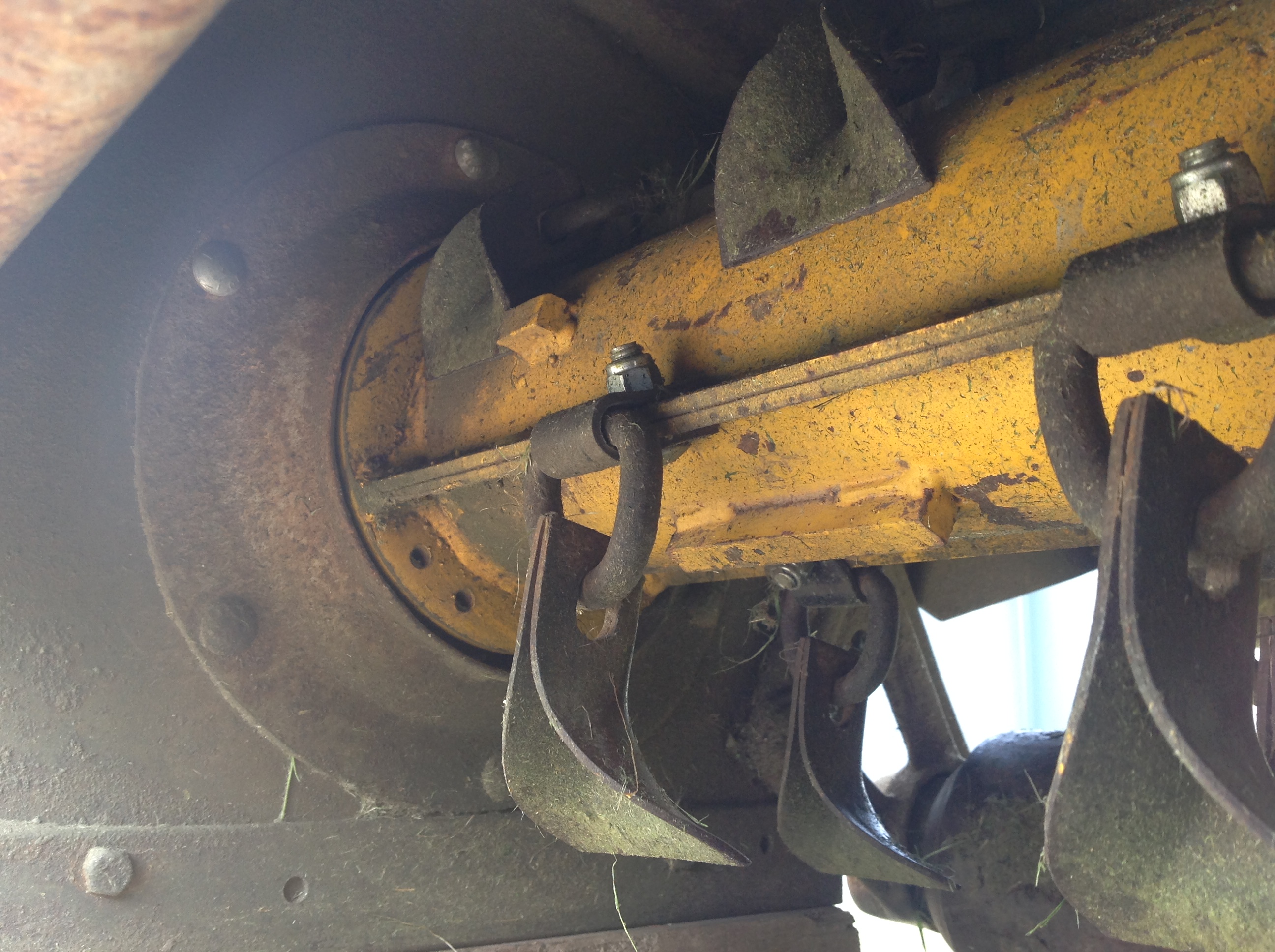

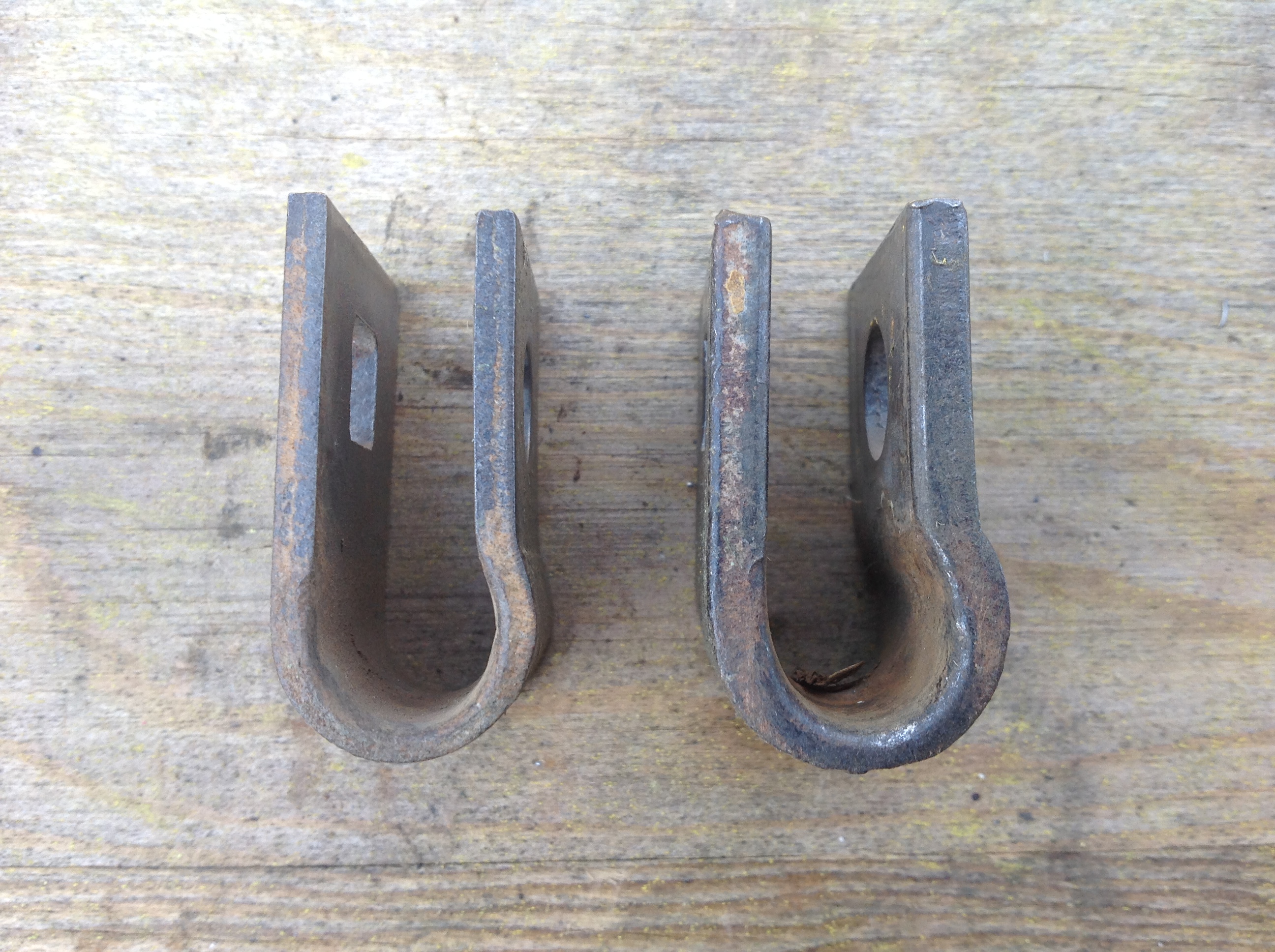

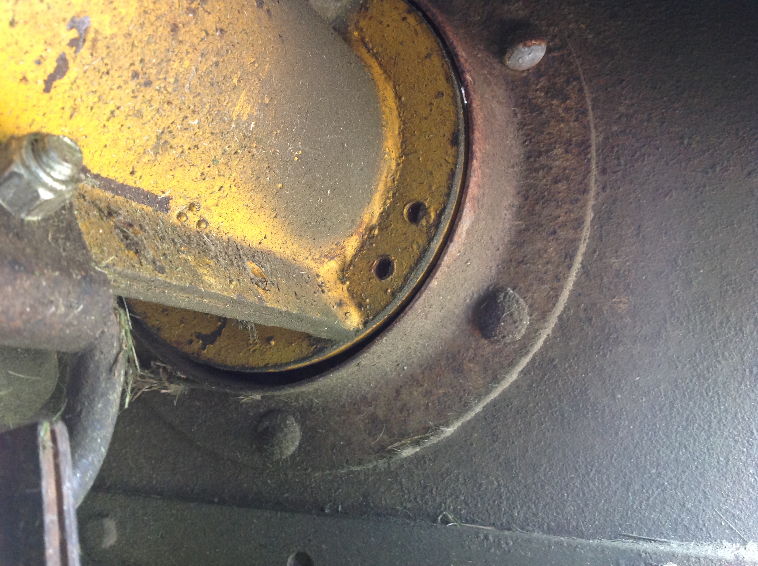

One problem is that they used different thickness hangers that are going to be different weights, I see two welded weights on the left and only a small one on the right but no indication of one missing. I really don't understand why the hanger bracket bolt holes don't line up and you have to pound the bolt through the hole to make it fit, about 20 of the hanger brackets lined up perfect and the remainder did not. The two threaded holes in the second to last photo is where the adjustable weights go. The only problem with working on old machinery like this is that you could spend the money buying new cutters and hardware and then find out that the rotor is not balanced or bent.
View attachment 500818View attachment 500819View attachment 500820View attachment 500821View attachment 500822
A couple of things:
All of the knife hangers should be identical in thickness and weight and length.
If they are different they broke a few of them and they replaced them with home made steel strap iron and created the scoop knife hanger.
Flail mowers never ever have adjustable weights "EVER" they are welded in place where they are needed.
It also appears that all of your original weights are still intact and in position on the flail mower rotor.
That "weight" should not be there. There should be a knife hanger and scoop knife there.
It would explain a lot of the vibration affecting the flail mower rotor along with the different weight knife hangers.
The scoop knives are set to over lap when mowing. A missing scoop knife with the scoop knife hanger will always always always affect a flail mower rotor and it will immediately become unbalanced.

Rule of thumb is 5hp per foot, but my 7' 917 ran fine behind my 25hp PTO L3200, so 3.5hp per foot. If you can lift it, you can spin it. From ther its just a matter of being able to go slow enough. It was easy with my HST & I went a lot slower than with my 5' rotary, but covered the same or more ground per hour. A lot depends on what you are mowing to a large degree.
The adjustment for roller height on my 917 was welded up years before I got it. Leaving my hydraulic toplink in float & lifting the 3pt I could get to 4" maybe a bit higher. I couldnt get to much higher than that. Cut quality did suffer a bit up higher, but as I was feld mowing, not law mowing I didn't care. You'd get bad results going any higher & flails wont work well unless they are on their roller. I tried it, mostly hanging it over a ditch & it cuts a bit, but nothing you want, except in special circumstances like hanging it over a ditch or obstacle.
YYa, the side slicers give a good cut & mulching, but fare less well against heavier stuff. Duck foot hammers do better in heavy stuff. Your side slicers bolt directly to your rotor & are really long. My side attach to a D-ring & bracket. More possible movement on my setup, but i'm not sure what advantages one design has over the other. There were a pile of 917 variations as well as the predecesor 907 I believe. I assume Special was just another model in the lineup with some tweak or size difference from the rest.
Make sure the rotor is straight & the bearings are good & it should last you a long time if you lube it properly.
Edit: Just looked at your photos again & 1 really bent knife stands out. think its partner is bent too. Check all your knives then talk to Flailmaster & get some replacement knives before you run it. Ive mangled a few knives on my well head & other stuff, so it's not that big of a deal at all. Just replace em & move on.

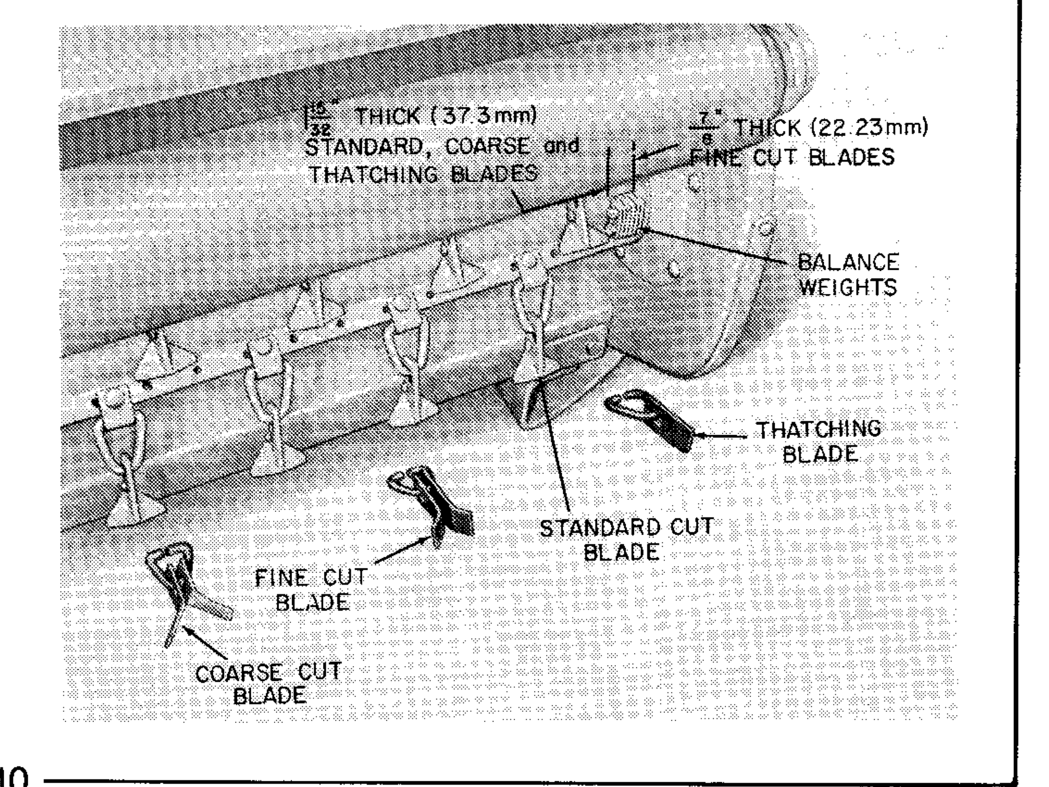

I'm confused:confused3: why does the operators manual say different.
/ Let's talk flail mowers #4,228
Unless the owners manual states differently, those "balance weights" are likely welded in place even though the drawing seems to show them bolted. Perhaps the factory set up is to use the same rotor for both fine cut and coarse cut setups but to weld different weights in place for each. I cannot imagine why a rotor would be built so that "field" rebalancing could be done. Balancing requires high speed revolution with precision testing equipment and is done, as far as I know, only in the factory or in specialized workshops.
/ Let's talk flail mowers #4,229

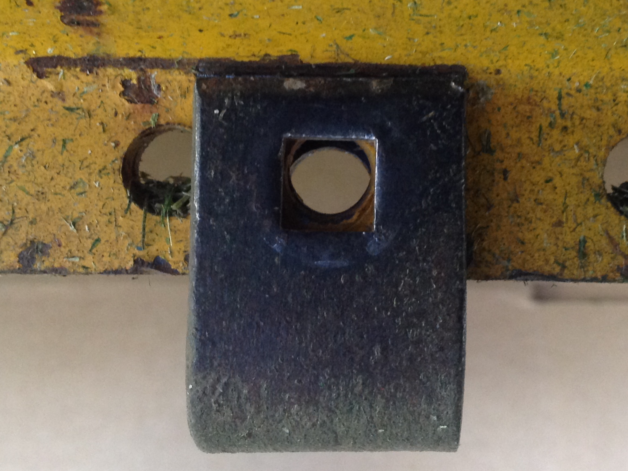

The picture I posted might be misleading because it does not show the other end of the rotor, both ends of the rotor have two drilled and taped holes for bolted on weights along with welded on weights, and the manual is saying to adjust the weights if your using fine cut or ruff cut blades. With fine cut blades your mounting more blades and they want you to reduce the weights, with coarse cut blades there is not as many and they want you to increase the weight. The bolted on weight even have their own part numbers, interesting, I have a couple calls out to manufacturers awaiting call backs.
/ Let's talk flail mowers #4,230
Yes the manual you posted does say to add/remove weights based on the type of knives or blades used. Since the spacing is different for each type of knife, are off center and then use more weights on that 'empty' end? Did you verify the style you are using are in the correct holes? Did you have all knives off and then reassemble the in different locations? Other than getting the weights added as the manual shows, I'd bet your best chance to reduce the vibration will be a new set of hangers.
/ Let's talk flail mowers #4,231
Since the manual calls for weights at those locations, the first step would be to acquire those weights, not change out all the knives and hangers that look fine..
/ Let's talk flail mowers #4,232
Yeah I agree the weights are the first thing to add, as long as the blade placement is correct so you know how many to add where. Since the hangers are different styles and weights, I think they would be next. I removed 'changing blades' from my post above since they do look like they're in good shape yet.

I sure can't imagine "field balancing" a drum, with or without the knives. All the weights on mine are welded in place to balance the drum. It's a 72" drum. As long as all the knives are in place, this works really good. I can tell right away if I sling/knock off a knife but can still cut without much vibration. Loosing 3-4 will shut me down depending where they were lost on the drum. I keep about 10 sets of knives and D-loops in stock. I have the cup-knives so the cut is like a finish mower but can cut about 2-3 times faster than my mower. Takes a lot of work off the ZTR down front and along the 1/4 mile driveway. I also mow the state and county road side of my fences with it. That's a good mile but 3-4 passes and I'm done. It would look like a jungle if I waited for the county to cut it.
/ Let's talk flail mowers #4,234
I do agree with what your saying, that makes sense. All the blades are in the correct stations, but as you can see from the photo the blades are not any of the four styles the manual calls for. I will start with ordering the weights and see if that corrects the vibration, if that doesn't work I will replace all the hardware because I don't want to go through all the work of replacing the hangers and find out it's the style of blade or the link. I am still stumped as to why the hanger bolt holes don't line up, I even went to New Holland and bought two hangers and those holes did not line up either. Thanks Dan in MN & Ford850 and everyone else who have helped.:thumbsup:
/ Let's talk flail mowers #4,235
This is how I'm seeing it, your not balancing the rotor per say, your just keeping the rotor ballanced with the removable weights, your just increasing or decreasing weight in equal increments on both ends if you change from one style of blade to the next, because fine cut blades take up more stations and the manufacturer knows that reducing the weights will keep the drum balanced, and vice versa.
