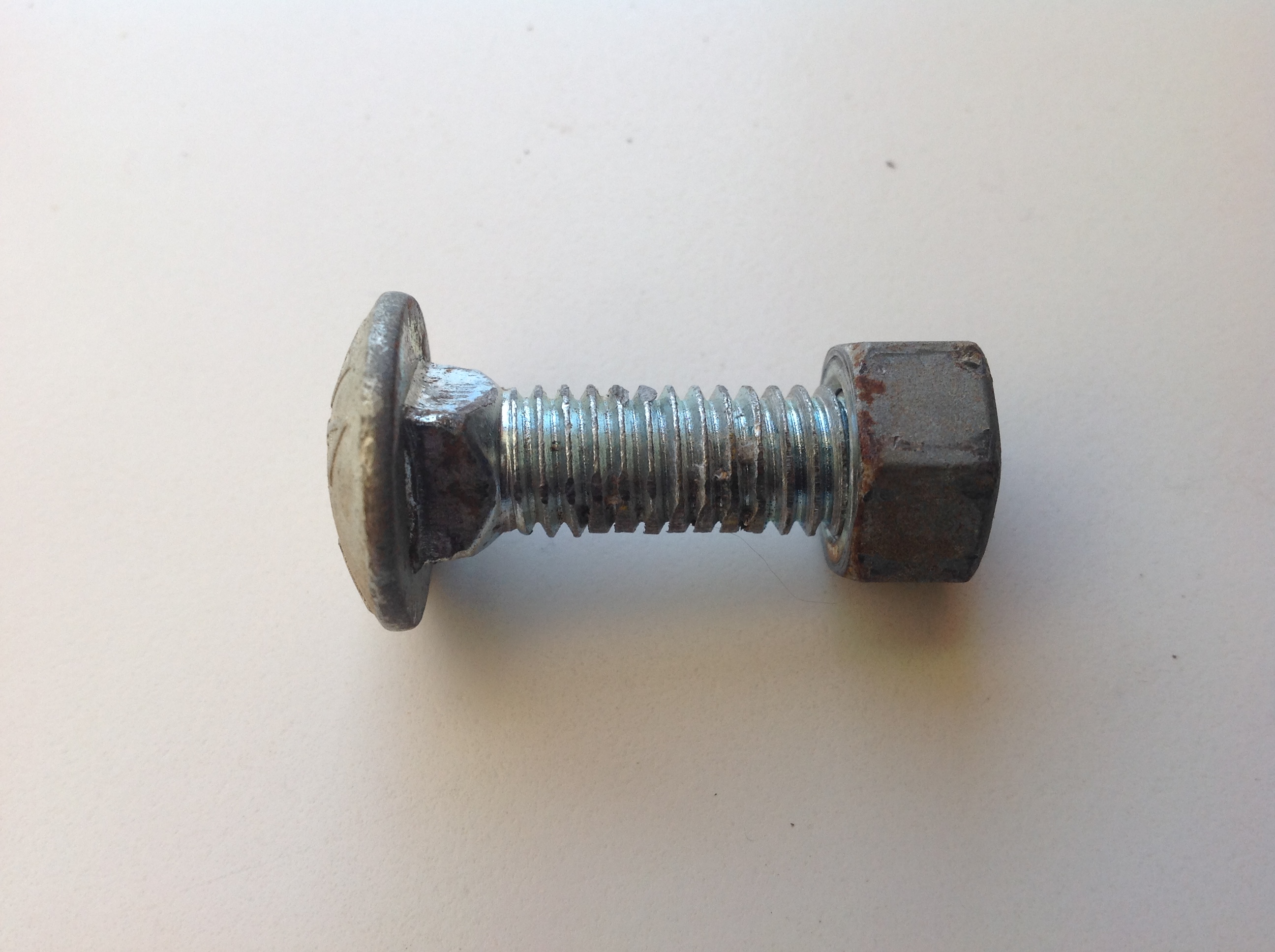

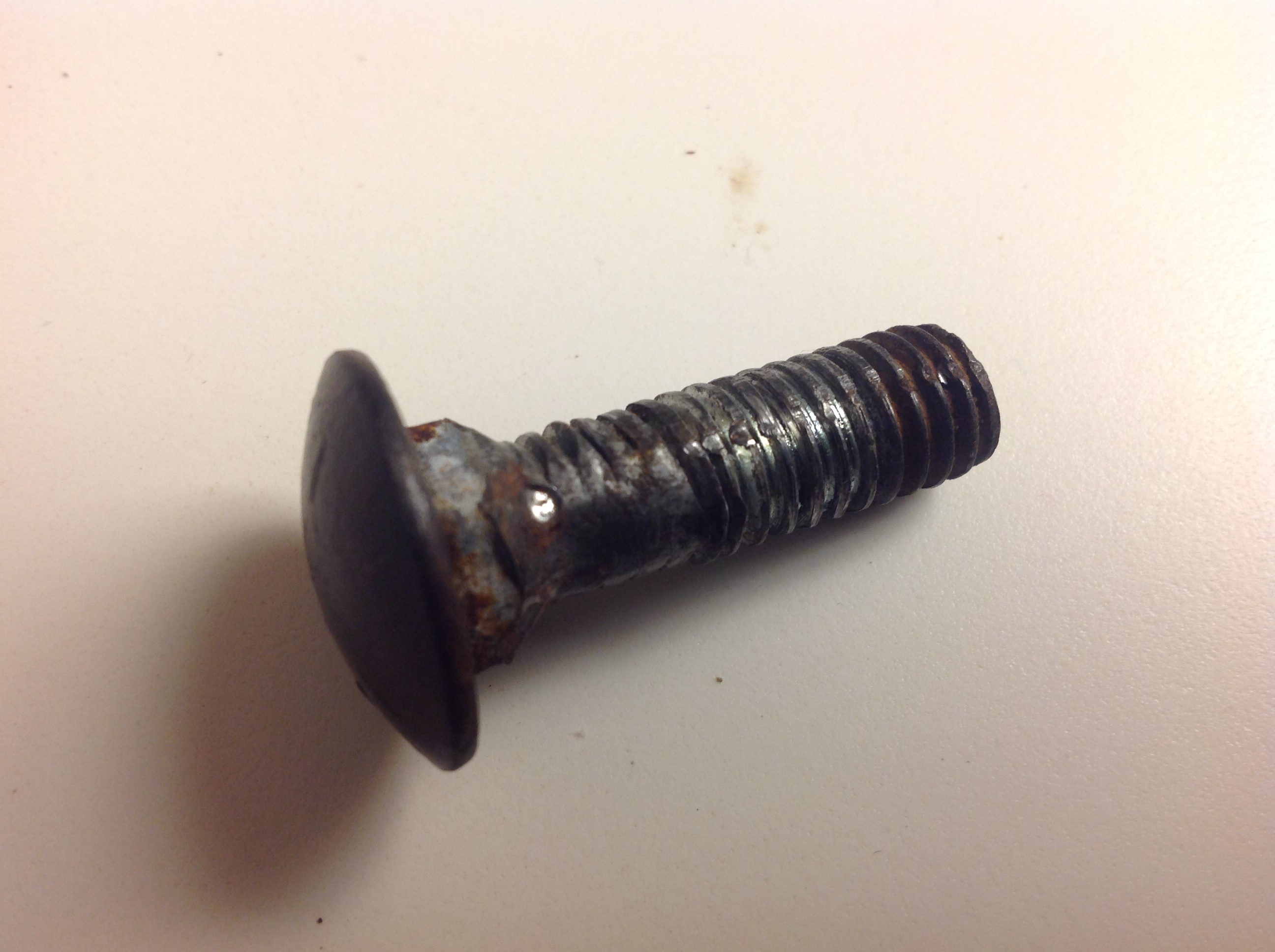

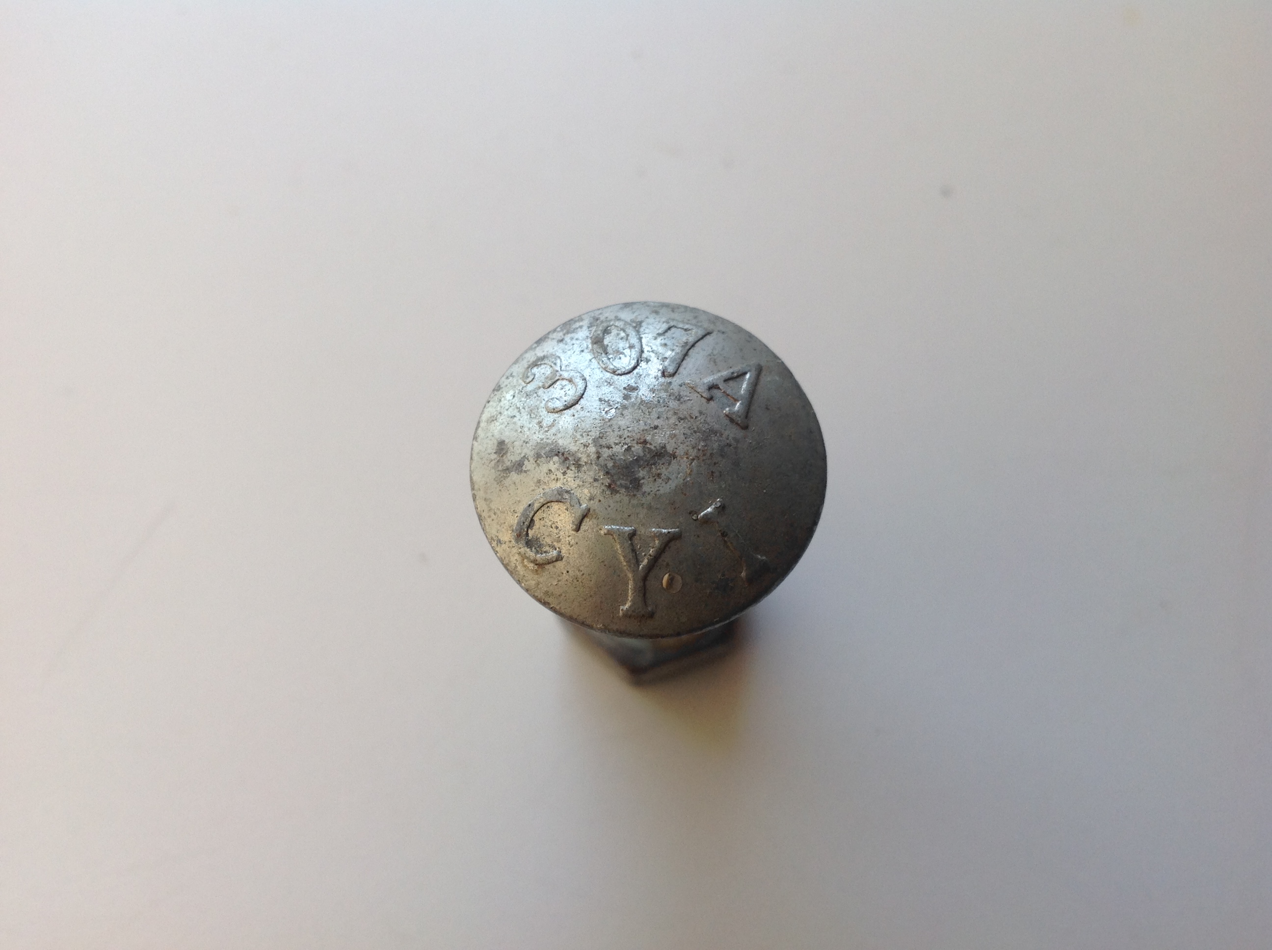

Thanks for everyone's help and ideas. Most of the bolts are pretty bad except for the one in the pictures. Is this just a standard carriage bolt that holds the blades on or does it need to be something special, grade 5 or anything like that. There where no lock washers just a bolt and a nut.

I'd spring for new bolts and nylock nuts. Certainly not grade 8. I don't recall if mine are grade 5 or lower. Never had significant wear on the hanger bolts. Do be careful to get just the right length though. Any threads not protected by the nut will be trashed and
make removal a *****.

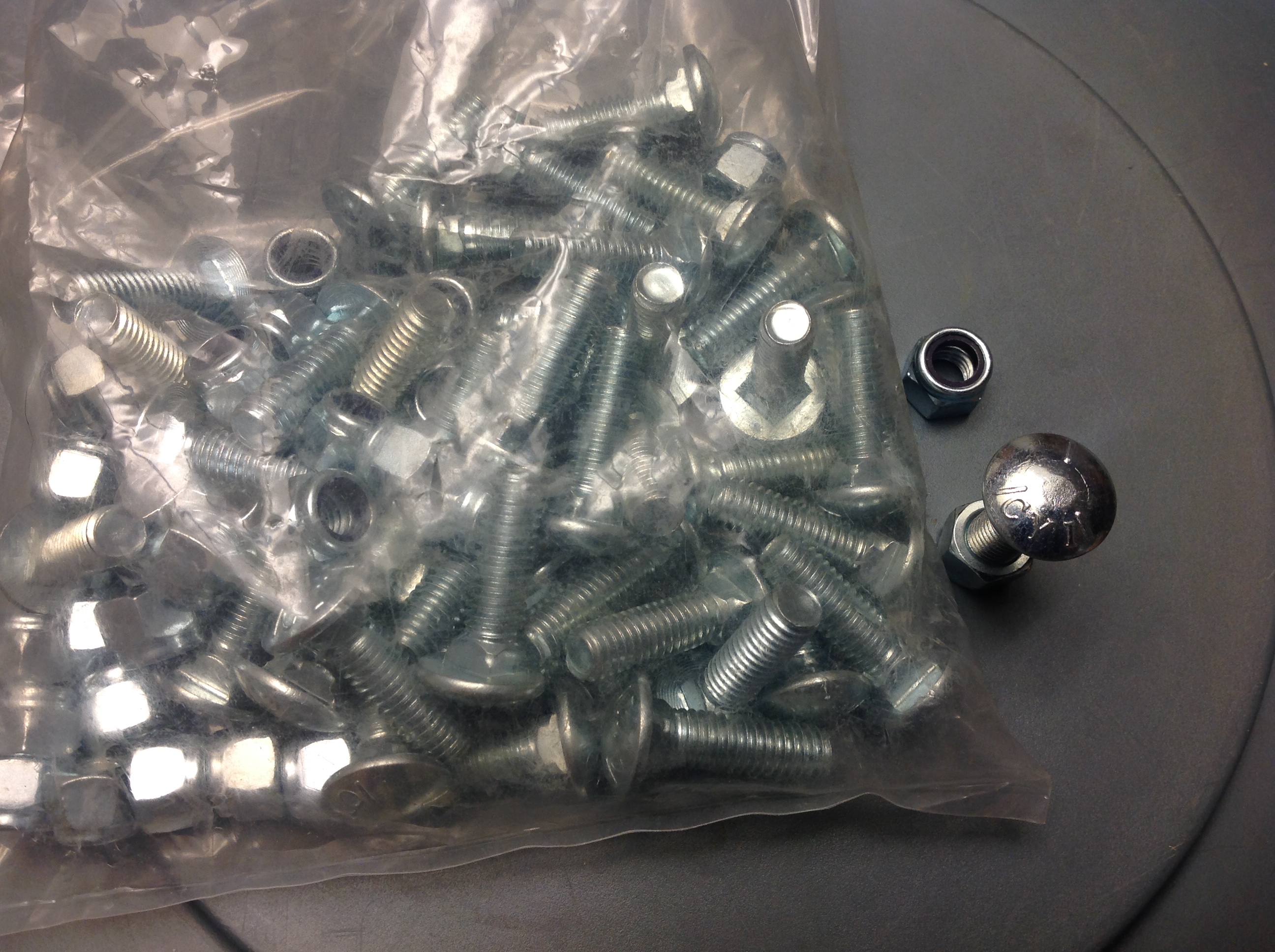

I stoped by the NewHolland dealer and the bolts are 1-1/4"x3/8" grade 5 with nylon lock nuts, the bolt I took a picture of earlier was only grade 2 and was not the correct bolt. So tomorrow I will change the direction of the blades and see if I can cut some grass.
I see the other bolts do show the threads sticking past the nut and your correct, they are all messed up and don't come off that easy.

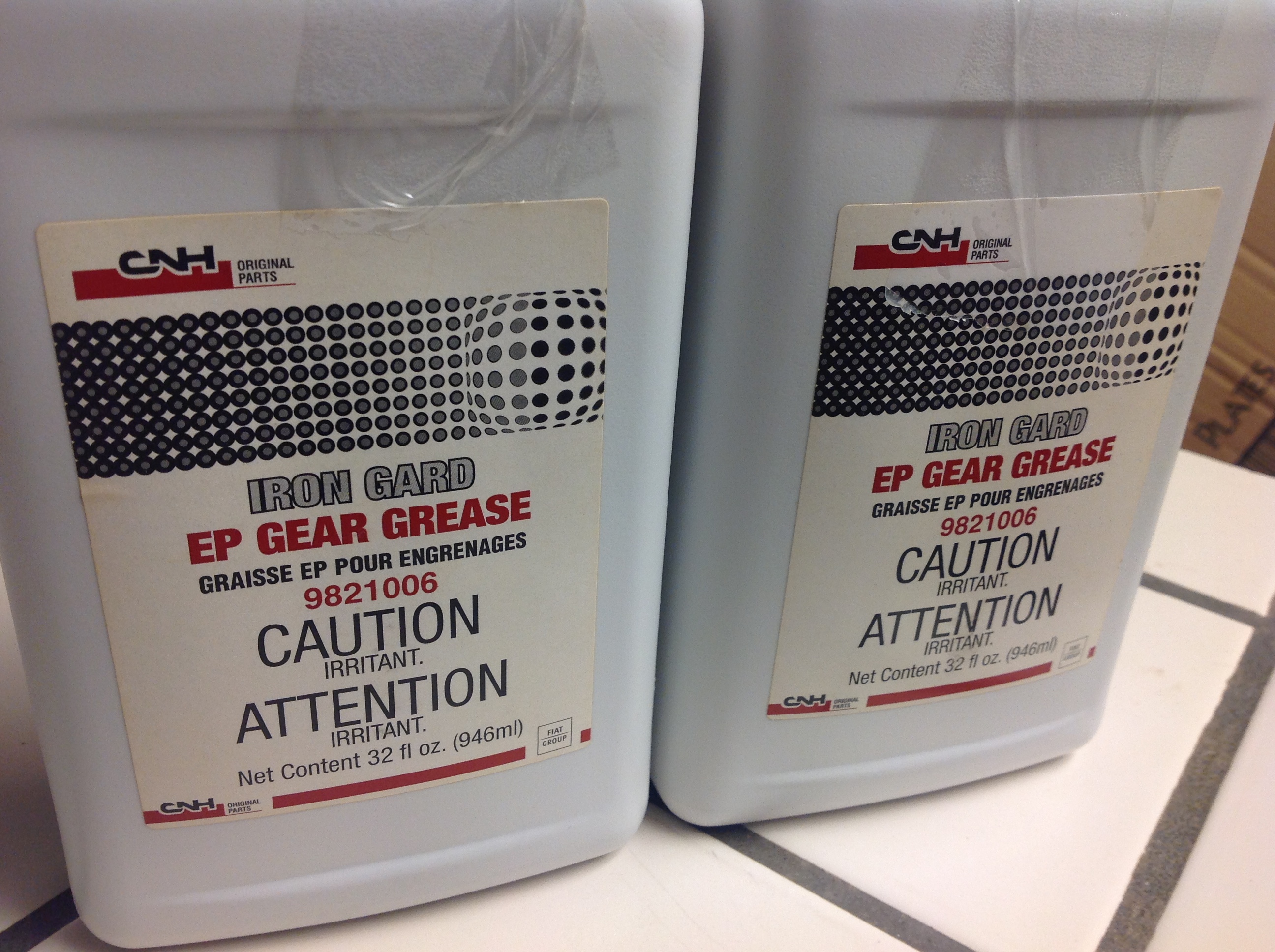

I changed the gear oil and it started leaking at the seal, so the previous owner must of had some thick gear oil in there. The NewHolland dealer sold me two quarts of this and said this stuff won't leak.

I did some similar pourable grease in mine with some 90wt mixed in. Filled about half full, about as full as you would for oil, although its a bit hard to tell with thick grease. Worked fine for a season so far. As old & beatup as the mower is i expect the gearbox to outlast the rest of the mower

I assume most of the gearboxes call for Hypoid EP gear oil, 80w-90 to 75w-140, GL-5, available most anywhere. My motorcycle uses this oil in the transmission and final drive. I ad a bit of molybdenum disulfide to the gear oil to reduce heat of friction and provide wear reduction.

There is nothing specific to flail gearboxes in regard to leaking or use of grease rather than oil for gearbox lubricant. In fact I'm pretty sure that almost all this information comes from decades of experience with leaking bush hog gearboxes. Not a big deal to use grease. Any lubricant will do. These gearboxes are not fine machinery.
