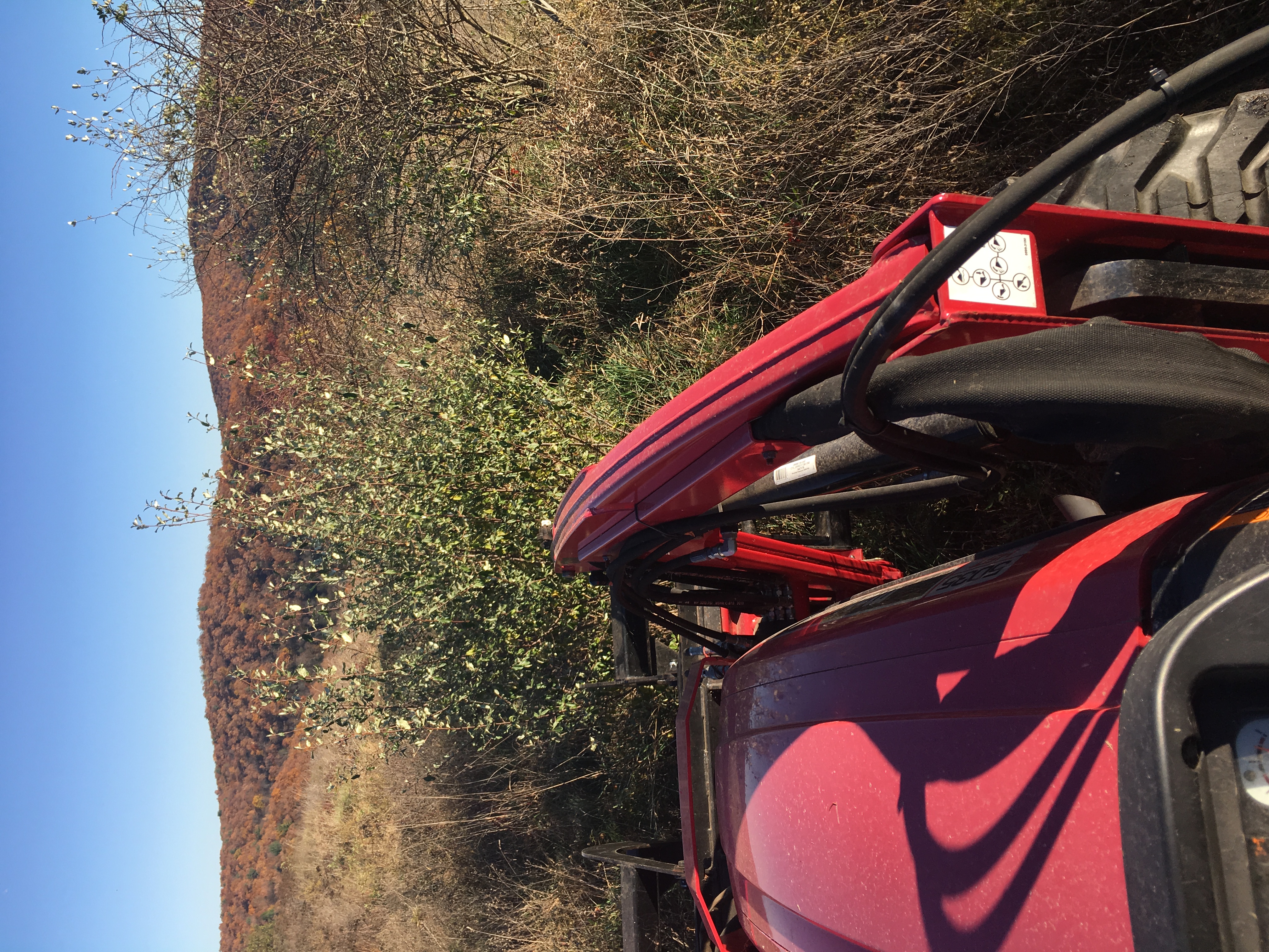

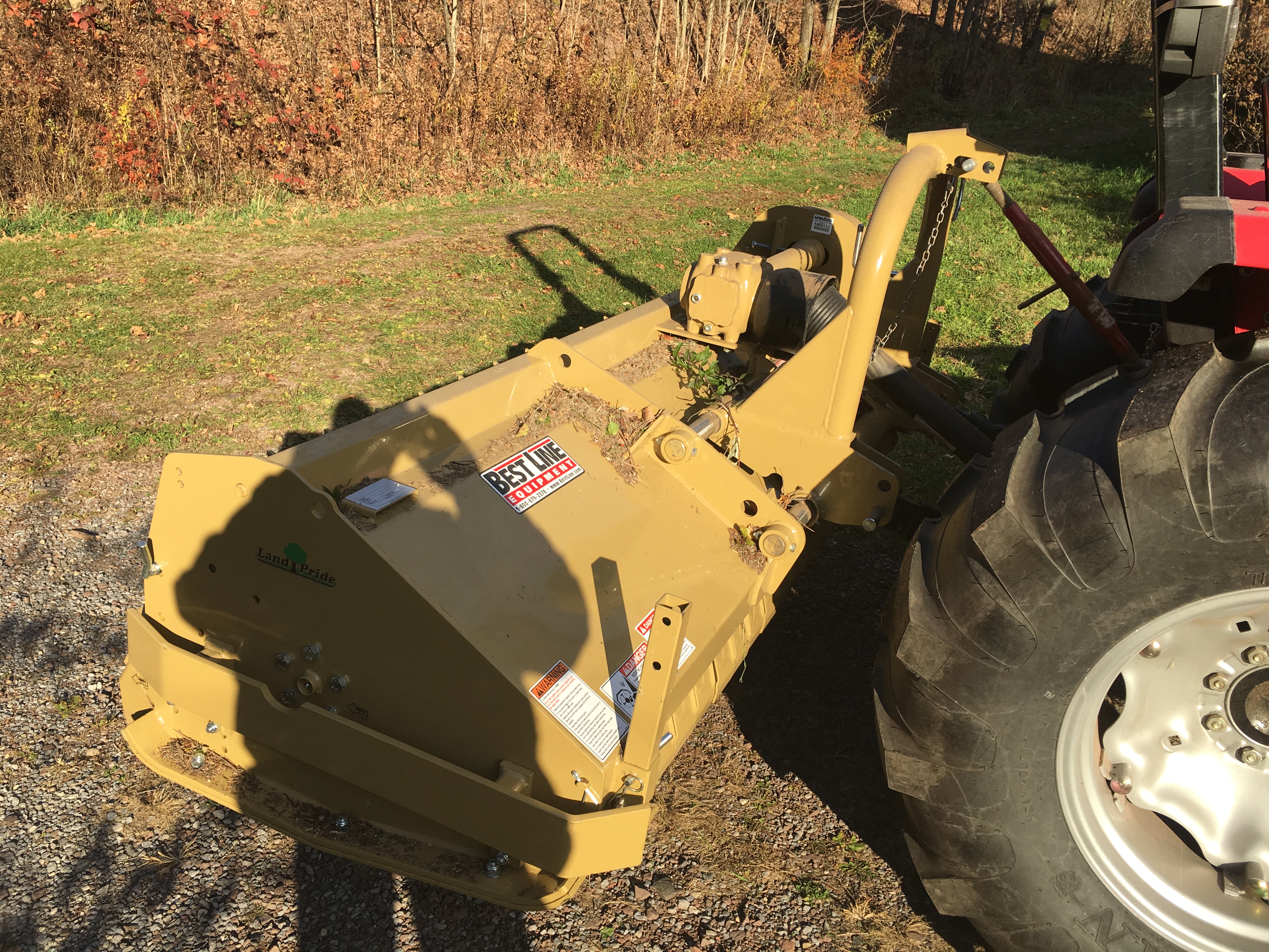

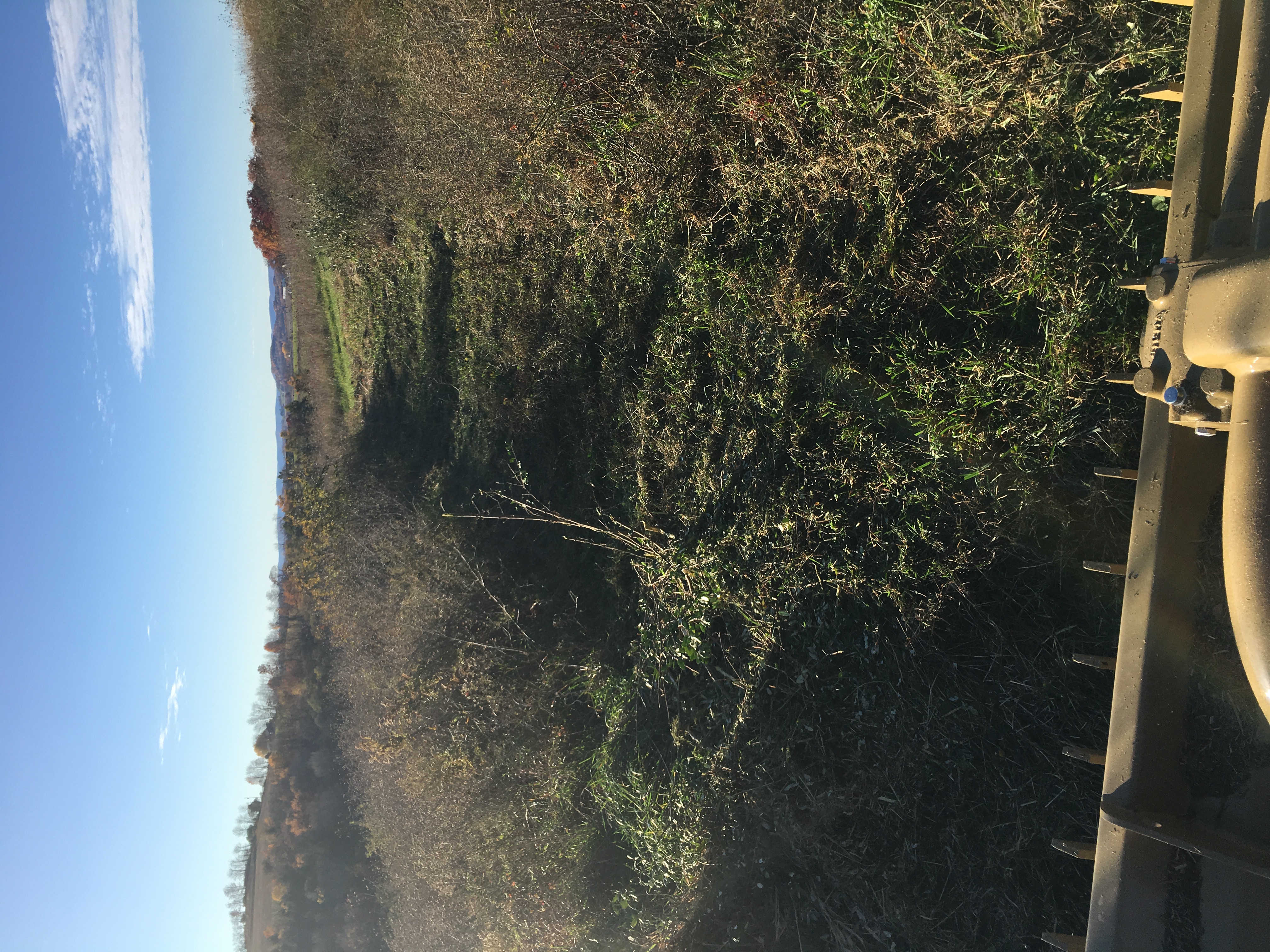

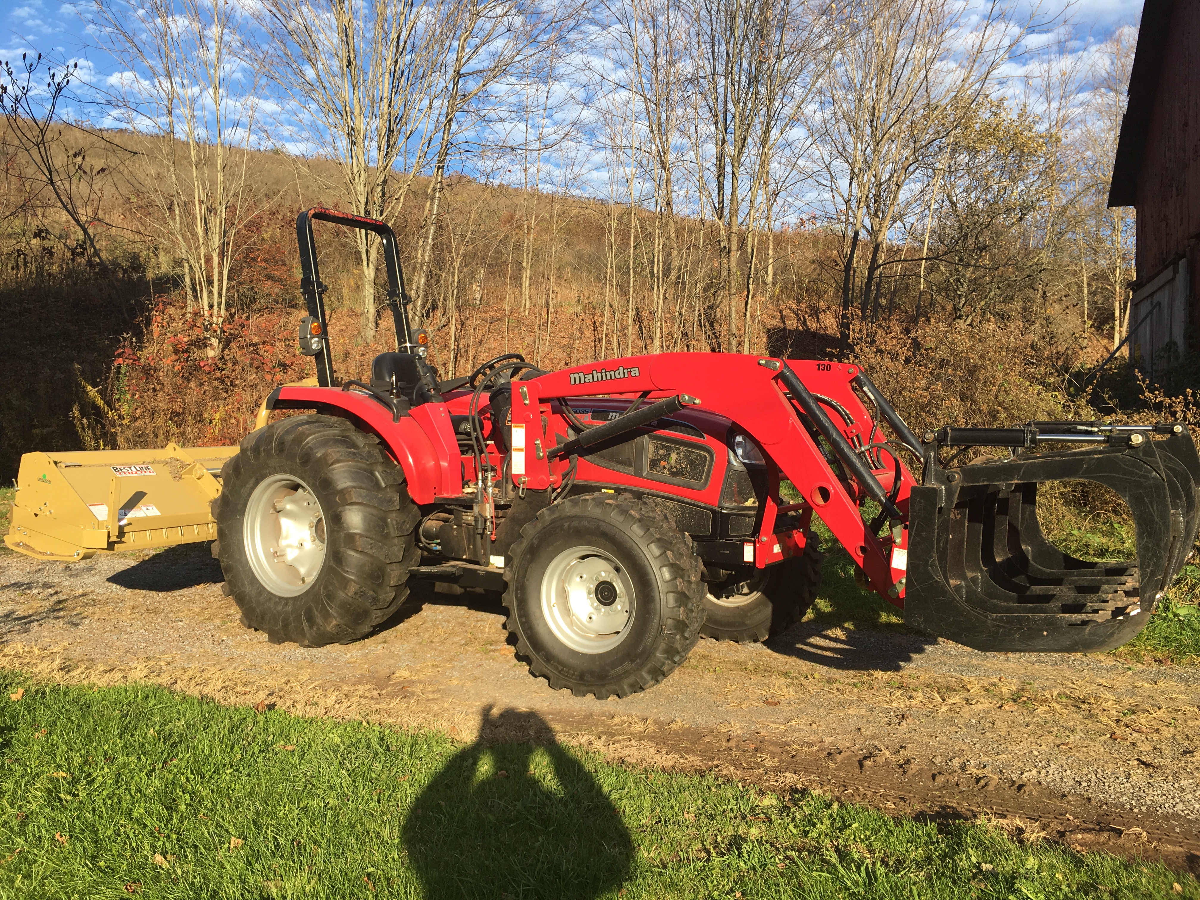

Finally had a chance to mow a bit during the day with the Fm4188. Just thought I'd post a bit more feedback.
Mows very nicely. Tackled lots of 1-2" multiflora rose and various other bushes and briars without issue. Occasionally I needed a second pass on some of the big stud to get it fully mulched. I took a couple pictures early on and then forgot to take any more. Doh!!!
I really like it. It is very heavy! I'm glad I have a beefy tractor! I like the offset. I wasn't sure I'd like it. Now I need to shift it further. It uses a very easy to use hand crank to shift it rather than bolting and unbolting the mount. I'd buy a hydraulic shift kit for it tomorrow if they made one. I wish they did.... if anyone knows of one that would work, let me know. I've heard the Landpride is a maschioto (sp?) and I emailed their contact page but never heard anything back.
If you have questions about the mower feel free to ask. I'm happy with it thus far!

I mowed with the door closed. Because of the terrain I was on, I didn't go fast. But it wasn't a problem at all. I will have to seem how it does on 6+ foot tall switch grass. Might need the open door then.
I'm impressed with what it handles which is why I got this particular mower. It is rated for 2" material.

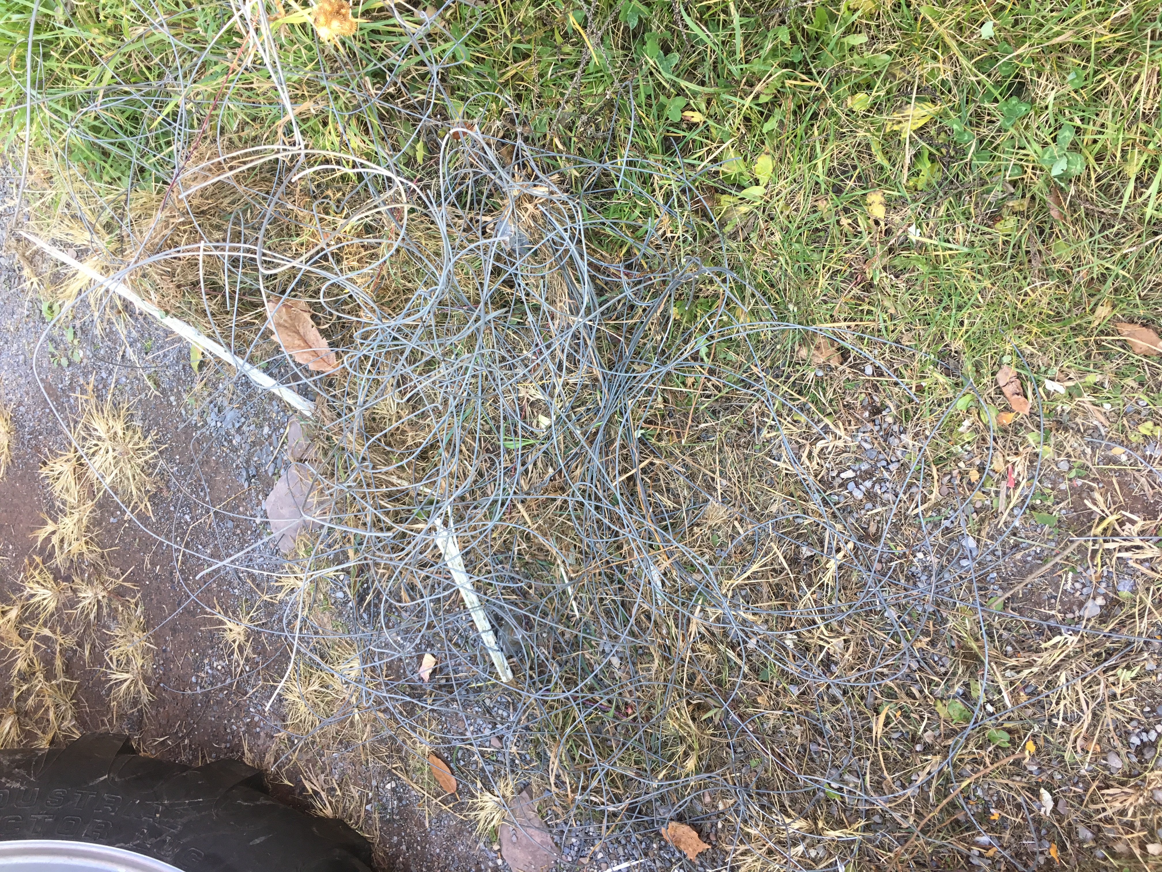

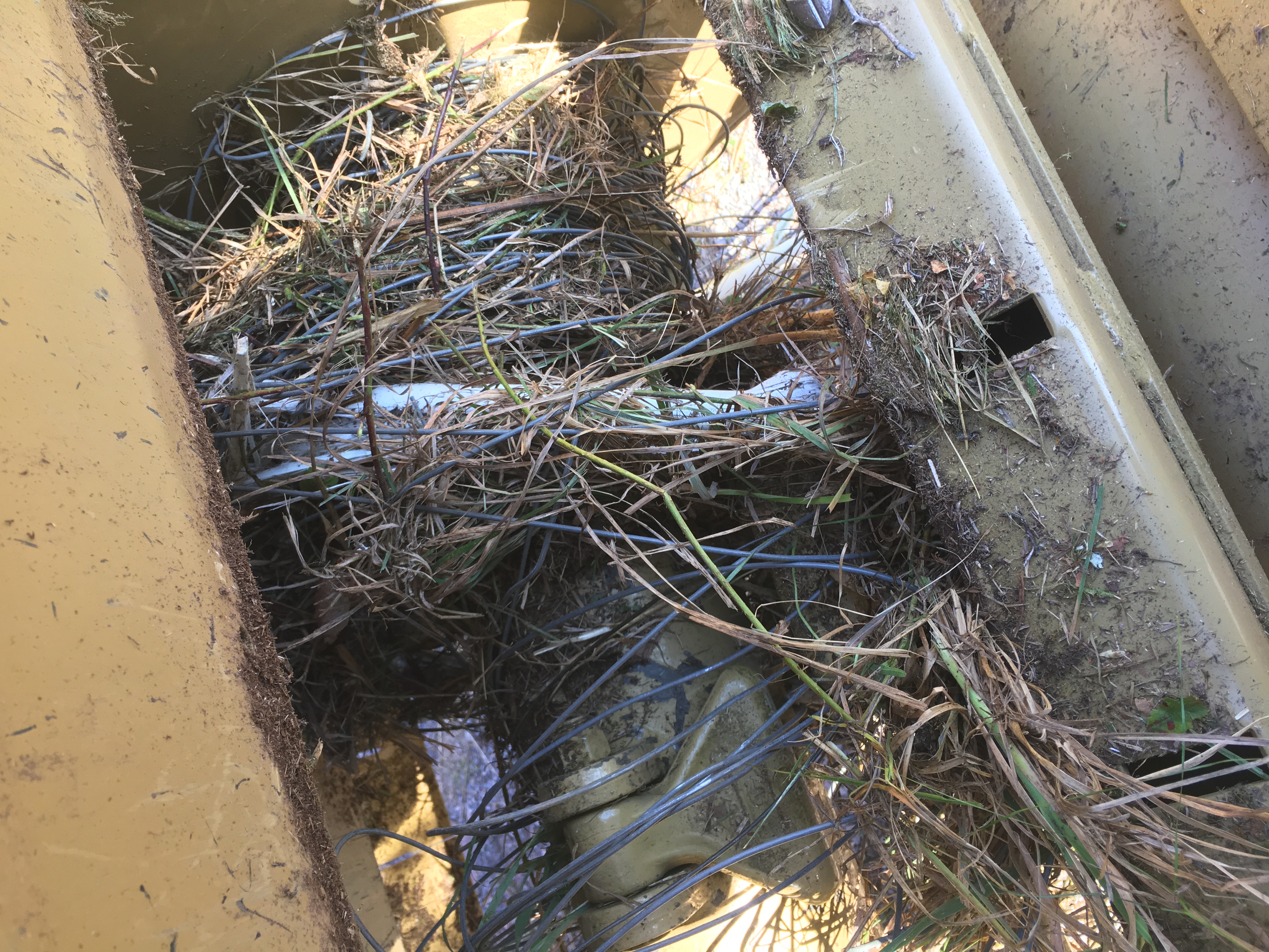

Had opportunity to use the trash door.... �� Unfortunately it was to use it to remove a huge amount of fencing wire that I hit. I saw it and let off the go just a split second too late. It shut the tractor right down. Not a little bit of wire. The previous owners must have piled it there. I estimate 50 feet of it at least. Took an hour and a half to remove. But wow, having that door was a life saver!!!
The before picture doesn't show all the wire under the grass. The after picture is just a portion of what I removed!!!
Back up and running without issue.

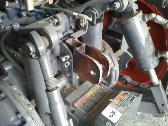

Here is another way to extend the top link.
View attachment 487010View attachment 487011
Hello Docsfarm,
I am glad you did not have to deal with the barbed wire snakes and the wire removal job went well.
