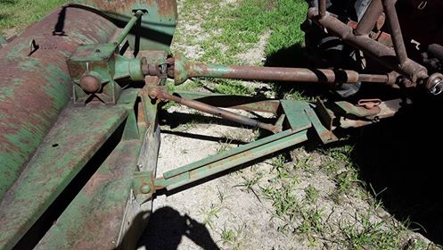

I was thinking on adding a swinging hitch on my Mott as it don't have the slot. It would be based on the design of my finish mower. Do you see any reason this wouldn't work.? It would be an easy fix.
I quoted IslandTractor so everyone would see what my question was about. Anybody have an opinion about me adding this or any reason I shouldn't.
That's how I have my QH set up on the top link. So basically, all my attachments act like a slotted link pin.
I may have to rethink that when I get a box blade but it works for the mowers.

Ok, I missed that. Sorry. Do the rear wheels have a height adjustment?
Yes they can be adjusted but I don't think that would work out so well because of the distance from the hitch to the rear tires. There is just too much if your ground is not perfectly level and mine is not that for sure. Going over any humps it would lower considerably. I think the best way for me to use it is to just hook the hitch to a drawbar on my 3 point lift arms.
/ Let's talk flail mowers #3,389
Possibly,,, you could add a roller that stays an inch or two off the ground,,, letting the tires do most of the work.
The roller would only touch on rough spots,,,
You would have the best of both worlds?? :thumbsup:

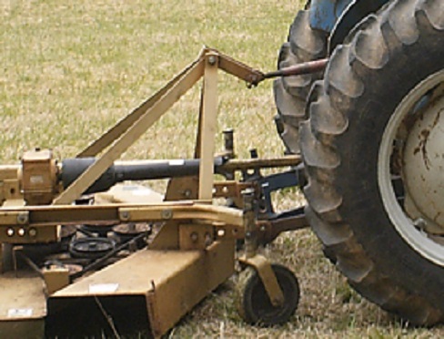

OK, lets back up a feet feet.
Can you upload a few pictures? Gearbox, front, rear, left side, right side and under the mower shroud taking pictures of both sides of the flail mower rotor and the knife mounts? That will halp a lot and tell me what model you have.
About your flailmower, does it have 2 mounting points and six sets of holes on the mounting points for a caster wheel?????
You cannot really adjust the mower this way. If you have the caster wheel mounts you need to order a pair and then you can rest easy and mow away to your hearts content.
