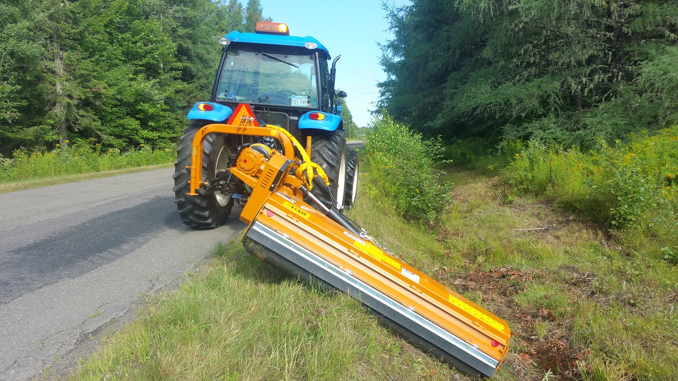

I got my new Berti TA/S 220 running today for the first time. This picture shows where I began mowing. I cut about 1.5km of ditch in under 2hrs and didn't break anything. The road looks amazing now, but you'll have to take my word for it, cause I forgot to take the 'after' pictures. Now I have quite a bit of work to do with the thinning saw and chainsaw so I can make room for the tractor on the other side of the ditches. Even though I can fit, it's too wet and I'm too heavy to drive down the bottom of the ditch cutting up the other bank. That job will have to wait for the leaves (and the temps) to drop.
I have a bunch more work to do with this Berti, and I'll make sure I film some of it.
