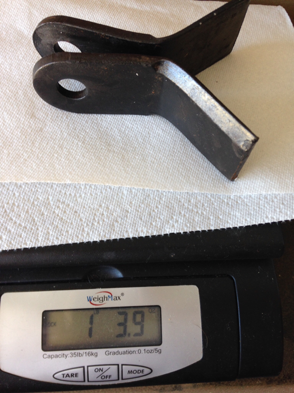

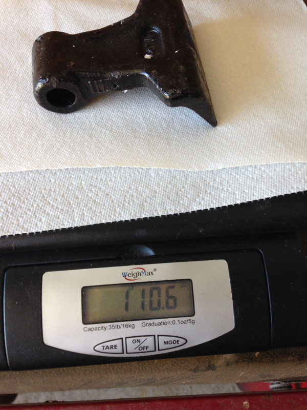

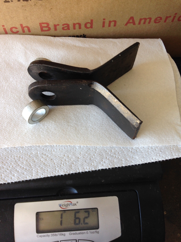

Yes I ran it with the rotor bare and it shook like crazy. Upon further inspection one of the bearings was too big and I bet that is where the shake came from. The bearing was oblong where it wobbled on the shaft. It was bad enough that something was wearing a spot on the shaft where the bearing sets against. I would call it the shoulder of the shaft maybe. The main problem I have now is the weights that were on it I have cut off in preparation for the new balance job I thought I was going to get. I can't imagine that the weight that was on it was original as one area had a hunk that was probably close to five pounds.
The weights on my Caroni are nowhere near five pounds. I'm guessing a matter of ounces at most.
If you set up the rotor in well lubricated bearings Ina workbench won't a five pound discrepancy be obvious even with static balance?
Oh I could see it easily when the rotor was still on the machine. Even a very small amount of weight makes the rotor move. I'm still looking for a place to balance it.
/ Let's talk flail mowers #3,338
If you can make it rotate with a small amount of weight that would tell me thats a good thing. If it took say 1lb to make it move that would mean its way out of balance. Are there any obvious reasons you think its out of balance like a missing station or a half missing station or are you going by the vibration.
I guess you've already replaced the bearings you said somebody put in the wrong size. Just a slight egg shape in the bearing housing or bearing race would case a vibration. Maybe you could start looking into that as opposed to the rotor out of balance. I'm just throwing out ideas maybe you'll hit on the problem soon.
It's going to take a lot of patience and work to remove the knives then install the bare rotor with the new bearings. Or if you have the knives attached already just go ahead and try it after you install the new bearings. Make sure all the bolts/pins are the same length. Longer ones are heavier :) Good luck with it.

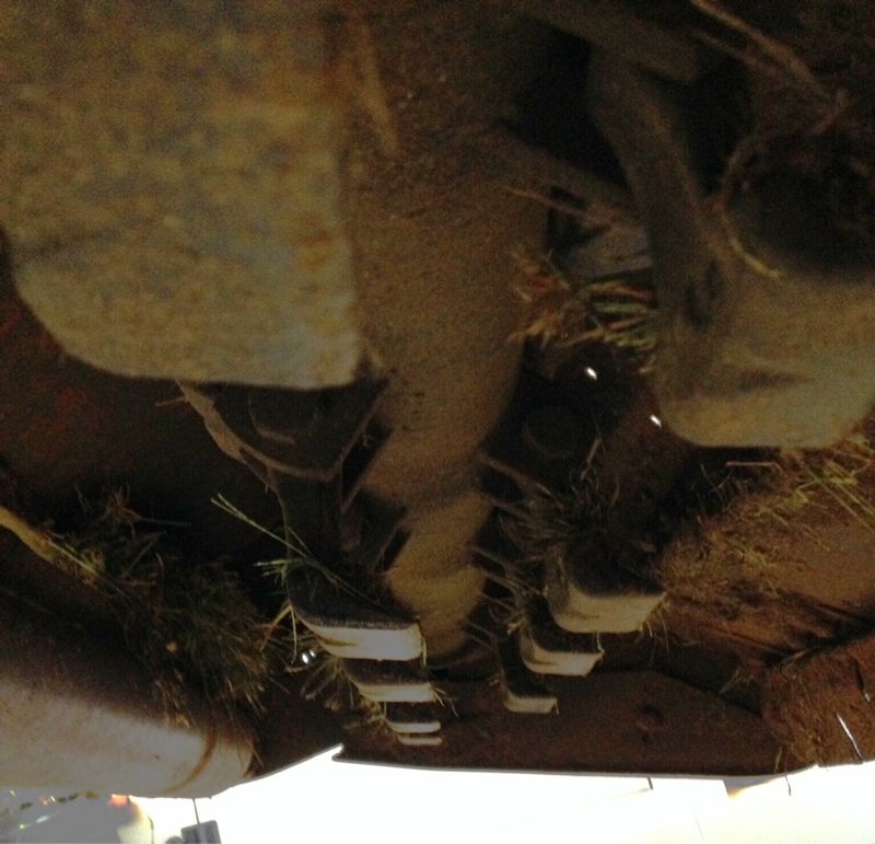

Well I could make it move with a small amount of weight. I cut all the weights off that looked like they were not factory to get it ready for the dynamic balancing I thought I was going to get. I imagine most of my problem was the wrong bearing. It was letting the shaft get up into the shroud even.
I put the new bearings on and installed the shaft today. I couldn't turn the rotor as one of the grass guards was bent and dragging on the rotor. I will work on that tomorrow sometime. I called all over today looking for someone to balance it with no luck. I'm going to start trying to static balance it and see how close I can get.
