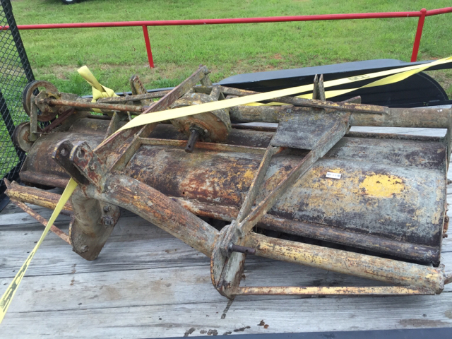

Shazzam!!!,
It appears you are looking at a MOTT INTERSTATER my friend.
If you have the time I would invest in it and with little TLC you
will have a flail mower that will outperform any rotary.

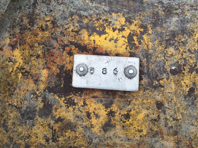

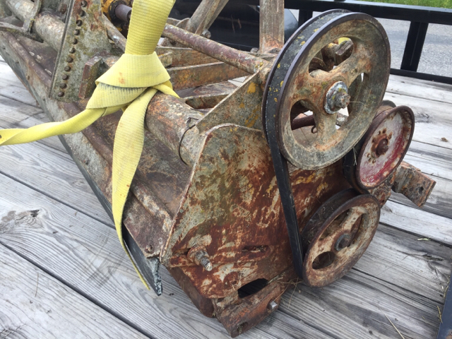

Leonz,
Thank you for the info.
I got it but not at the 300 bucks.

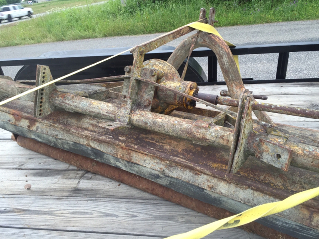

The gearbox and everything seems to rotate smoothly. All the knives are there but out on the ends which after reading through the first 800 posts(so far) on this thread, I see is common.
I'm not sure what the two vertical pieces are for on the back that are for an adjustable pin connection. Gauge wheels maybe?
It cost me 160.
Image1463614489.254182.jpgImage1463614502.615956.jpgImage1463614516.462436.jpgImage1463614528.351138.jpg
Headed home with it. Tickled to death.

The vertical breckets on the back seem to be just like the ones on the bigger Alamos's...gauge wheels...not sure why you would need them since the roller pretty much takes care of that.
You stole that mower.:thumbsup:

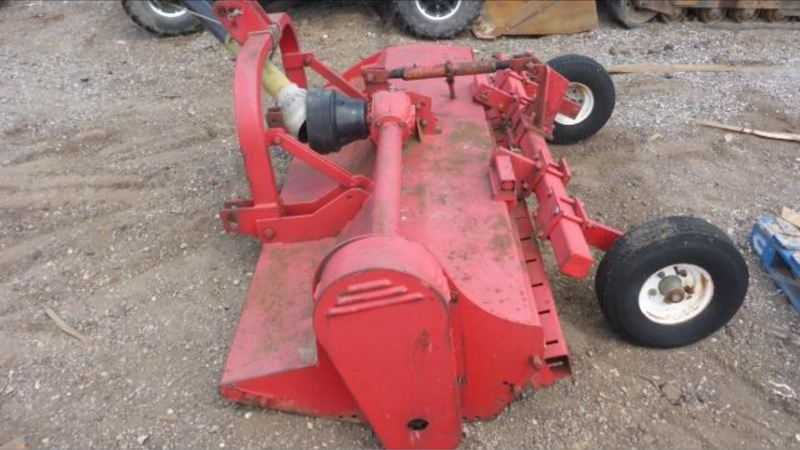

This looks like a SHD 96 with such brackets in the back.

You want to invest in the 2 gauge wheels to make it easier to turn and prevent gouging and mower nose diving by dips in the sod. That mower had a V belt guard on it at one time so you need to replace it from a supplier like flail master or find out if the owner still has the original.
****'s bells just tell her it was my fault and that I was passed over by the black helicopters when I told you to buy it!!!!!!!!!!!!!!!!!!!!!!!!!!!!!!!
Don't feel bad if all she wants is shoes; The new coal stoker boiler I bought just cost me another rescue mutt mouth to feed for at least 10 years and a a trip half way to Niagara Falls, WOOOF, GRRRRR!!!!!!!!!!!!!!!!!!!!!!!! Just don't let it turn into Imelda Marcos shoe closet!!!!!!!!!!!!!!!!!!!!!!!!!!
Welcome to the Flail Mower Nation my friend you will not be dissappointed as long as you read, follow instructions on how to set up your mower, invest in fine thread nylock lock nuts and bolts for the knife hanger stations and ask questions.
You want to invest in the 2 gauge wheels to make it easier to turn and prevent gouging and mower nose diving by dips in the sod. -----------

I've never understood the need/role of guide wheels on flail mowers. The rear roller, not guide wheels, maintains the proper elevation for scalp free mowing. Some say the wheels help in turns but my personal experience with a flail that doesn't have guide wheels is that I simply don't have any problem with turns. Why do only some flails have this option?
/ Let's talk flail mowers #2,933
I am just guessing but I only noticed them on the bigger/heavier mowers maybe it does help with tight turns if part of the weight is carried by the gauge wheels.:confused3:
/ Let's talk flail mowers #2,934
Shame on Me!!!!!!!!!!!!!!!!!!!!!!!!!
I forgot that the roller on these units is non adjustable
from what I remember now which required the gauge
wheels to control the mower height.
They mounted these beautiful flail mowers on a lot of
mules that were 35 HP or less-the MF135 for example
for state highway departments and they covered a lot of
ground with them as they mowed more often than they
do now and the rear wheels kept the mower stable
when backing at the same time when mowing as well.
It is a real shame that they do not invest in tracked robotic
flail mowers that can be run much more economically
than the current set ups.
The Wessex Flail mowers sold in Europe can be equipped with two or four corner
mounted gauge wheels and a hitch wheel as the flail mower height on most mowers sold across the pond have a stationary rear roller and those units are typically towed with 4 wheel drive truck or heavy 4 wheel drive 4 wheeler.
