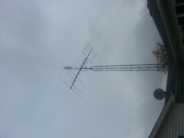

Well I know there are a lot of tou ham operators and others out there that know about radio waves and such. I have a tv antenna that isn't being used anymore because of the dish. I would like to utilize it for fm reception. There is a receiver in the house and in the garage that need better reception.
For whatever reason there are 2 different types of antennas up there (see pic) pointed east. I live about 80-90 miles west of Chicago and about 40 miles south of Rockford, both of which transmit. I would prefer Chicago, and that is where the antenna is pointed it seems. The two antennas feed into some kind of box, which then has a coaxial cable running down the tower. I can split that cable and run coax to both places using rg6. The question I have is how do I connect it? The receiver in garage has both a 75 and 300 ohm input. I see 300 ohm adapters, but do I really need that since I have the 300 ohm input? I don't see any just straight coax adapters to wire to the screw terminals, so how do I wire into those unless I use the transformer?
Also, what do you suggest with the antennas? Keep using them both, or just one? Airwave transmission is quite confusing and what I am trying to do seems pretty simple. Thanks for any suggestions.

The two antennas are top UHF bottom VHF. The box is a combiner. Leave all that alone.
Put a 75 ohm to 300 ohm transformer on the end of the coax and connect to the 300 ohm terminals on your radio.
Receivers are not near as picky as transmitters it should work very well.

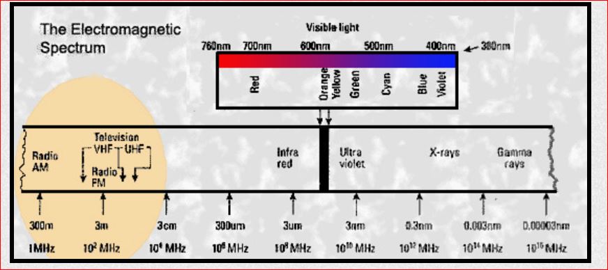

The FM radio band fits in approxametely the middle of the VHF TV band.

There is probably a FM trap in there which reduces FM interference to TV signals in the CH2-CH6 area in particular. FM radio is in the spectrum between TV CH6 and Ch7. I would retain the ability to receive TV from the antenna.

You should get much better reception than the car radio.The ants on the tower are being fed into a preamp which I assume is not being fed any power from a transformer.Won't get much of anything from the ants without the transformer.If you go up the tower,take some new coax and a new outdoor balun transformer and hook it to the bottom ant.It looks like a channel master crossfire and may have a builtin balun.If so,hook the new coax up to that.A dedicated FM antenna will work better.
/ let's talk antennas #8
The tower setup is UHF/VHF seperates with a dual input preamp.With no transformer to that preamp not much of anything will come through.you need to run coax directly to the lower VHF antenna without a preamp for best FM reception.Can't see the pic well enough but looks like a CM crossfire and might have a built in 300/75 ohm balun that you hook the coax directly to.If not,install a new outdoor balun on the terminals then coax on down.For best reception a dedicated FM antenna would be ideal.Never use a preamp for FM.

Most of the time 88 to 108 Mhz signals go right thru the ionosphere like a bullet thru a spiderweb. HF (3 to 30 Mhz) can and do bounce off of (the term is refract) from the ionosphere, but in general VHF (30 to 300 Mhz) signals go right thru it and on to outer space and on and on. Yes there can be sporadic E cloud refraction, yes there can be reflections from thermal layers in the atmosphere, yes there is meteor scatter, yes there is tropospheric ducting, yes there can be aircraft scatter, BUT in general VHF signals radiate up and out.
If you think about this a little bit, this is why we don't use HF or MF signals to try to communicate to space craft. We use VHF and UHF and SHF signals to communicate with spacecraft as they will leave our earth and travel beyond to where spacecraft are located, whether that be in Low Earth Orbit, or further into deep space..
So, in general you point an FM Yagi or Co-linear or any VHF array at the horizon (plus or minus 10 degrees of elevation) and on the azimuth of the station you wish to receive, NOT towards the sky. Unless the station you wish to receive is actually in the sky!

The lower VHF antenna is the CM Crossfire 3610 as suspected.It has good FM gain and will pick up all the Chicago stations clearly unless it's corroded badly everywhere,missing elements,etc.
Channel Master Model 3610 VHF TV-FM Antenna
It appears to not have a built in balun so you'll need to hook a new one on the antenna terminals,then run coax to your tuner(s).

alright, so it's been a few months and I thought I'd give anyone interested an update. After running the coax, there was a big improvement to the reception of more local stations. I have not been overly impressed however at the reception of some more distant stations. Since the weather is somewhat breaking around here, I decided to investigate the box on the tower. It says "galaxy 3" on it. I have done a little research on it, and I guess it's a uhf/vhf preamplifier, and should have a powered amplifier somewhere. I have no idea where that is, I'm not sure that it exists. Also interesting is that while it does not specifically state that it has an fm trap, it states
Note: FM response is reduced to maintain distortion free
TV reception in the presence of strong FM signals. Preamp
will pass FM adequately in stronger signal areas, but is not
intended for critical weak signal FM preamplification.
So, without the amplifier that is supposed to mate with this, I assume I should replace it with something intended for fm reception? Any suggestions? I have no intent in the near future to use the antenna for uhf/vhf or any other kind of tv signal. I may look around a little more to see if I can find the amplifier.

Keep in mind for a mast mounted preamp to work it must have a source of power inside feeding the transmission line. Since you don't know where this is, or even if it still exists, and your research indicates this preamp is actually an attenuater in the FM band, I would remove it.
