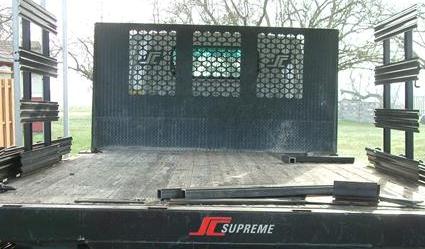

Are you talking about a headache rack?
I do not have a specific picture of mine, but you can get a sense of it in this pic:
The back rack portion is sitting in the front right now, but when I need it (to haul canoes, etc) I just move it to the back pockets.

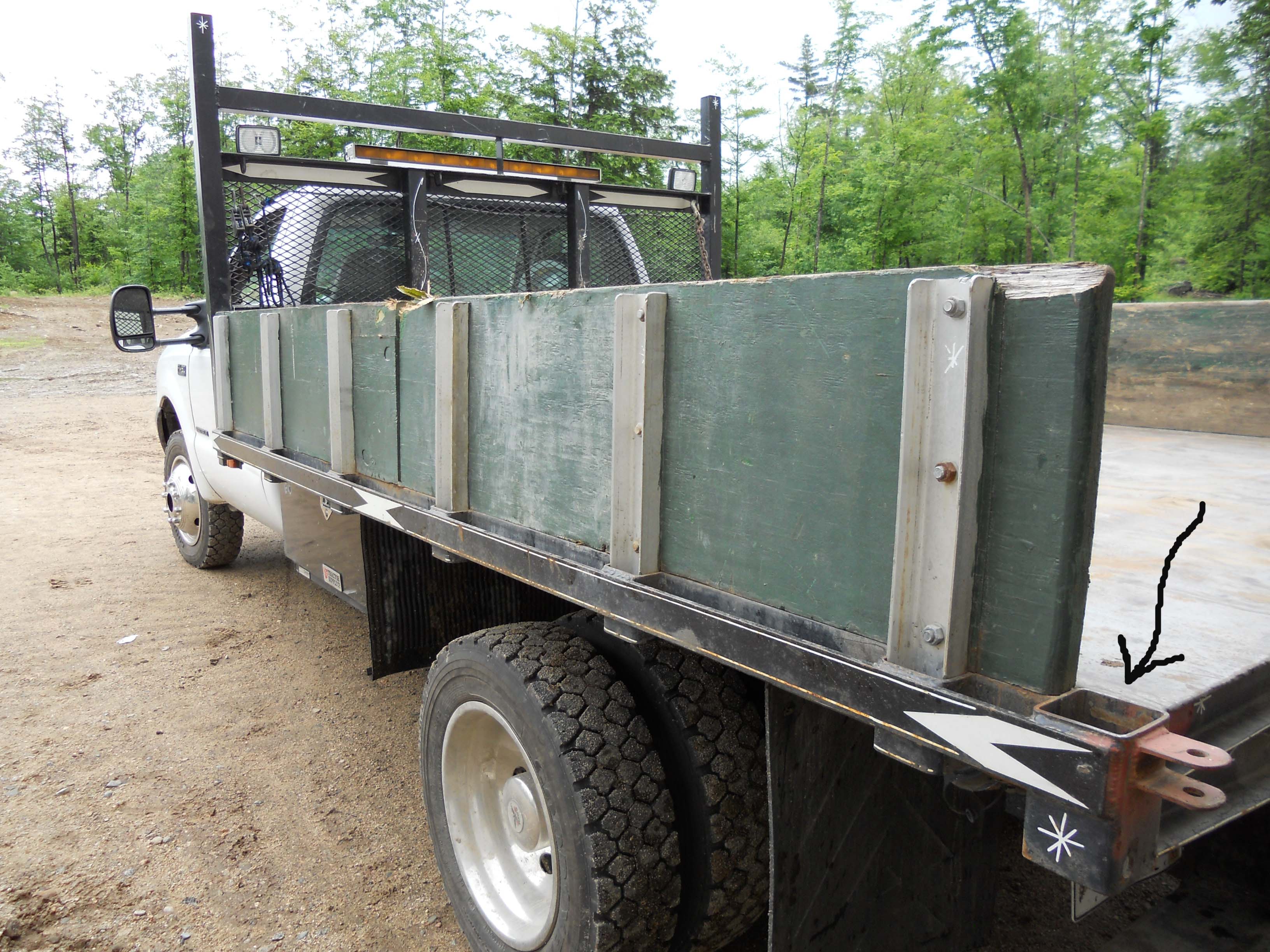

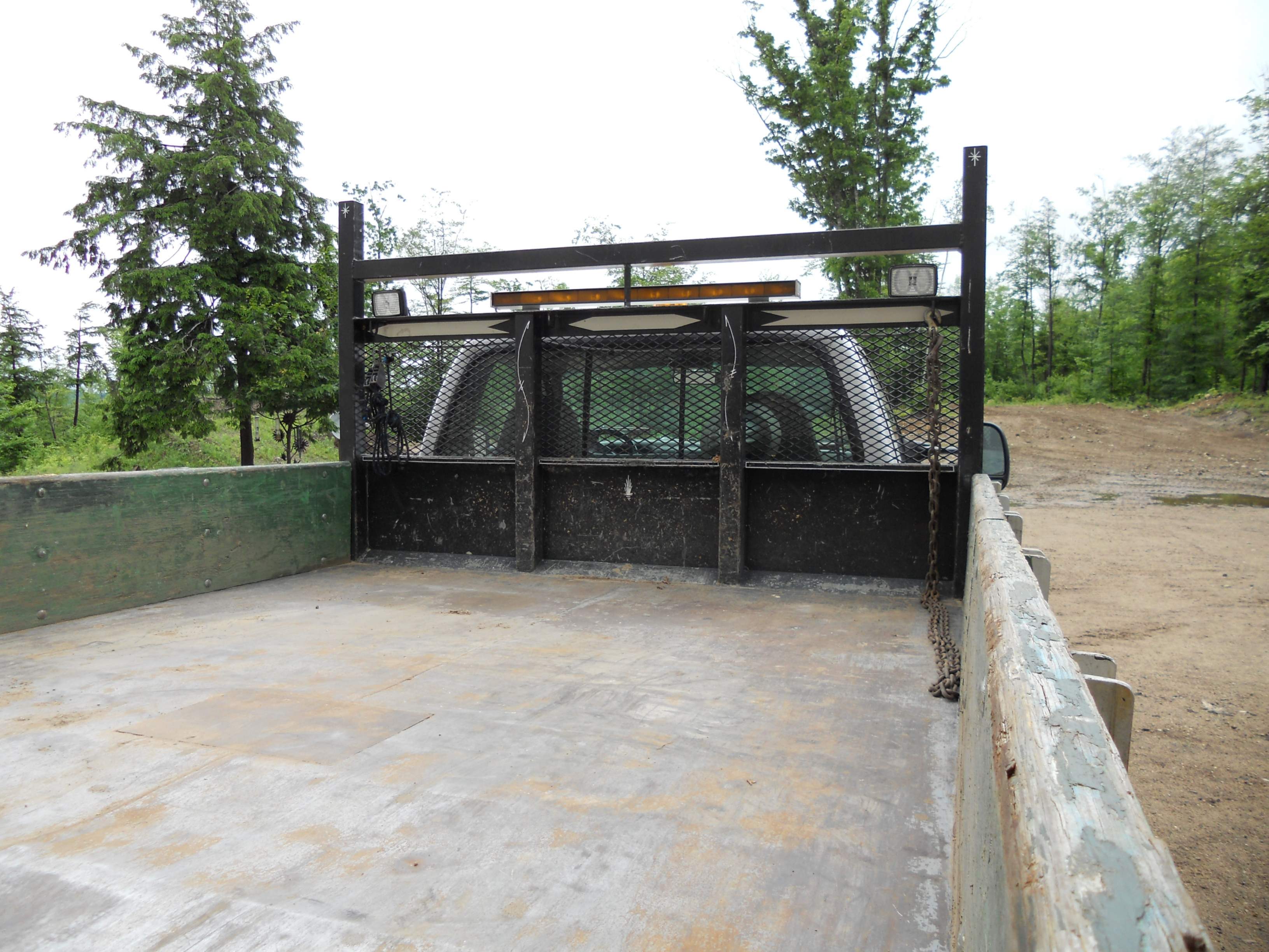

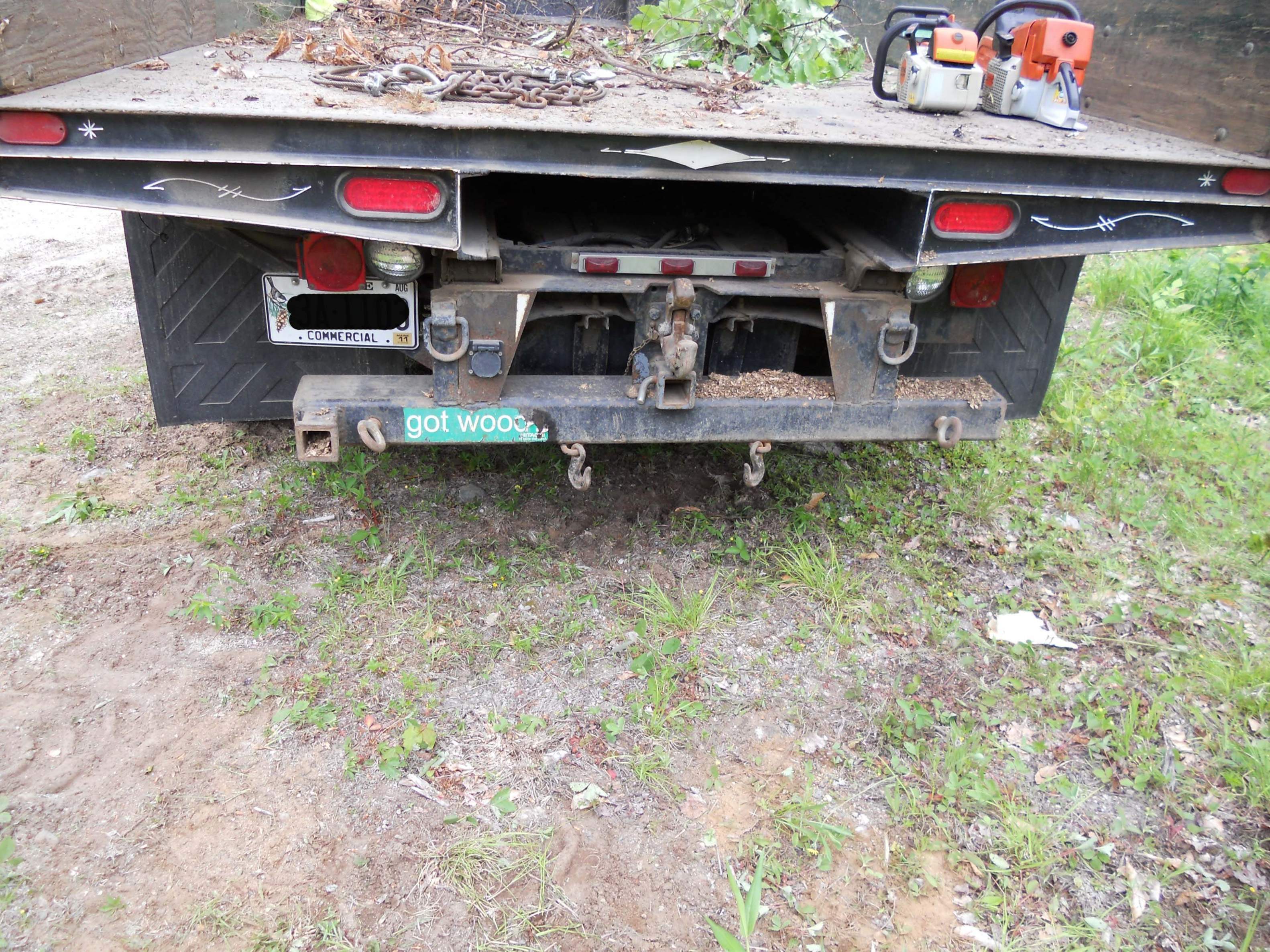

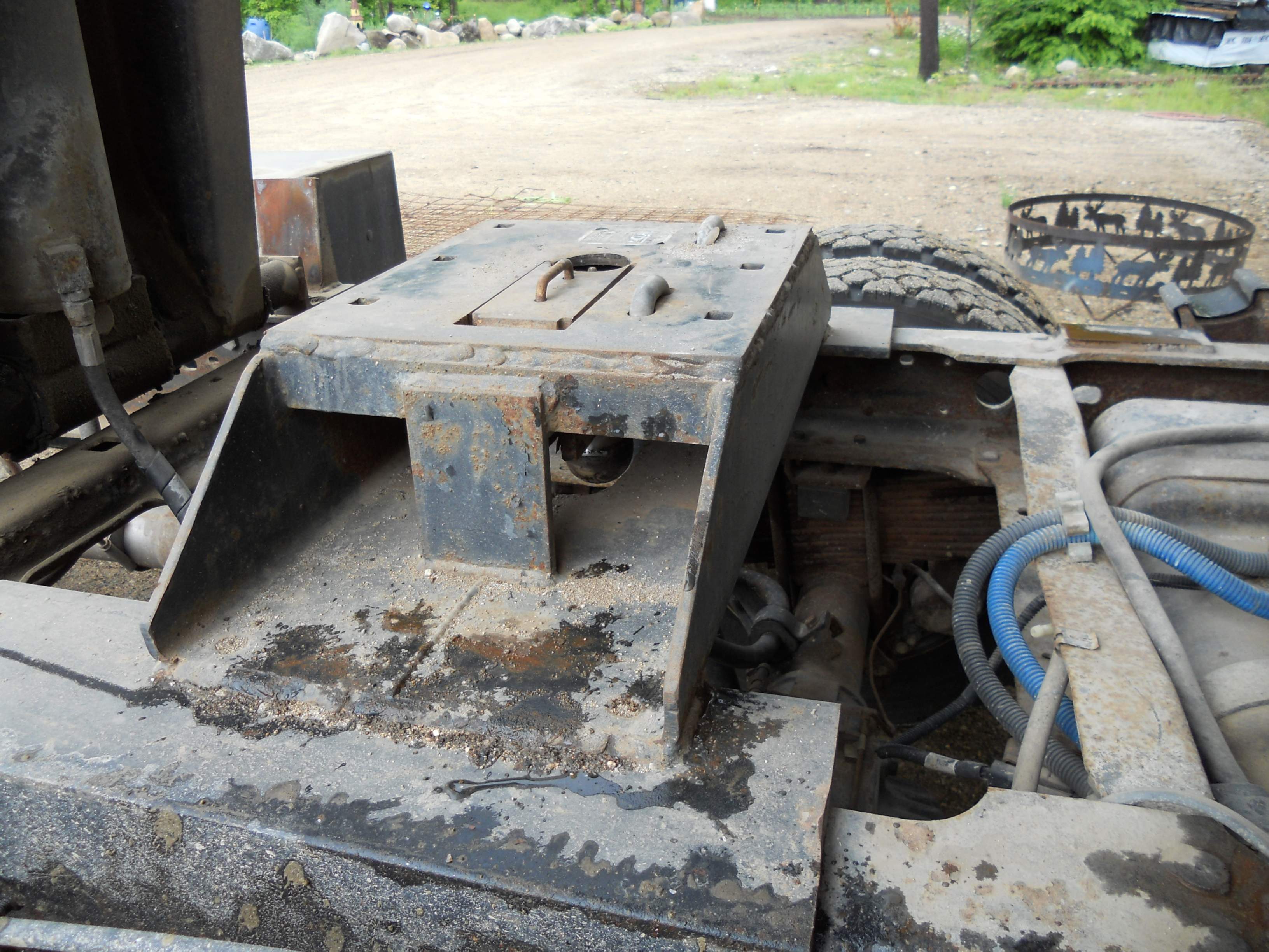

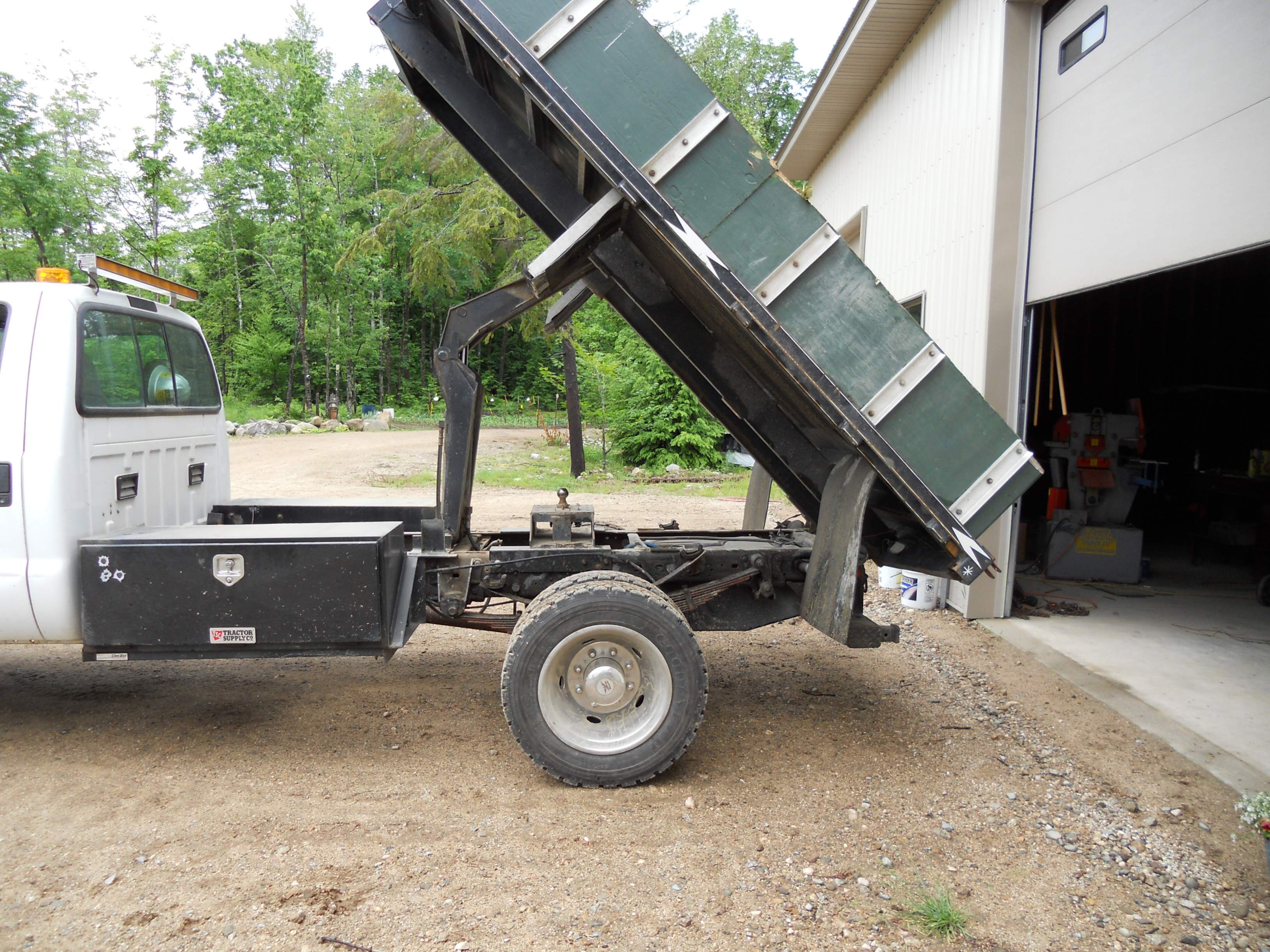

Davy, here's some pics of what I built.
I ended up making the bed because it seems that all of the "store bought" dumpers have an extra riser or long sill to make installation easy for the body guy. (the hinge assy. is all done) I did not want the extra bed height. For the racks (sideboards) I had some 18" wide micro lams around for the side boards that I bolted to some alum chanel. On reasonably level ground I can leave the sides on while towing the GN, but it (the gussets on the trl. neck) will sometimes hit the sideboards so I usually take the back ones off when towing. My hitch is only a few inches too high to leave the cover in place with the ball up. With a little more planning on my part I could have used a ridgid mount ball.
Two things to check out on your truck are 1, when adding the hoist later, are the long sills on your bed suitable for directly mounting the hoist? I believe that most platform (stake) beds are built with a lighter long sill as they are (basically) only a spacer between the trk frame and the bed and are not built for the twisting that a dump bed will see. 2, Will the bed height change much when adding the hoist. (for ball height considerations). Just a few things that I thought about having been there. FWIT, if your truck's drivetrain allows, go with a PTO pump for your hoist, you'll never regret it!

Yes, thats what I was looking for, side racks for the stake pockets. The truck came with the pto pump, so I am ready to go. the owner of the truck center said it would not be a problem later on to put a hoist in, but one of the guys working there said that with the racking of the body when it dumps I might have trouble opening, and closing the trap door for the hitch ball.
