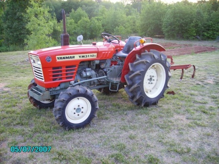

I know my dealer is not a member of the Used Tractor Dealer Association . And I get real good tractor at a good price. .My dealer dose OK. And it has never been painted it look like it did in Japan. and my hydraulic is not bad. and my 3pt will stay up all week on all three of them.

Gismo is that your 3110 in the picture?
It sure looks nice, I have a 24x36" poster of a new 3110 with a farmer sitting on it in Japan. Looks just like the one you posted.
Ernie
