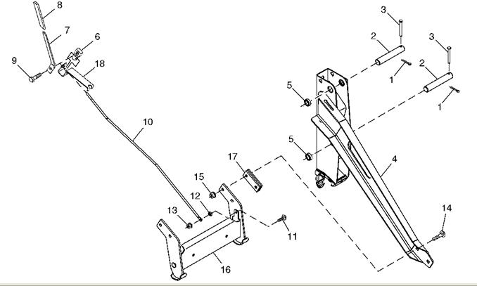

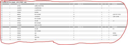

anyone know of a part number, price, or have one laying around?
/ left side boom for 430 loader? #2
Have you registered at JDParts (it's free), there is a tutorial linked in my signature.
Which part do you need, and why?
the left side claw is worn a bit. tried to shim it but am not happy with it still. maybe i'll just put more shims in.
seems like this style of loader has this happen a lot. do the newer 300cx etc series have this same issue?
/ left side boom for 430 loader? #4
Very likely the only thing needed is an adjustment in the side arms that attach to the front weight bracket. There are two bolts to loosen, slide that arm and retighten. Lengthening the arm will give more rotation of the "claw" around the square post and remove the slop (which sounds like what you are describing).
This is an adjustment that is supposed to be made when setting up the FEL, but can easily be missed (or forgotten or ignored) by the set-up crew. I've had the 430 FEL for 14 years, and no "issues" with slop.
Do as kennyd suggests, and look at all the parts of the 430 on jdparts.
A pic of the problem area may help answer/help you more.

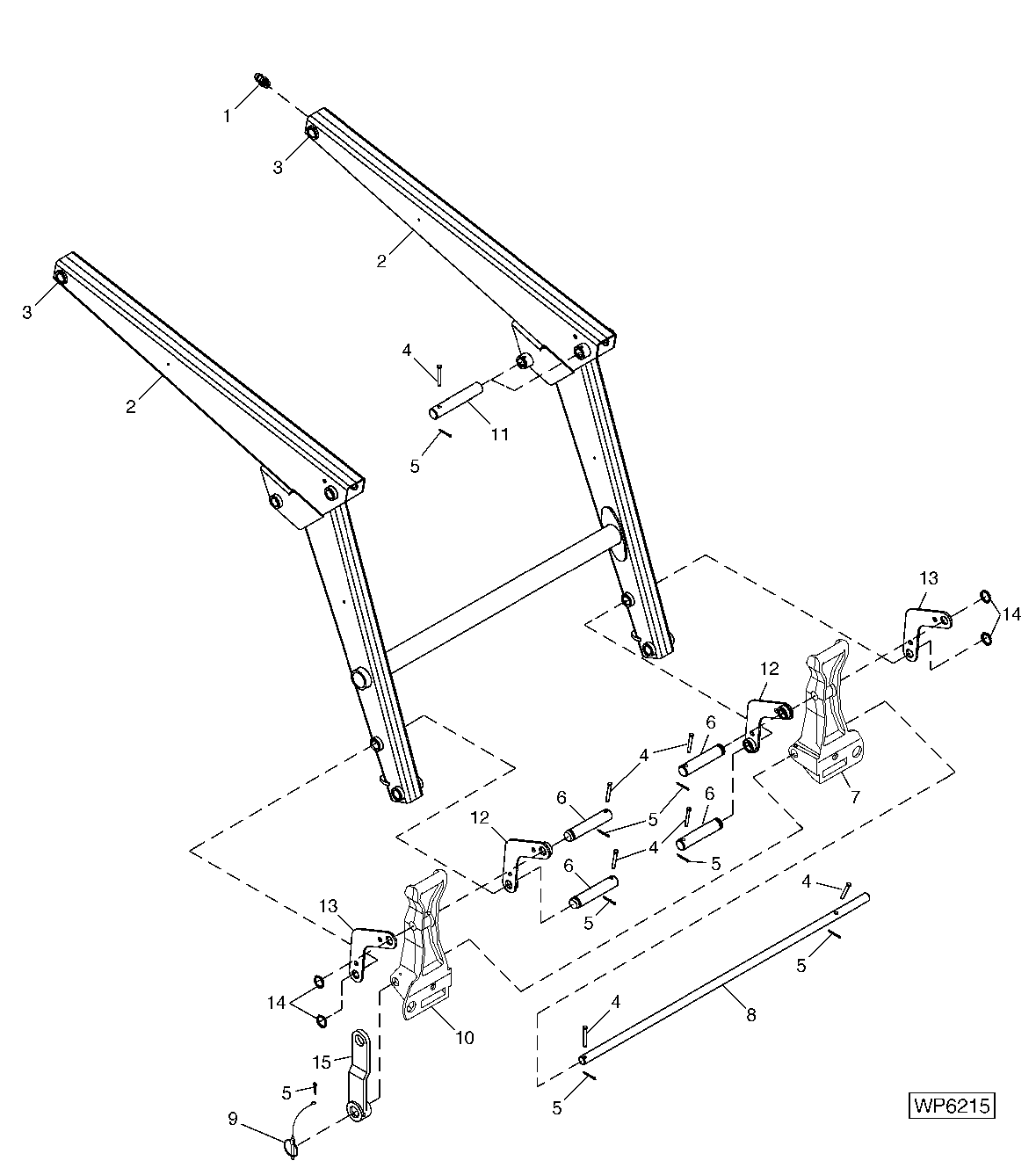

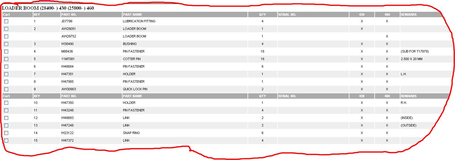

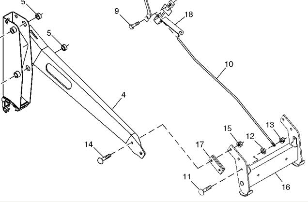

Here is a jdparts view of the mast and front frame, and the bolts #14 are where the adjustment is needed. There are shims shown that may be needed for some installations, but doubt you would need any shimming, just lengthening. The procedure should be in the 430 manual, but it isn't. See if you can stop by the Deere dealer and ask for the set-up materials they are supposed to use.

When you first posted this procedure (on another thread a few months back), I went out to see if I could adjust my loader's mast and arm. Bolt 14 is a carriage bolt (no flats or allen socket) and the nut is welded into place. The hole the bolt goes through is round (not slotted as one would expect for an adjustable fastener). The paint on both the bolt head and nut are Deere green and match the adjacent area, so I don't think anything was removed or replaced (i.e. factory stock).
Maybe I'm dense, but I cannot see how an adjustment could be made...not as you've described it. Have you made this adjustment? If so, can you be more precise on how it was done?

Well, I just got in from a visit to my Deere dealer.
I had a chance to talk to a technician who sets up most of their loaders. He said the loader mount (part attached to the tractor frame) can be shimmed to tighten up the mast, but a better fix is to build up weld on the mount (or the mast, but that requires transporting the loader if you don't weld) and grinding the weld to suit.
The sole adjustment (on the 420 and 430 loaders) is up by the front mount (near the weight bracket), but that doesn't affect the masts.
I'm not sure where Beenthere came up with adjusting at a bolt, but apparently there is no adjustment (other then shimming out) for tightening the masts at that bolt.
