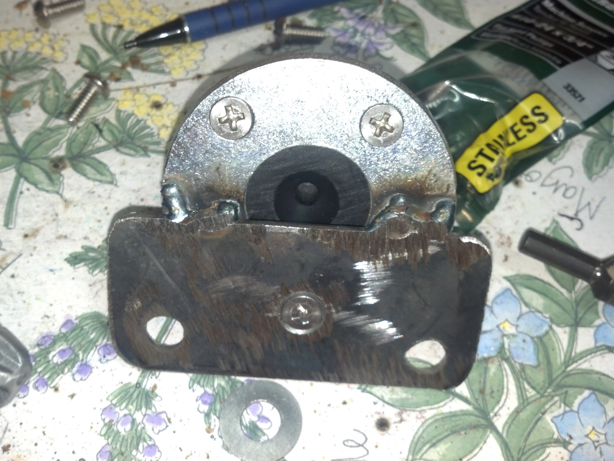

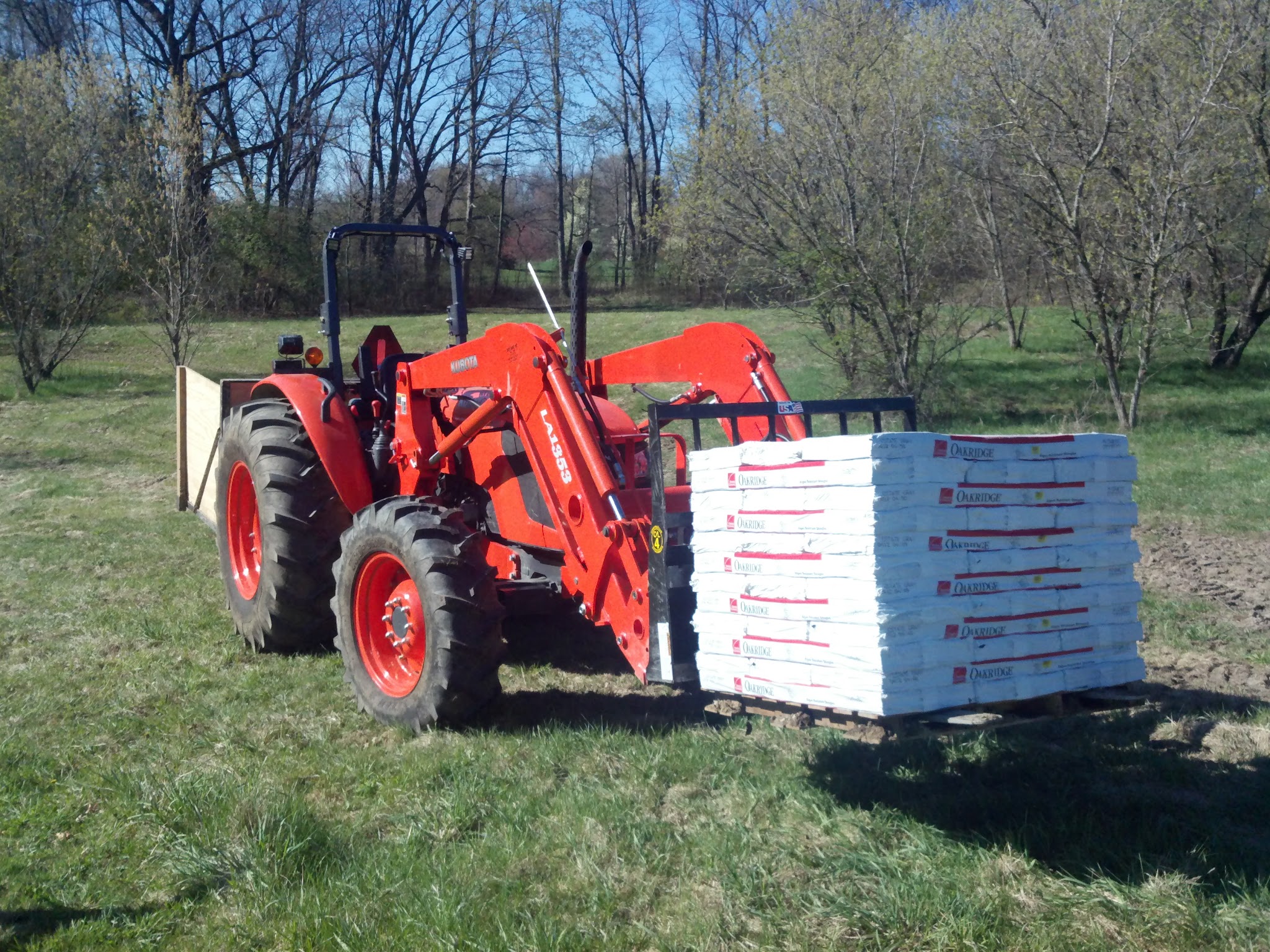

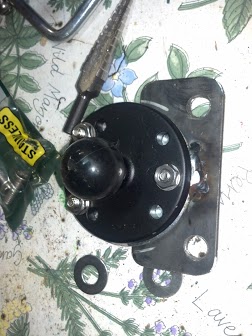

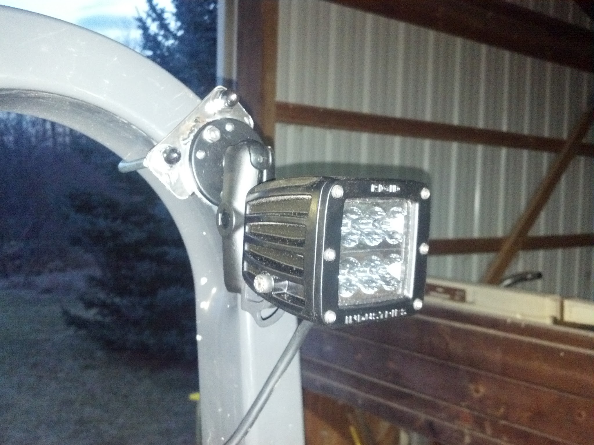

Hey Guys i'm new to the forum but i Mounted two Rigid Industries Dually Wide angle D2's (Made in USA) on my M8540
These things are 27 watts but produce almost twice the light output as a standard 55 watt halogen. They do produce heat as others have mentioned in this post. I mounted them using a RAM mounts so i can easily adjust them or face one backwards and one forwards. My 35 watt kubota rear work like looks like a flashlight compared to these things. I should really set up my SLR to take some comparison shots of the Tractor head lights compared to the Rigid. at approximately 100 yards distance from tree line to my barn. with the LEDS on i light up an area about 50 -100 yards wide at the tree line depending on placement. Switching the tractors high beams on only makes a miniscule difference in the light being thrown out.
These lights are not cheap but besides being made in USA rigid also includes a full wiring harness with OE type waterproof connectors a lighted switch and relay. I typically only use the stock headlights when traveling public roads

Interesting idea in using the RAM mounts. I'd have never thought that, even though I use, and LOVE Ram products for my GPS and phone mounts.
   / LED Lights #56
Thanks i use the ram mounts on my motorcycles for gps and cup holder as well. I've never seen them used before for lights but as an engineer i was trying to come up with a good solution, this works well. One of these lights facing forward and one rearward for moving snow with a backblade works well. As you know it only takes seconds to reposition a RAM mount

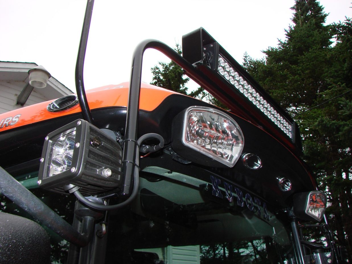

Now that I've had the opportunity to use my LED's at night with all this snow we have I got three problems.
#1. There to bright . It's crazy how bright they are in a good way
#2 They are so bright that when I turn them off while traveling on he road and turn on the tractors OEM lights it seems like I have no lights at all on :mad:
#3. I just never want to turn them off :D
Glad you enjoyed that thread. If you want to see how the lights worked out I uploaded a night vid last evening.
