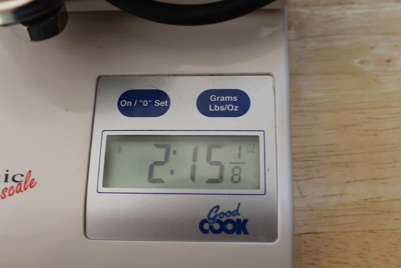

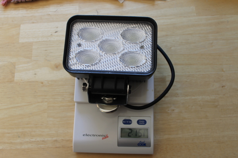

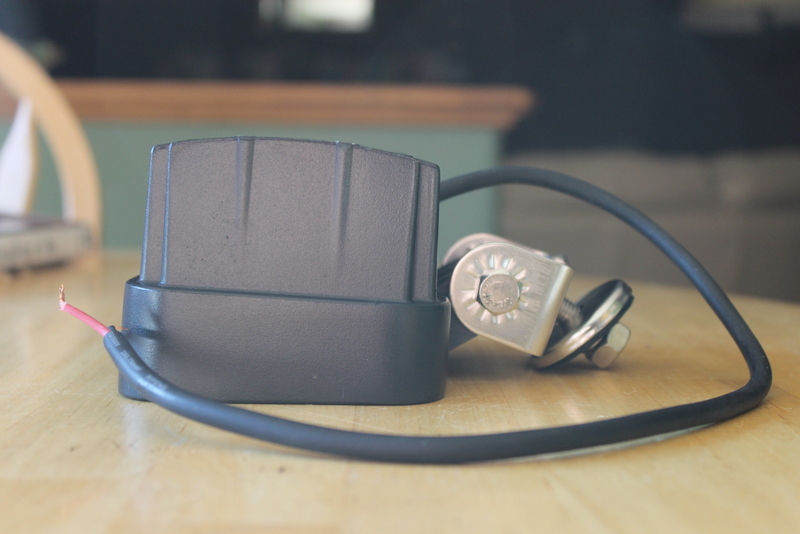

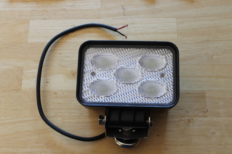

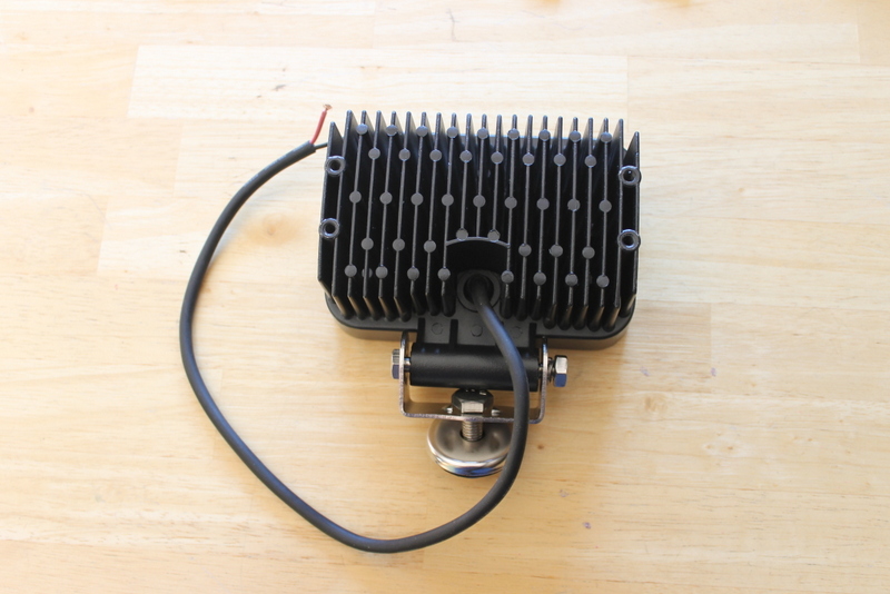

I received my 50 watt flood light today and it is heavy and really well built.
Here are some pictures of the light: IMG_0554.JPGIMG_0556.JPGIMG_0557.JPGIMG_0558.JPGIMG_0559.JPG
I will get more pictures up once I get it all wired up.

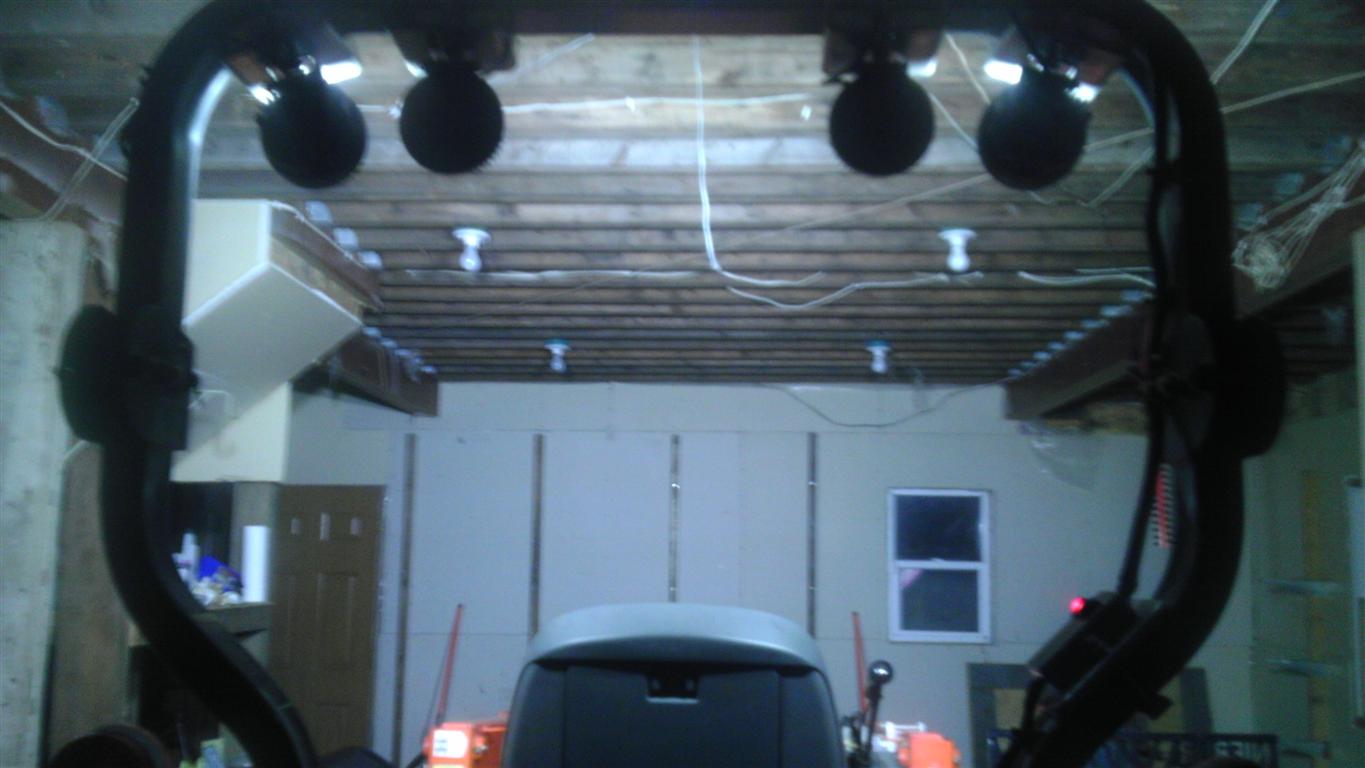

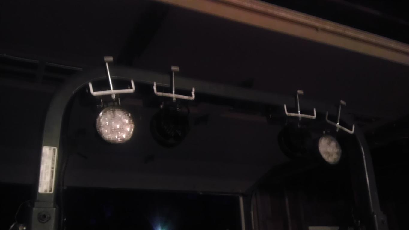

I just added 4 LED lights to my tractor for winter snow removal needs. I picked up 4 of the 27 W floods from seller "ledstores" on ebay. They sell the typical China stuff, but are based in the US so shipping was pretty quick. You have to specify flood or spot when buying from them or they will randomly pick for you. I assumed the floods were more suited for this.
Pictures are lousy as I only had my cell phone on me and it was getting dark when I finished. The brackets were a bit of a lucky find. The metal place had some alum 1/4" that had been bent into a shallow channel in the drops piles, so I grabbed one of those pieces and sliced it into 2, drilled a couple holes, and milled a slight recess so they would stay put on the ROPS. Basic flat alum bar plus bolts for the retainer brackets. I kept them all to the inside for door clearance as there was only an inch or two before and I didn't have much to spare. Basically 2 facing forward (the outer ones), 2 facing back, and they can rotated and adjusted as needed. Separate switches for forward and back sets ran directly off the battery on a new 15A fuse. Wires were run in split loom tubing up and around the back side of the ROPS using those zip tie mounts with foam tape on them. It is reasonably clean install and should do the job.
This should do the trick...
You can see the red light on the switch box inside the ROPS at the lower right. Only the front set is on.
