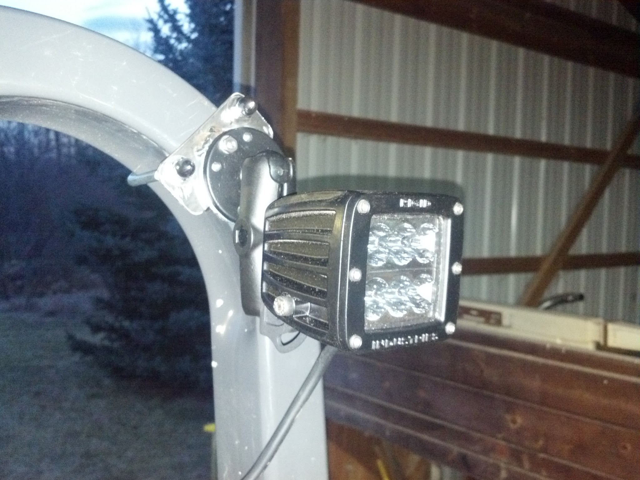

Hey Guys i'm new to the forum but i Mounted two Rigid Industries Dually Wide angle D2's (Made in USA) on my M8540
These things are 27 watts but produce almost twice the light output as a standard 55 watt halogen. They do produce heat as others have mentioned in this post. I mounted them using a RAM mounts so i can easily adjust them or face one backwards and one forwards. My 35 watt kubota rear work like looks like a flashlight compared to these things. I should really set up my SLR to take some comparison shots of the Tractor head lights compared to the Rigid. at approximately 100 yards distance from tree line to my barn. with the LEDS on i light up an area about 50 -100 yards wide at the tree line depending on placement. Switching the tractors high beams on only makes a miniscule difference in the light being thrown out.
These lights are not cheap but besides being made in USA rigid also includes a full wiring harness with OE type waterproof connectors a lighted switch and relay. I typically only use the stock headlights when traveling public roads

How did you wire them? I assume you have a toggle switch so that you can use them indenpently from the factory headlights?
/ LED Lights #64

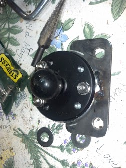

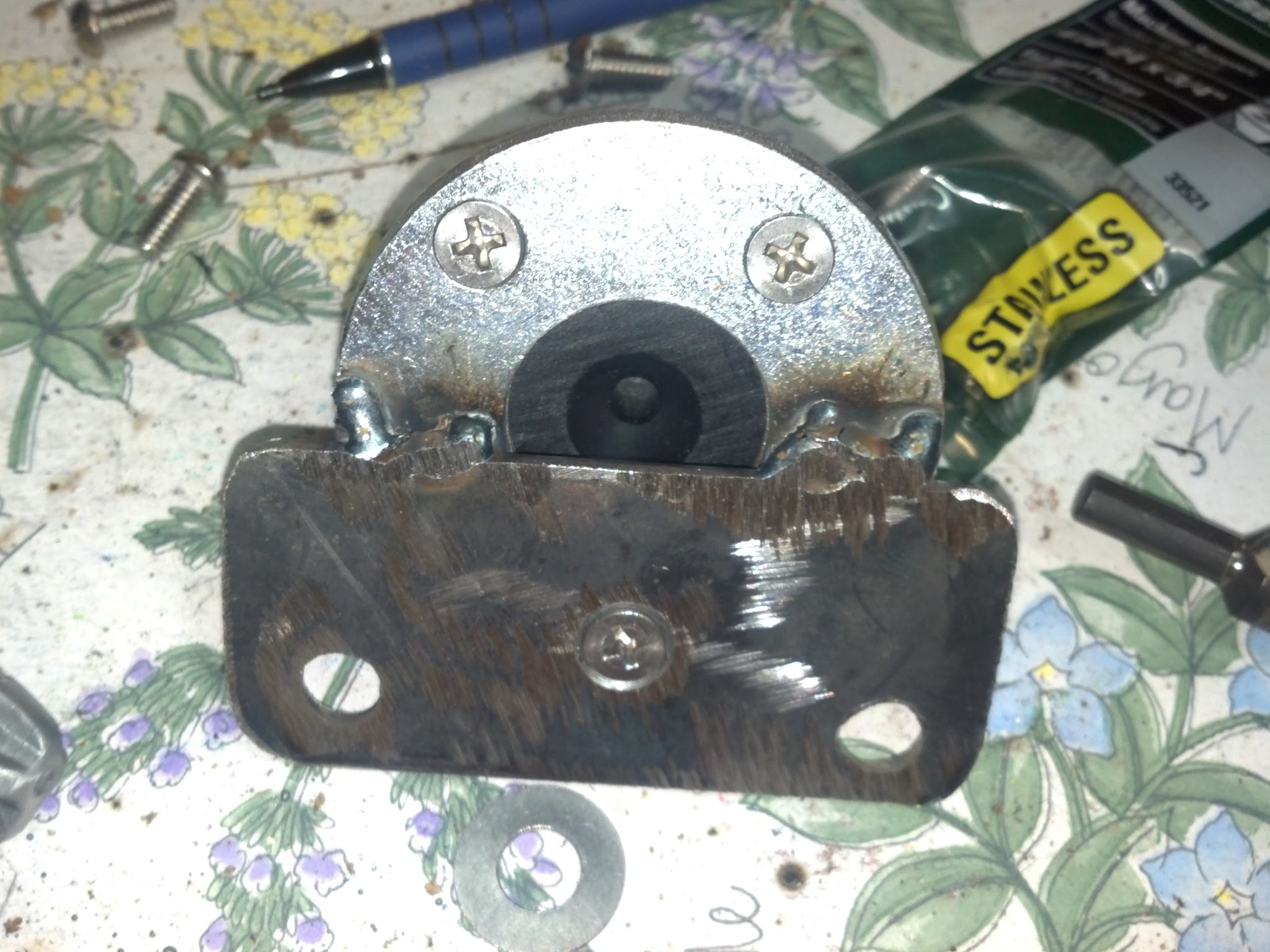

That was really easy. Rigid supplies a complete wiring harness with relay, Lighted water resistant switch and waterproof automotive style connectors at the light. I installed the switch and relay in and under the plastic trim panel that covers up the area between the 3pt control and the rear valves. I ran the wire down and under the platform and tied into the accessory harness on the right hand side of the motor. I believe this harness is normally used for 3rd function valve on the loader. I believe the regular duallys do not included a relay just a switch and harness because the amperage draw is so low. I'll see if i can find a picture of the switch.
