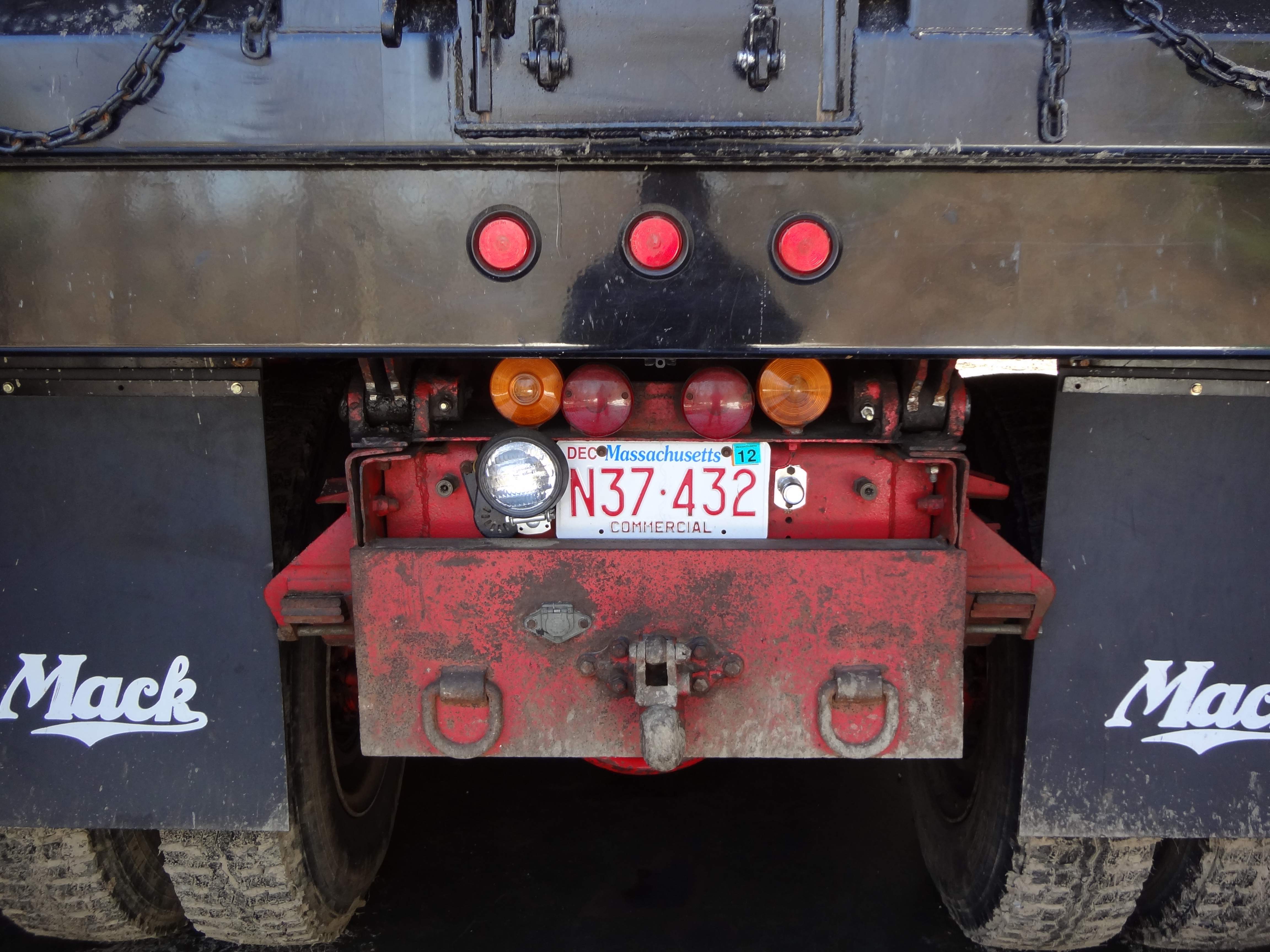

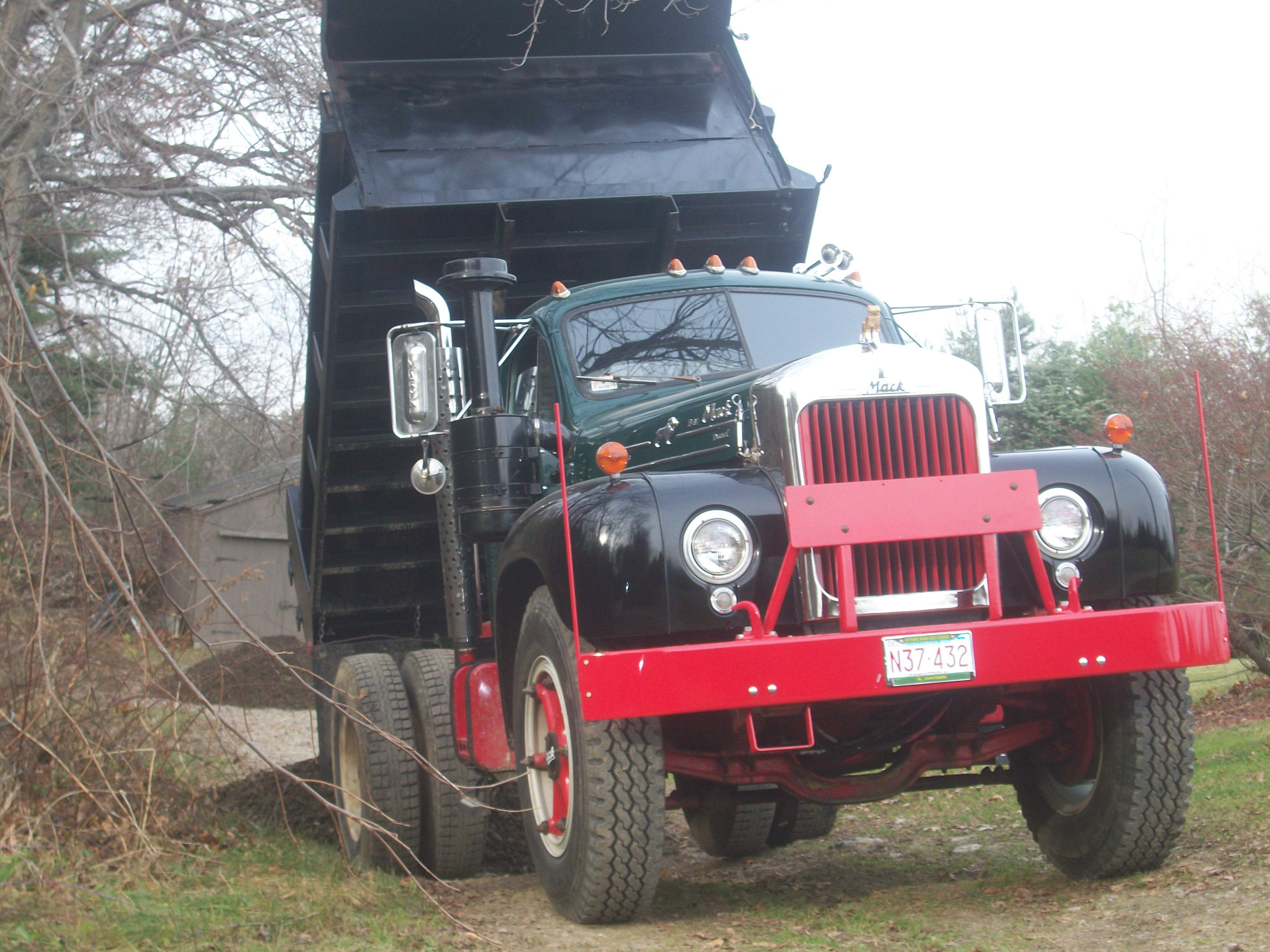

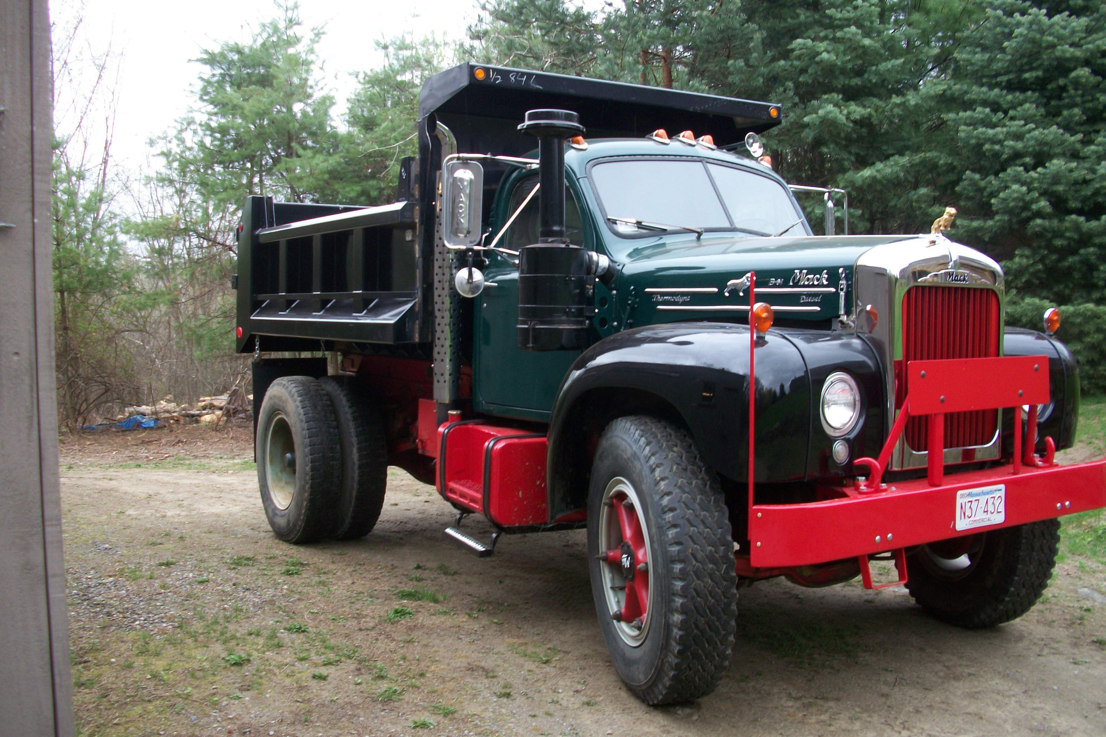

Guys thx!
Ductape -here you go:

WOW!!!... That is a very nice truck!!!:thumbsup:
Thanks for sharing!!!... I want it!!!:D
I didn't know there was an issue mixing LED's with conventional lighting.

Your truck is awesome. Looks great.

That truck is a beauty!

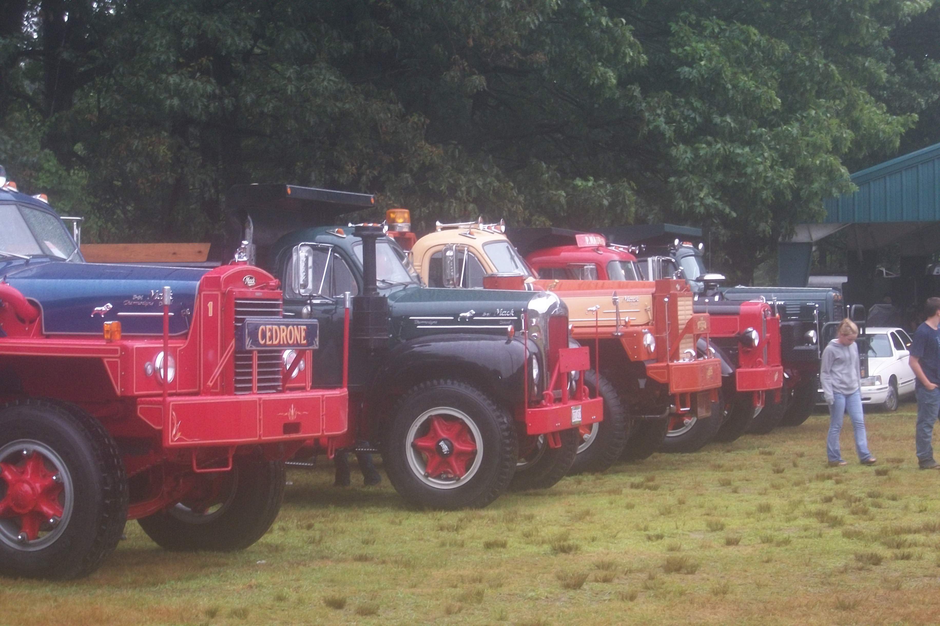

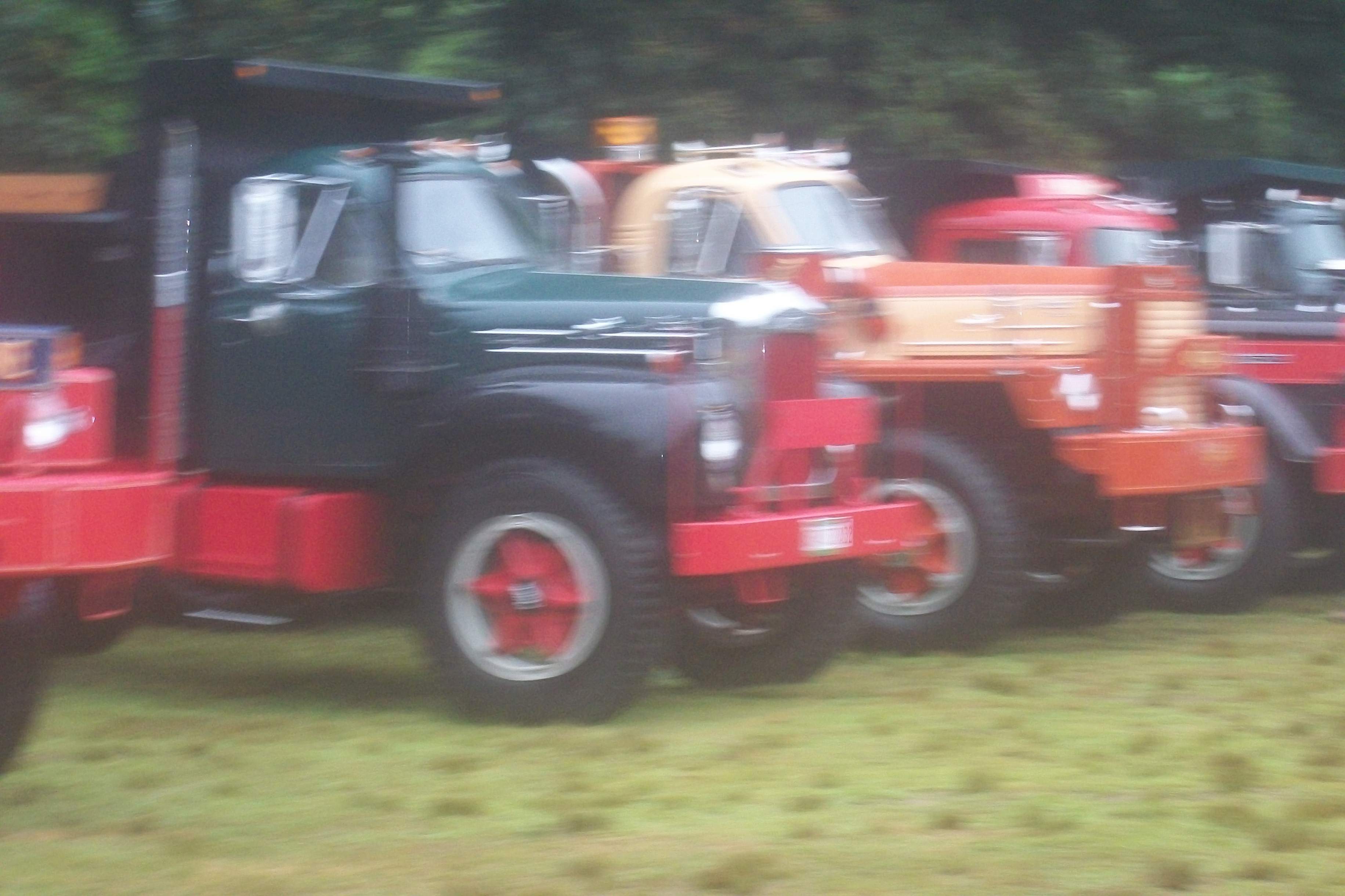

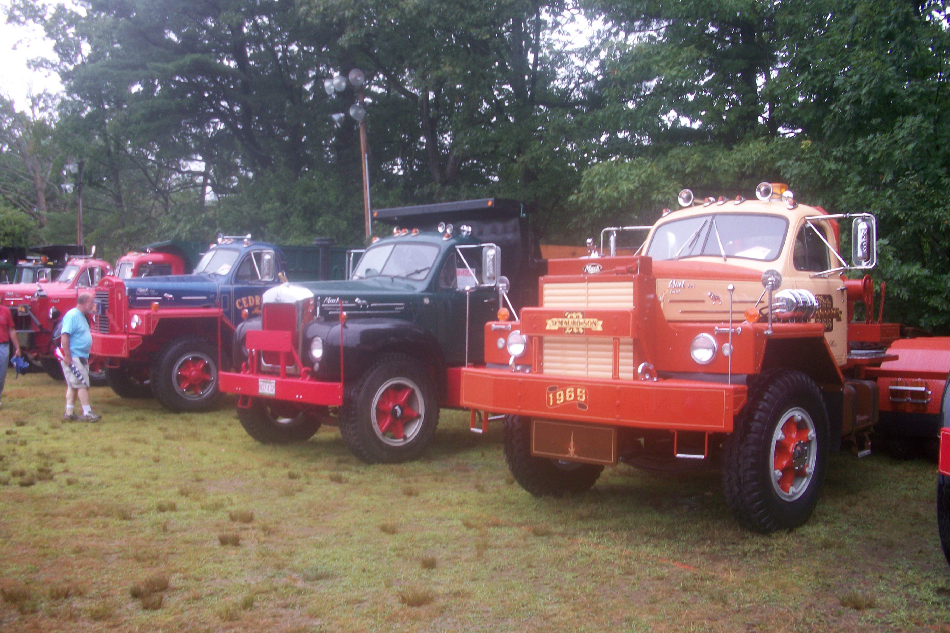

Guys, thx for the compliments-those help when I'm underneath it trying fix something!
Ductape- attached shots at Hudson in 2011. Its between two "show trucks". this old dude does an occasional load! Never been to Barrington but I hear its a great show-just no room. The ATHS National is at the Big E in Springfield this year-May 31, June 1,2. come on down!
