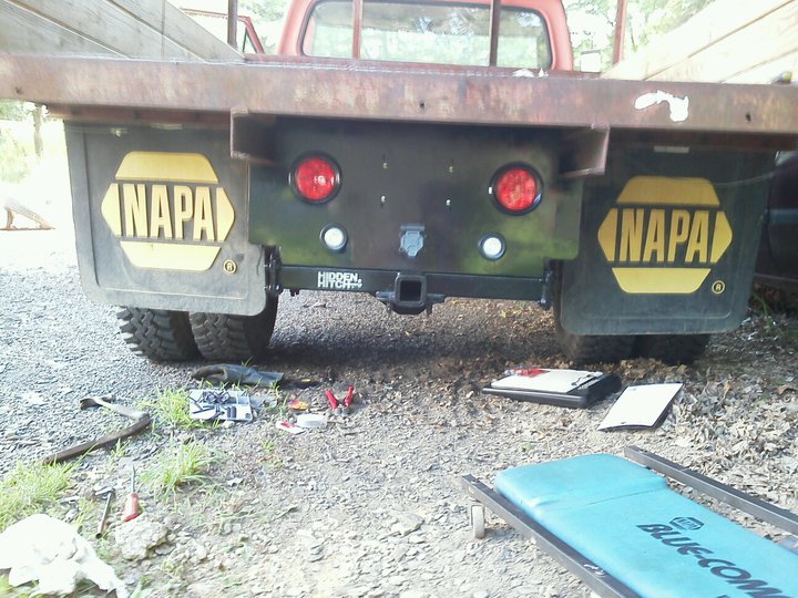

Ive had similar trouble with my 1967 F-350 that I Built a new light panel for. I decided to take my birthday off and do something fun for myself some I treated the old girl to some modern technology ( Removable panel 4 bolts to put it back stock, 7 pin trailer plug, led reverse lamps also, all the wiring I sealed up in a 6 x 6 junction box on the back to keep it clean and dry).
The problem is just as described earlier where might I find the parts to remedy this problem?
Here is a pic of the truck and one of the panel after installation.
