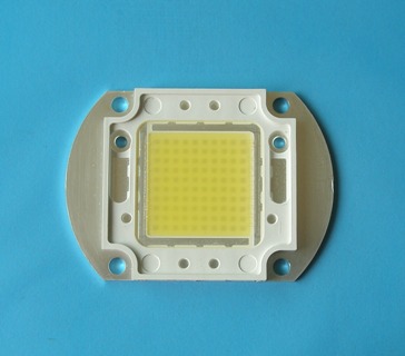

BIG DOOLEY said:
I think i said in one of the early threads mine are flood pattern.
both sets are flood pattern.
there are no reflectors to concentrate the light into a spot.
do yours have some sort of reflector to make the spot beam?
can you post a picture ot the lens front.
<img src="http://www.tractorbynet.com/forums/attachment.php?attachmentid=287198"/>
Tom
You said it on 10/31/12, and apparently heckofaguy didn't see it.
That square panel design with minimal reflector describes some lights I got from LED Warehouse on Amazon.
Very bright, but pure flood without any focus point. I'm thinking about adding shutters to better focus them, like on klieg lights.

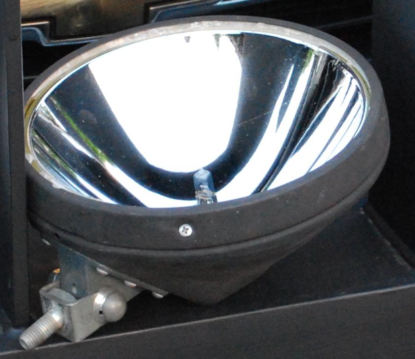

Morning,
Thanks, I would hate to mislead or steer someone down the wrong trail.
Off the topic I have a fresh 28 F morning in Michigan today with some light frost.
Shutters might be a great solution to many peoples debate of which set to purchase.
I doubt that you will get a strong "beam" , but it should have some effect on redirecting light.
I might suggest try using a shutter set that you can move to change from spot to flood.
Heck it would be a simple experiment bench testing off the tractor.
Shutters would also be a great solution to lights mounted directly overhead on the ROPS where too much light is in the face while looking back etc.
My lights are mounted for and aft of the operator station and I do not not have this issue but others have sounded off on the problem before.
Aluminum dryer vent tubing??? or some other reflective material clamped around the perimeter of the light might be a solution.
Experiment with different lenghts and shapes. A visor shape would collect the light trying to go up.
Anyone looking for a spot beam remember this.
A parabolic reflector is what redirects the light into a spot beam. if the lights have no type of reflector is is not going to be a spot light beam.
