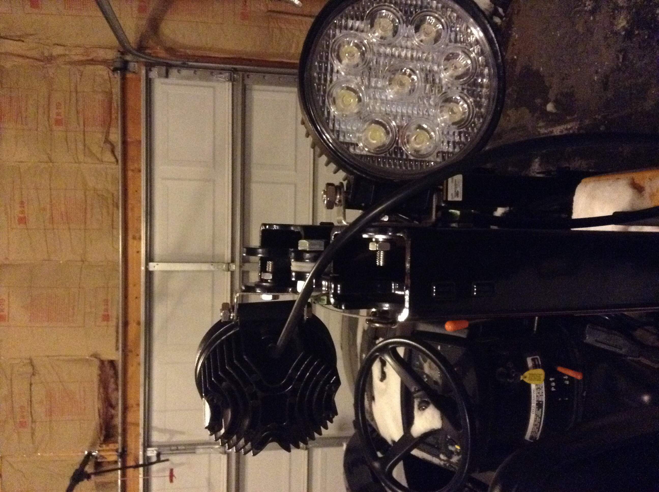

So I ordered a couple 27 watt lights and the opt7 dual harness and received them today. I want to mount them on the rops where the halves hinge together. I want to run the bolt that holds the hinge assembly through the light bracket. It will require me to get a bracket with a larger hole as well as a longer bolt for the rops. Anyone done this? Also, the opt 7 comes with the clips that need to be attached to the wires coming from the light. Anyone know how to do this? Seems simple but I don't wanna screw it up lol

Haven't seen one mounted like you are planning but I'm sure it will work. I think I know what you mean by the clips but pics would help. If they are the clip on wire splices you just put the two wires you want to connect into the clip and close it. Personally I would use butt splices and then shrink wrap over them so they are waterproof.

Got it now. I actually used the same one when I hooked up my light bar. If I remember correctly it came with the automotive style connector that mates with the harness. There are two terminals, the gray shell and a lock. Basically crimp the terminals on the wire, push them into the gray shell from the back. Then insert the orange lock into the front of the connector to lock everything into place. I got the two circuit one and it only came with one connector. I bought another one from Digikey, but I had to call tech support to get all the right pieces.

I was just reading the Opt7 Sw Harness specs.
They are built with 14 gauge wire and include a 30 amp fuse, this sounds good but, 14 gauge wire is rated for 15 amps not 30 amps.
What can happen if there is a shorted condition is the 30 amp fuse won't blow and the wire will melt and then a fire.
I am not sure what the draw for two 27 watt LED Lights is but you need to use a wire sized for the amperage,or a larger gauge than needed and a fuse rated for the components on the circuits.
Think about building your own harness, an easy task and cheaper.
