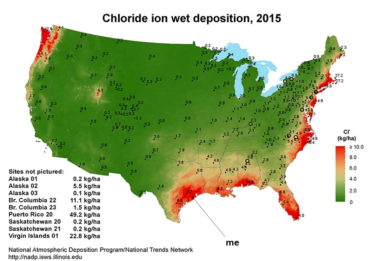

A good one probably 20 years but I’ve seen it happen in a lot less.
This is highly dependent on ambient conditions, I'm learning. To me, parking cylinders exposed is just a big no-no, always has been. Your 20yr estimate (which I can't fathom) combined with other folks seeming unaware of the dangers of spontaneous cylinder corrosion got me curious. Am I crazy? Am I buying subpar equipment? What's the deal? I don't live on the beach or anything. Why do my cylinders rust and not yours?
This is what I found; I had no idea I was living in heavy salt air (I thought it only counts if you can smell it). I thought this was just the nature of the world. Nope just the nature of coastal living.
Studies show salt air affects metals more than 50 miles inland
