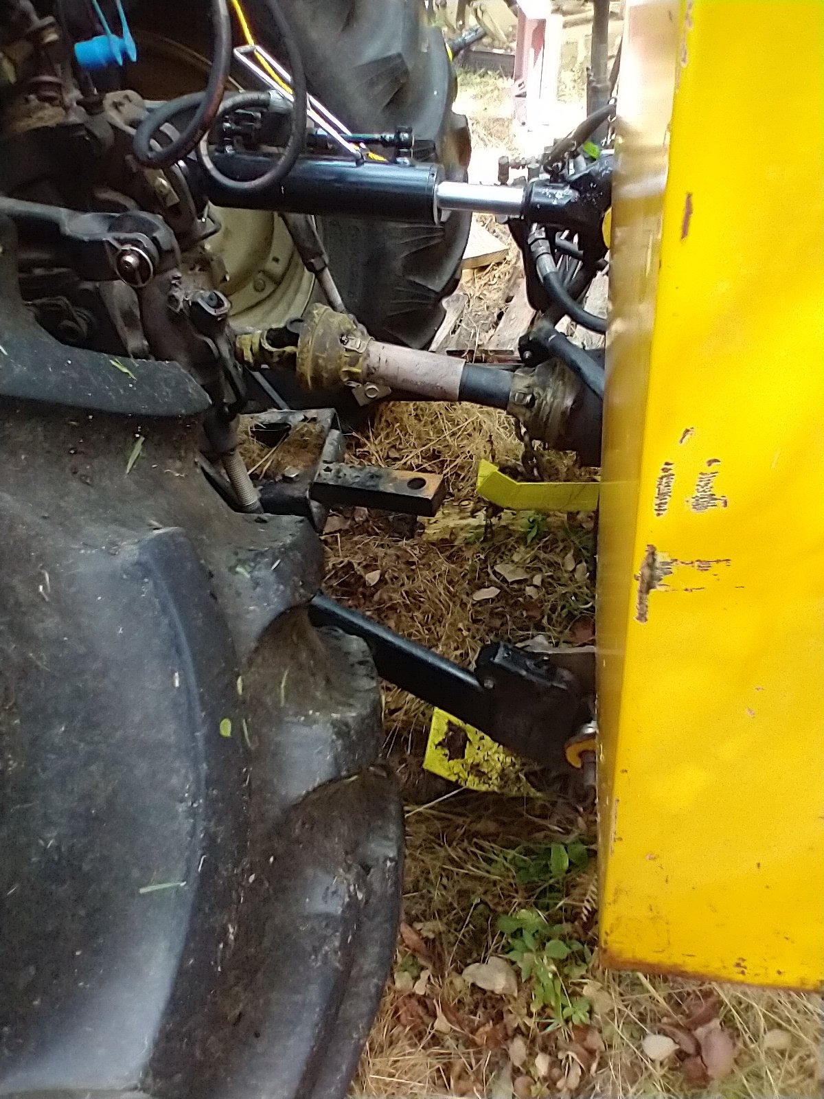

My problem isn't with the arms or top link. That's easy peasy.
It's getting between the wheels and implement to attack the pto shaft.
I'm 5'11", or used to be :LOL:, but my arms are too short to reach all the way over.
Not all implements, but the mower is the big pain with it's frame to allow it to side shift.

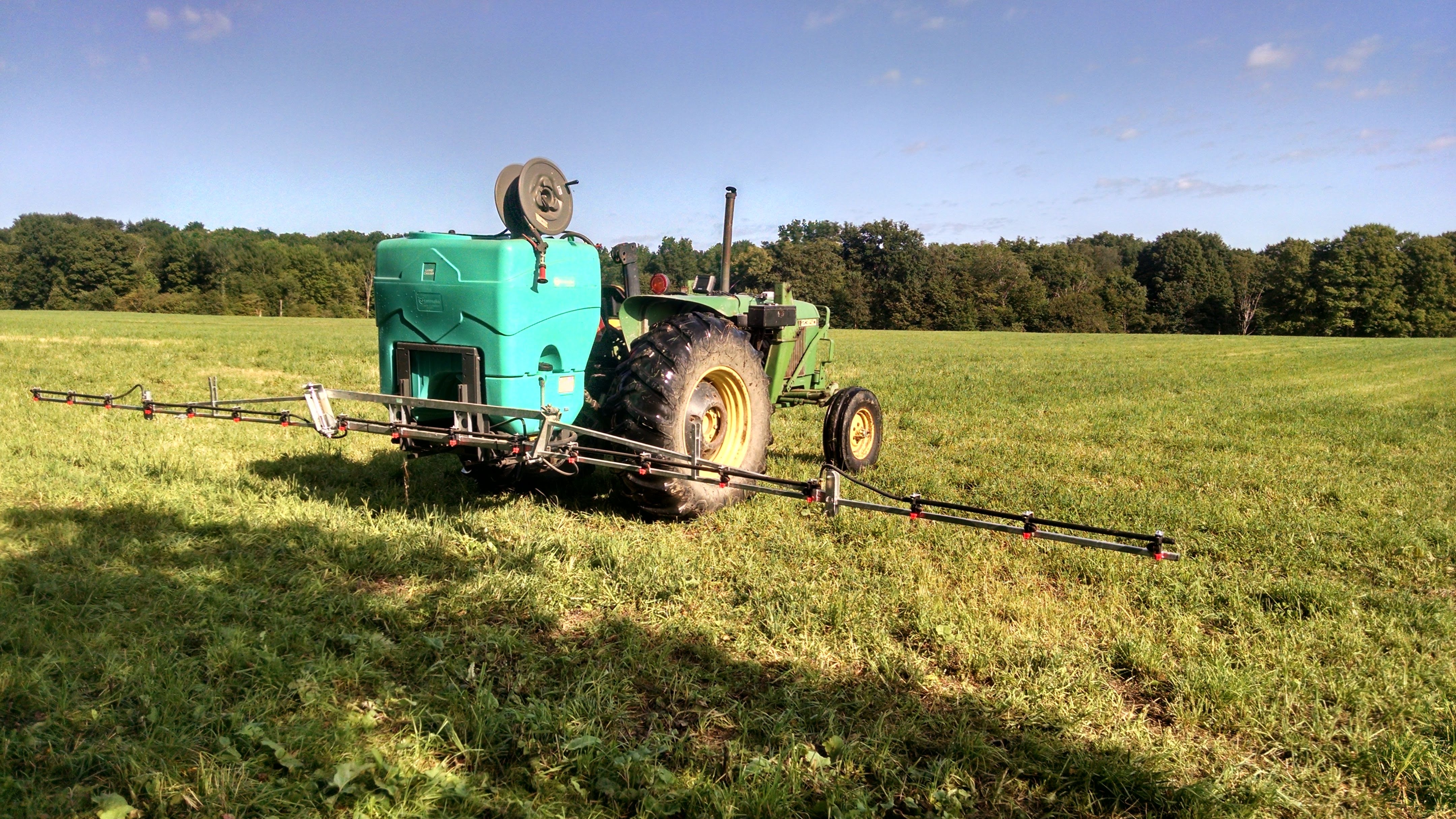

It can be tight. But really like the sprayer.
So it appears the pump is mounted on the frame of the sprayer. My pump slides on the PTO shaft so I can slide my pump on before I hook it up. Also mine has a quick hitch, which sits the implement back about 4 inches. That makes a huge difference. And lastly, take that PTO guard off and throw in in the scrap metal bin. That's an interesting looking sprayer. Never seen one of those. BTW, with a QH and a hydraulic top link most of your problems go away.
I just saw you are an Aussie. That explains the sprayer.
You can go buy one tomorrow if you want to. They are not specific to Australia.

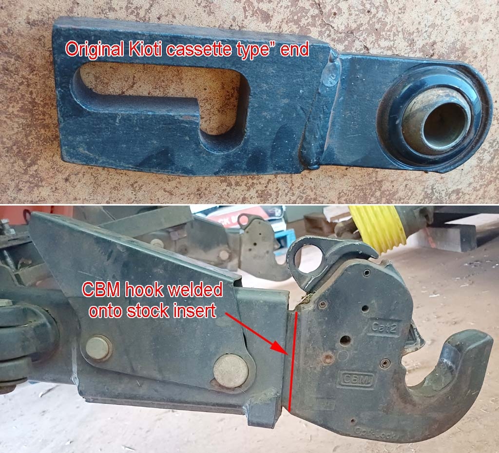

When I bought the Kioti, all my implements had the Euro style balls, so I modified the OEM 3PL lower ends, by removing the originals (top of pic), buying a pair of CBM hooks and welding them onto stock bar. They're secured in fixed position with that big pin through a hole in the bar, and not bothering with the slot (which would have been a PITA to do).
Two caveats - ensure the welds are V'eed adequately, and duplicate the angles of the original ends.
Nice! That's basically a 'Pats Quik Hitch' design.
The Pat's is a copy of the "Euro" hooks. The "Euro" hooks have a ball on the pins that allows some twisting and misalignment when being worked. These hooked lower and even top links used to be found on some Olivers and Fords back in the 60's then they fell out of flavor with the US for some reason

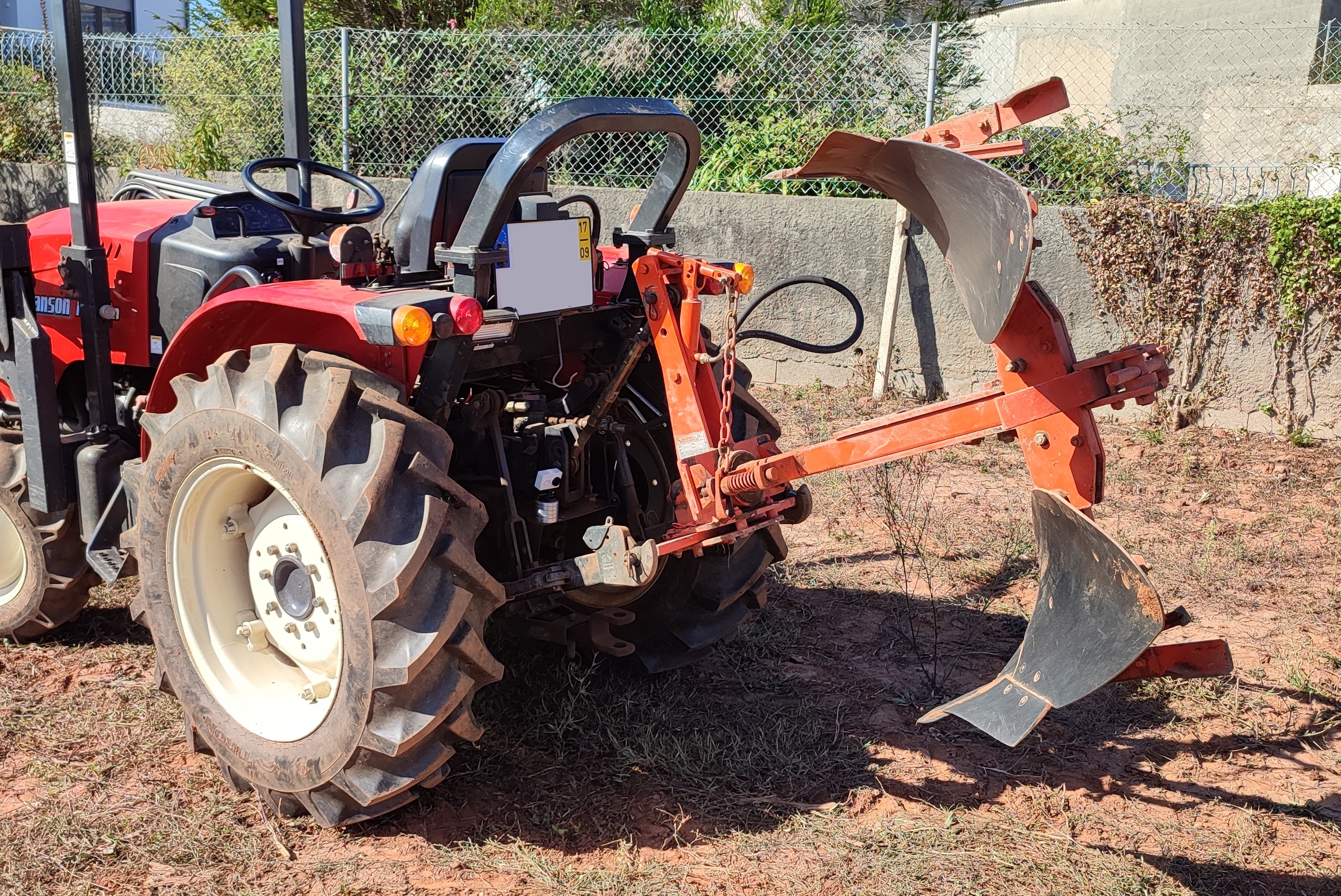

For the Branson, I really have no bad one. It comes with the Euro lower links as standard, so it's pretty much a trouble free operation. No frames in the way of hooking up PTO shafts either.
I sure could have some fun if I had a plow like yours. (y)
