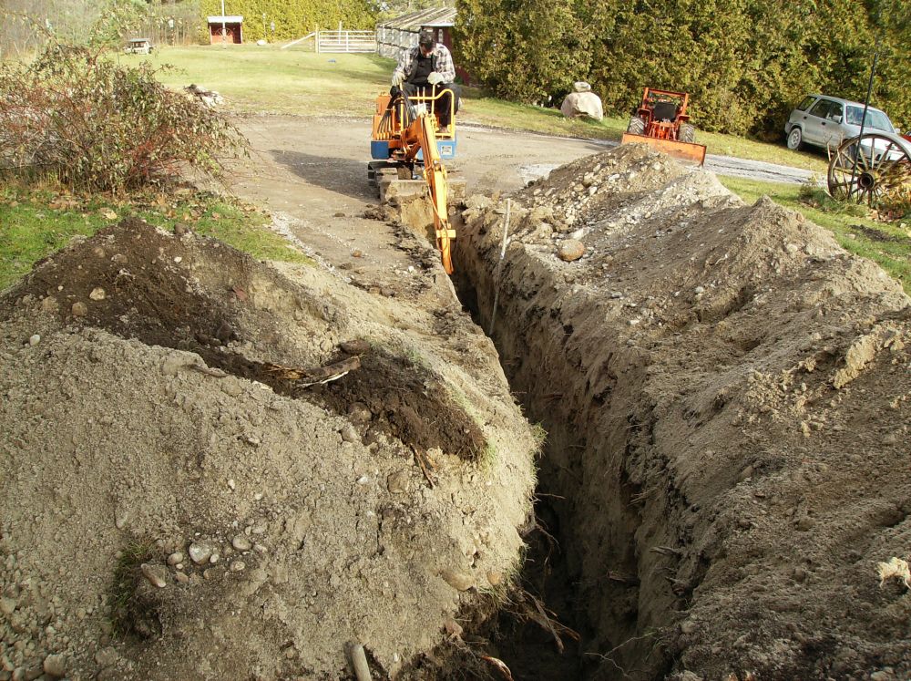

I just did a trench like yours last fall. We went about 5 feet deep and I layed styrofoam over the waterline too when we backfilled as it went under the laneway and I was worried about frost being "driven down".
I hired a man with a mini hoe and he had the whole trench dug in less than 1/2 a day (and my soil is sand and gravel so the trench sides kept caving in slowing us down and the trench wound up being way wider than necessary). I used the tractor to fill it in. I have a BH for the tractor now and there is no way I could match his skill even today when I'm pretty familiar with the hoe.
I really suggest pricing a hired man vs doing it yourself. I paid him only about $50 more than the cost of renting a mini hoe. As for the hand dug at the end, if he's good he'll get you way close and it will be a minor hand dig at the end.
