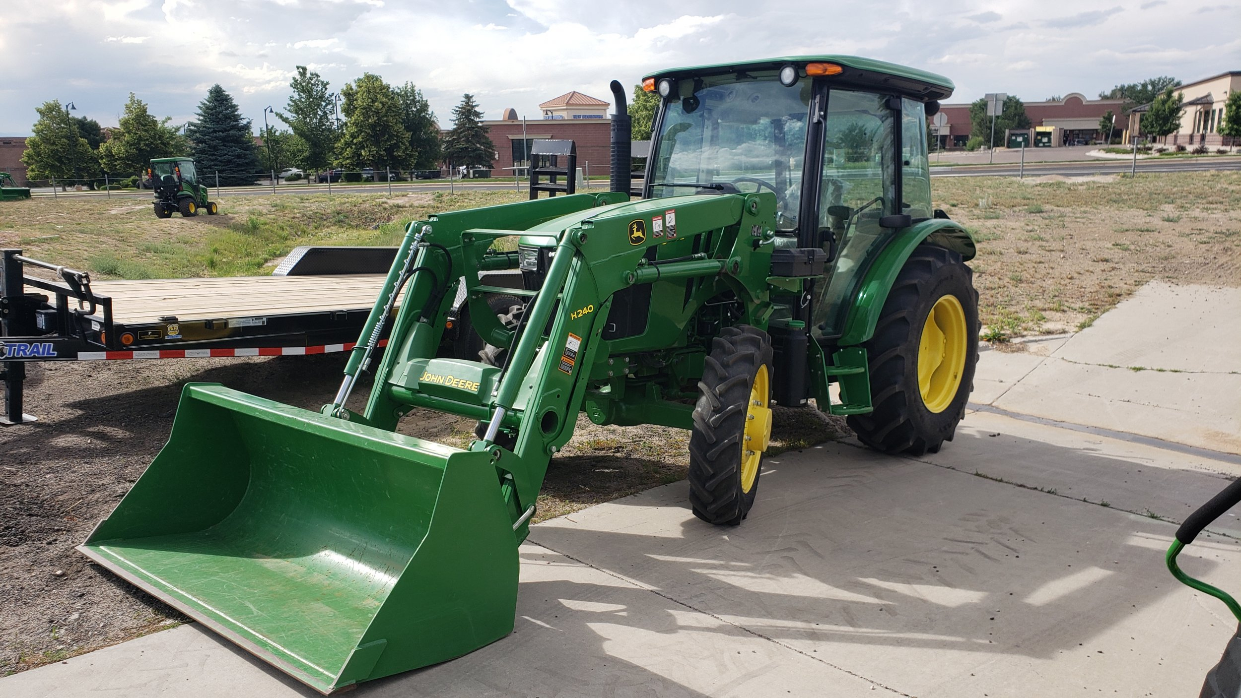

Well, I did it. It's a 2017 5055e with about 150 hrs. It seems really clean and lightly used. I'll have to get used to running a loader from inside of a cab, but brush hogging and snow removal will be really nice. It is the global loader attachment. It has a bucket and a bale spear. I have to decide whether to get a set of forks or an adapter to use my old set.
I save a bunch of sales tax having it delivered at home, but it's going to be next week. Patience is tough once I've made a decision.
