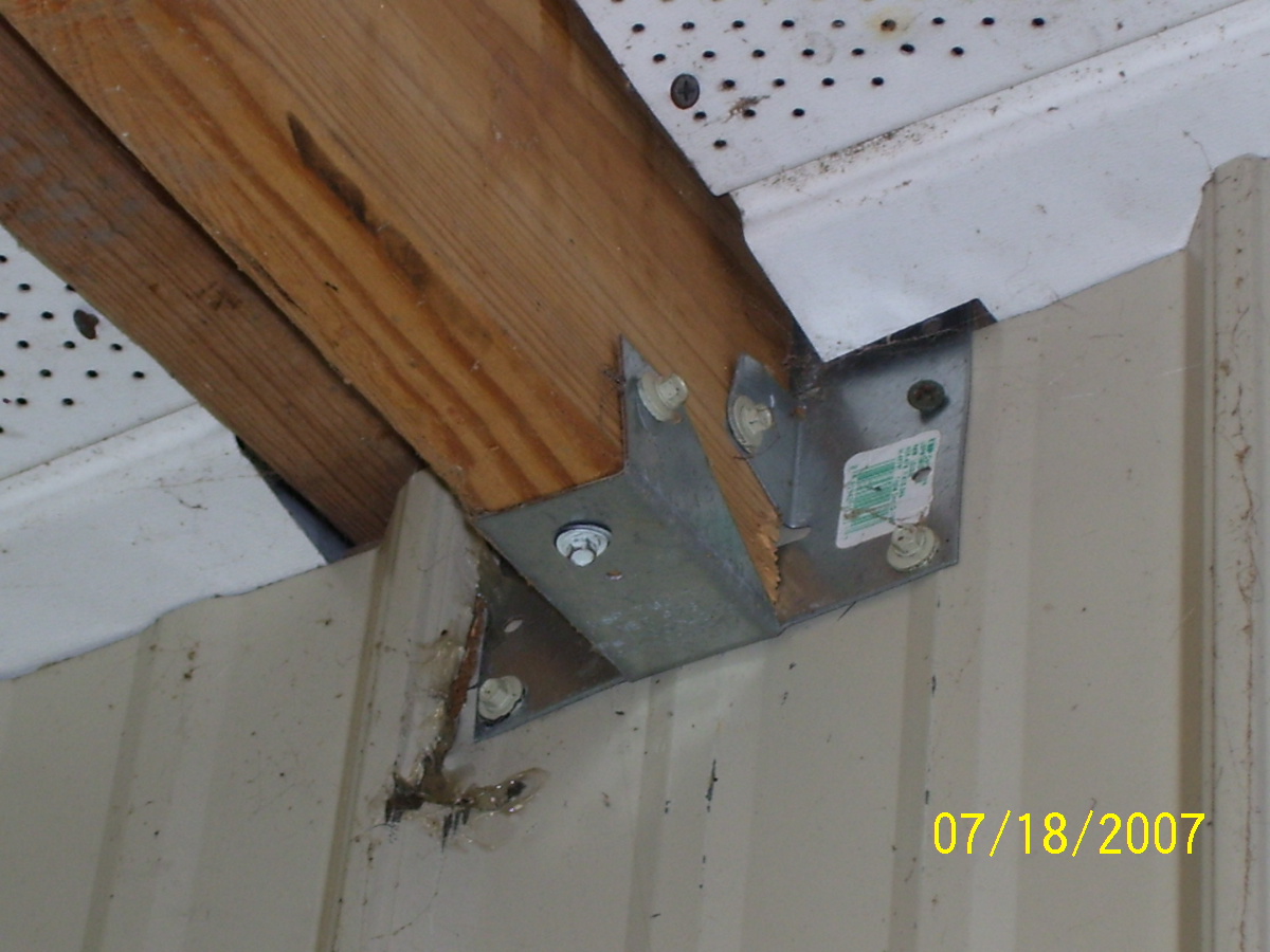

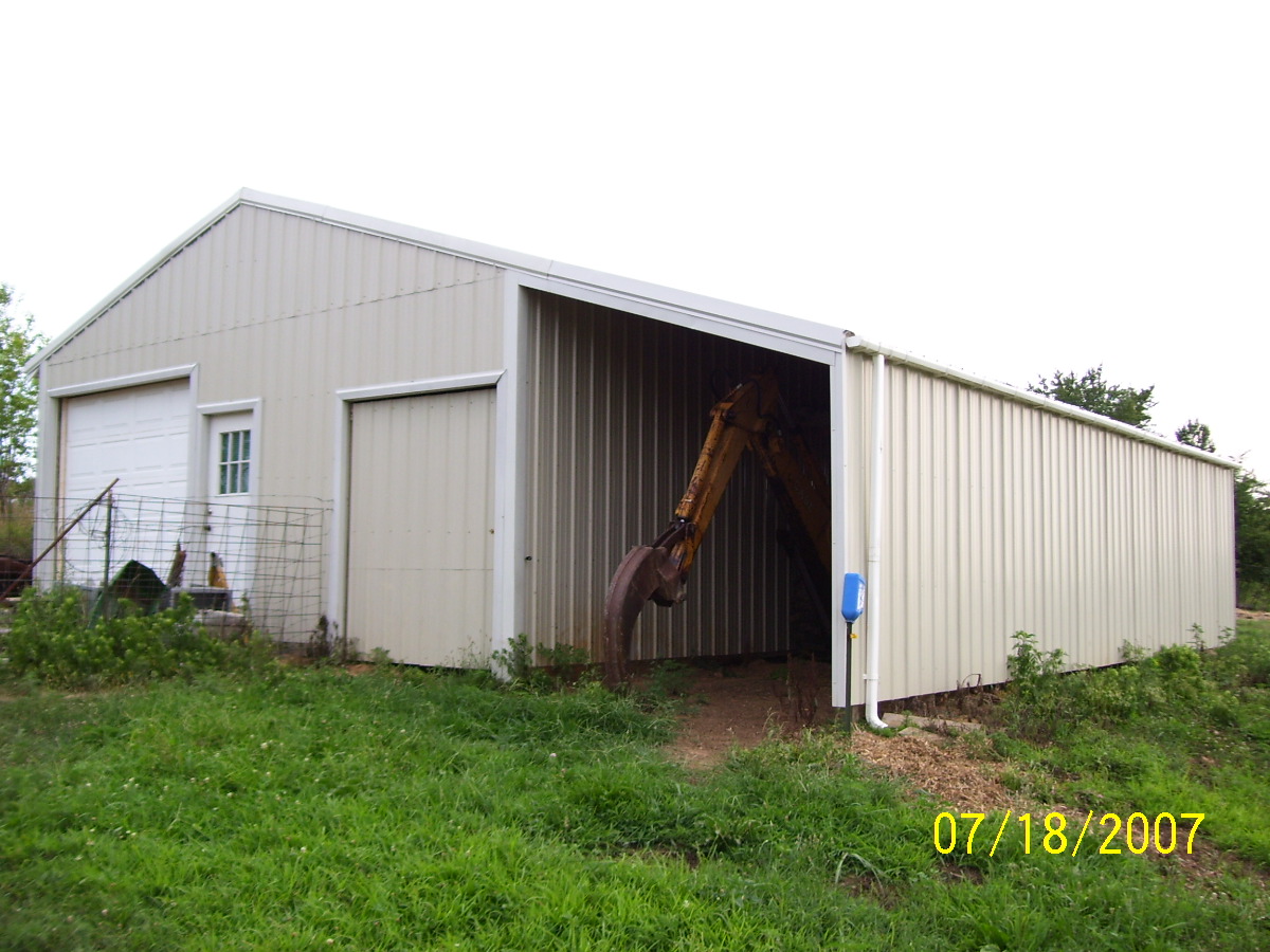

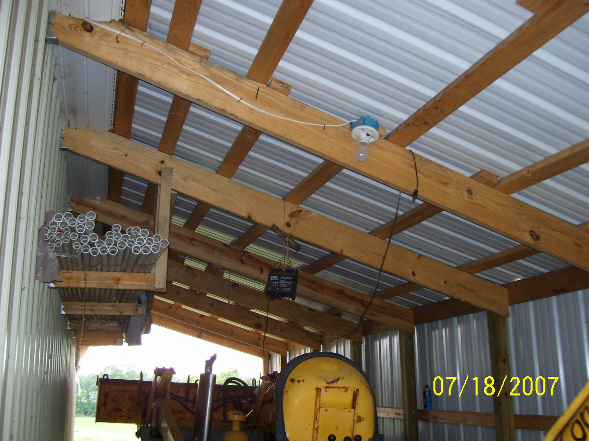

I added this 10 ft leanto to my 24X36 pole barn last summer.
I used 4X4 treated posts on 4 ft centers. The rafters are 2X8 and the 2X4 roof battens are 20 inches apart. The 2X4 wall battens are 30 inches apart.
Since lean to's can get significant uplift wind forces during a storm, here is a special lift resistant metal bracket (see pic) that I used to screw many of the the rafters into the header and down into the 6x6 treated posts underneath (they are also on 4 ft centers). The original pole barn had a 1 foot overhang so that made things a little easier to get the roof metal lined up and overlapped correctly. I put soffit up to keep the birds out of the barn.
I did it all myself except for my wife helping me to hold the wall metal up while I attached it. I didn't even need to use a loader for the framing, I just parked a hay wagon under the area I was working on.
I only wish I would have gone with 12 ft instead of 10 feet wide. You should go with 2X10 rafters since you probably get plenty of snow.
