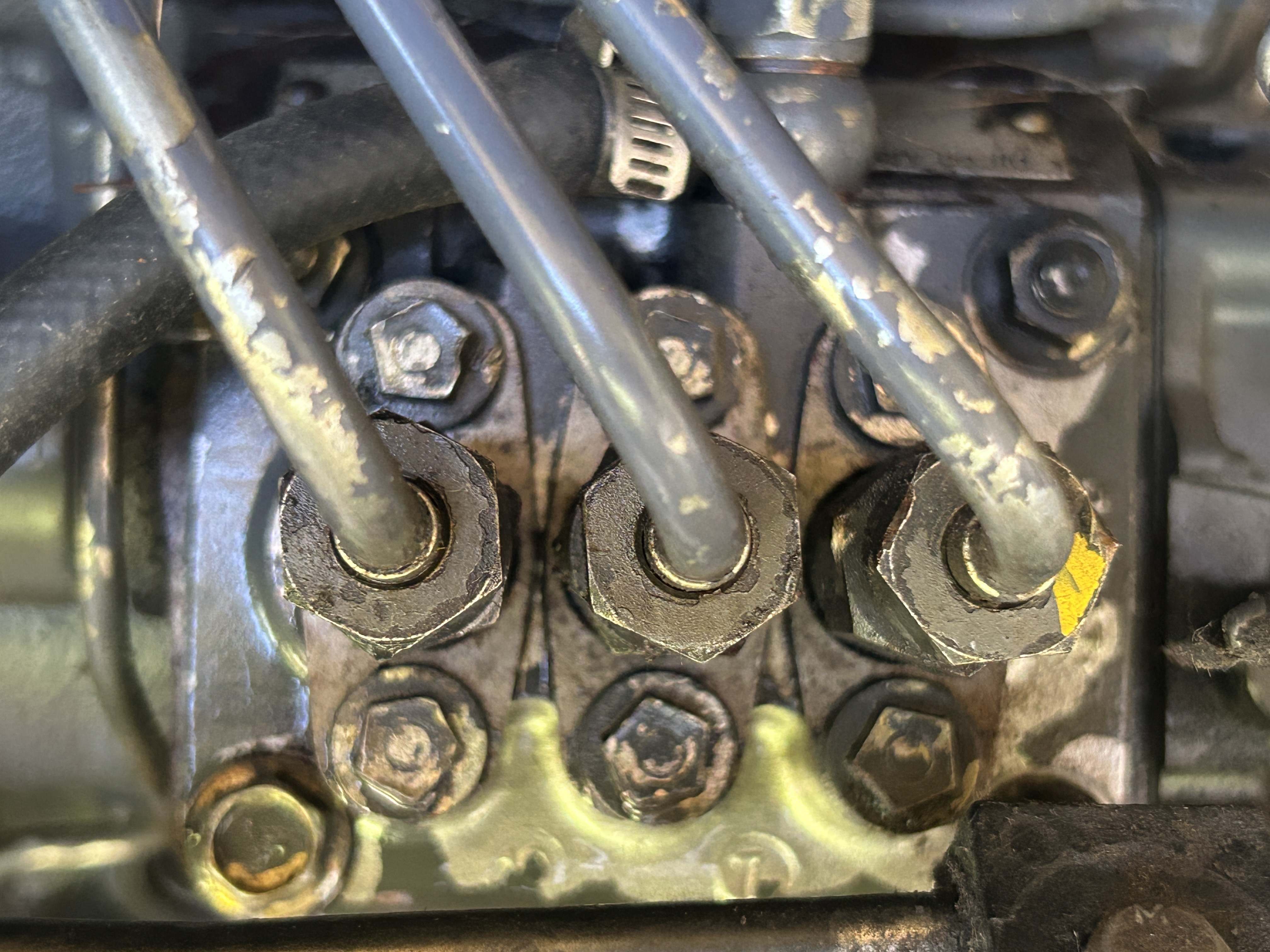

I have a New Holland TC29 with an annoying leaking fuel injector pump that I am dealing with and am wondering if you can help me with it.
Thx,
Danny Harris
Conway, AR

Yes Danny, no problem at all, I keep the parts in-stock..
Reach out directly at:
My actual screen name ataoldotcom..
