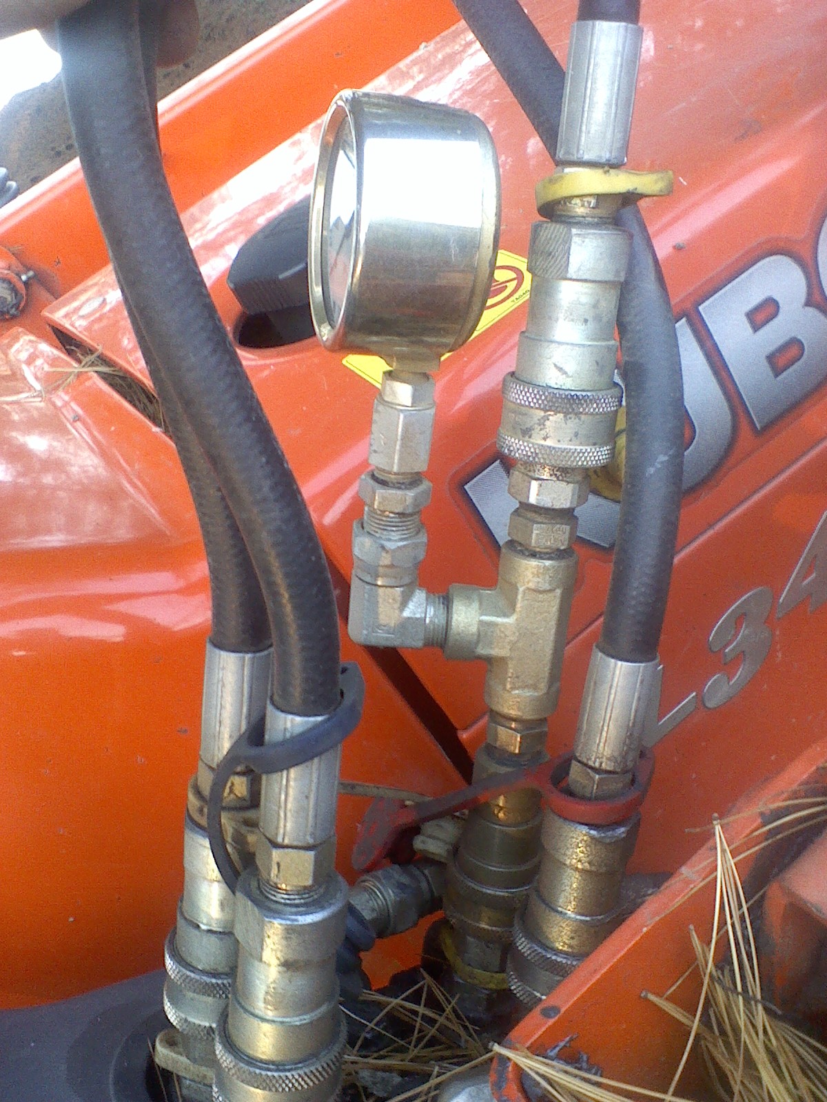

Well I finally borrowed a good gauge and checked all my ports at the loader quick connects. All four at 2500! So I guess my pump is good? My valves are good? Which gets me back to my original concern. First, my loader arms would drop overnight-my thought I had a packing issue. Arlen's test with the complete disconnect proved that to not be the case.
Second issue. I was of the belief that I was not hitting the 400x's rated lifting capacity. I based this on the fact that I could not get a structure I was told weighed 1200 pds more than 18" off the ground. Perhaps that "1200" pound assembly wasn't 1200 after all.
Next step will be to see just what I can lift using various granite pieces I have (assuming 168 pds/cu. ft.)

I am guessing that your 1200# structure might weigh a bit more.
Even with complete disconnect of the loader, The packing can still be bad.

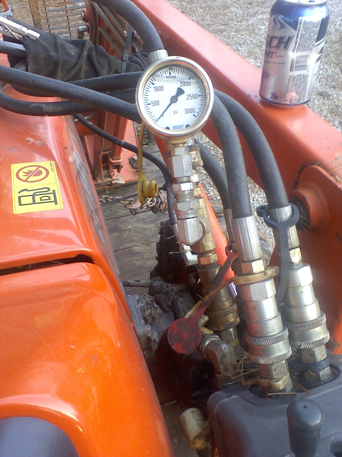

If you want real piece of mind, get a good 3000psi gauge, a few quick connects, and TEE it in inline with the lift port. I did this on my kubota. With a little math you can even get a rough estimate of what stuff weighs. Or get a good idea if you got a "good" scoop of dirt or not.
View attachment 391083View attachment 391084
Thx LD- I hear you on the gauge/"T". I think I'll try the granite blocks first. Just out of curiosity, how can you figure material weight using gauge? Guess says if pump is rated at 2500, and you are moving load with reading of say 1300, load is 1200???

Using the gauge is still strictly a guess. Cause the same weight, only situated farther forward, is going to be a different pressure reading.
But I have done some calculations on the geometry of the loader, cylinder size, as well as real world testing. And have figured that 1psi is pretty close to 1# for a load at the center of the bucket. (like a load of dirt/sand/gravel).
It reads ~600PSI with nothing in the bucket. So at 1600PSI, I am lifting roughly 1000lbs.
Again, its just an estimate. Using a bucket tooth or two for a strap to hoist something shifts that load forward, and it isnt 1:1 anymore. More like 1psi will only lift 0.8# or so.
