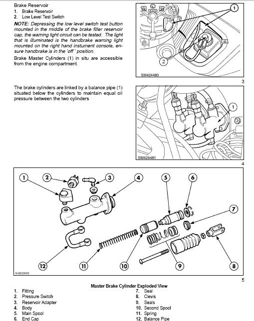

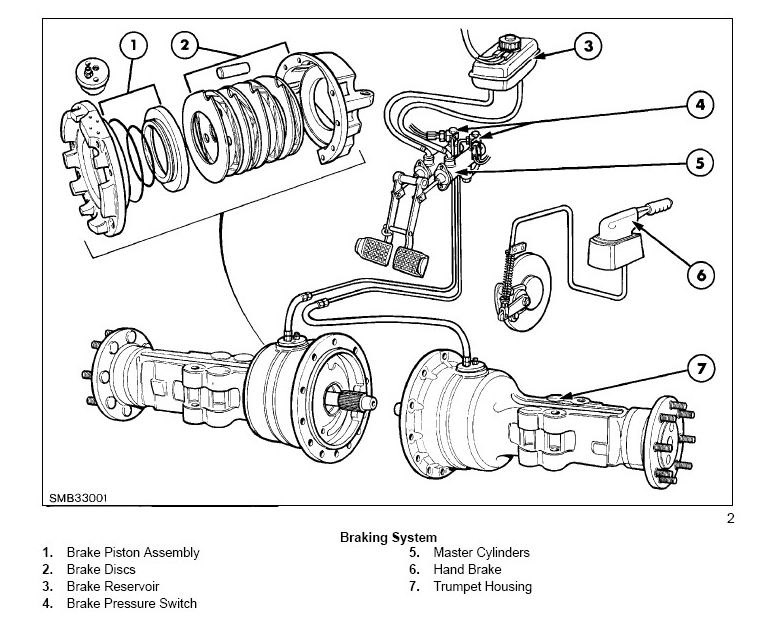

The attachments are details of the brake system from the Maintenance Manual. Actual photos will follow when I start the repair.

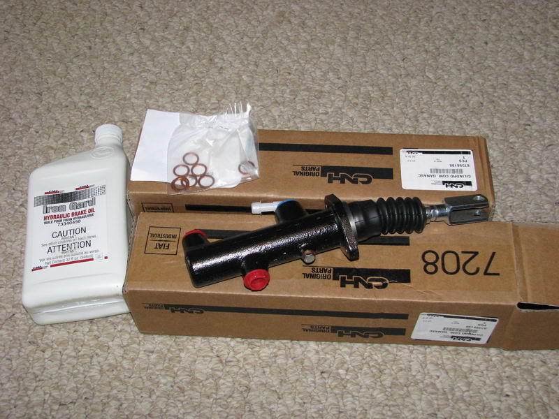

I'm $632 lighter,:( but I now have my parts, new copper washers, and two quarts of mineral oil brake fluid.:thumbsup:

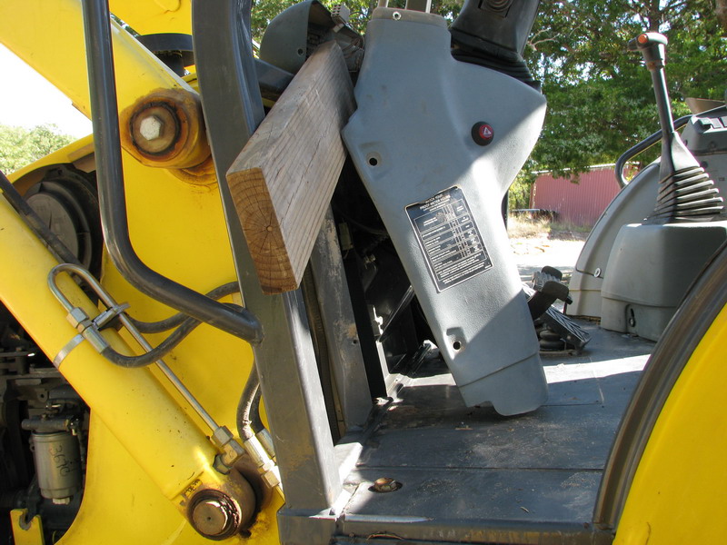

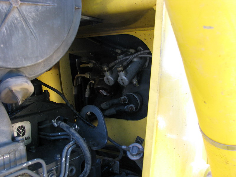

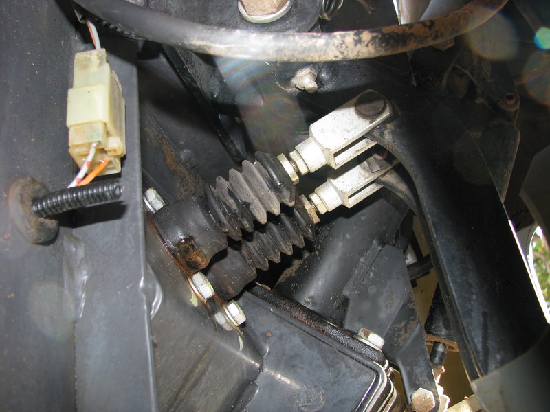

Today, the weather is perfect, so I decided to tackle my brake job on my TLB. The first thing I did was to spray both the pedal area and the master cylinder area with purple cleaner and let it sit a few minutes before cleaning off all that slimy residue of mineral oil, dust, and dirt. The results were amazing. Looking at my photos, you'd never know the brake cylinders are leaking. I also removed the screws on the cowling under the steering wheel so I could pull it back and work from the side instead of having to lay on the operator's platform and work up through the brake pedal cutout. The photos below show removal.
In the photos of the brake pedals, notice the grease zerks. You couldn't see these until I cleaned the area. I don't think they've been greased since the tractor was new. The right pedal was so stiff that it would stick anywhere you put it. After a bit of work I got both zerks to take grease and the pedals work perfectly now.

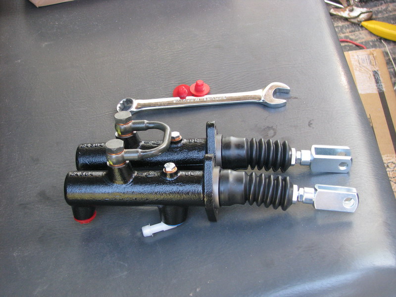

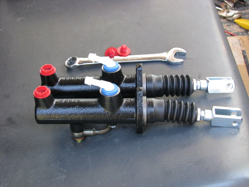

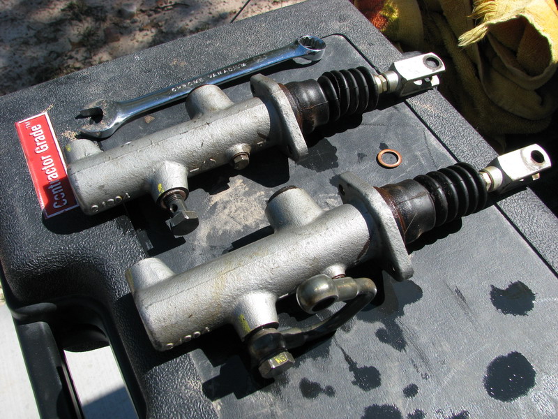

So, I took the crossover tube off of the old master cylinders and installed it onto the new master cylinders using four new copper washers. The tech at my dealer told me that I should install the crossover tube before putting the master cylinders back into the tractor because it would make the job much easier getting the cylinders in place and aligned. He said finger tight only unti the Master cylinders were bolted into place. Also, the plastic hose adapters from the reservoir are a pain to get out of the old hoses, so I pulled the new ones and just left the old adapters there and inserted them into the new cylinders.
Everything is back together now and I'm just awaiting my wife's return from the store to help me with brake bleeding. I sure hope this takes care of my problems with leaks. Keep your fingers crossed for me.:)

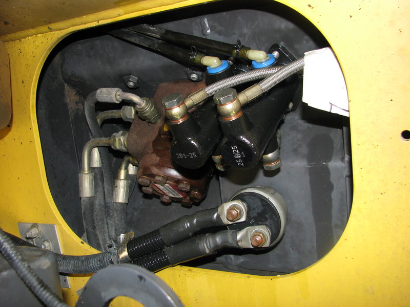

Let me add one other bit of info for anyone who might do this job. In the photo below and just below the brake master cylinders, there is a round object with two huge wires and lugs. This is the battery disconnect switch. If you don't disconnect your batteries right at the battery terminals, this switch stays hot and you MUST be very careful not to short either of those terminals to ground or you will be in for a huge spark and a welding lesson. This switch carries the power from two 12 volt batteries.

More surprises. Your machine has two batteries. I have one. My disconnect is next to my fuel filter, on the side of my engine block. Yours is in a much easier location to get to!!!!

Kyle, had I noticed these cylinders were Bosch, I might have checked around and found rebuild kits, but I'd bet that the full kits would have been $100 each and maybe not included the rubber boots and proper pedal hookups. My rubber boots were gone too. If I spent over $100 per cylinder on rebuild kits, I still have to remove the cylinders and also maybe hone the bores. In the end, I'd have lots of time and parts involved in a repair with no guarantees the parts will work. $305 per cylinder is a bunch, but the repair was a breeze. If I had to pay for 2-way transportation, labor, and parts this would have been a very expensive repair, maybe close to $1000. So buying the new parts seemed to make sense to me for ease and overall cost. I sure can't complain about shipment time on the parts either. I ordered them on Wednesday afternoon and they were at the dealer by Friday morning. Everything bolted up and fit perfectly with no anxiety. That's worth a bunch.:)
