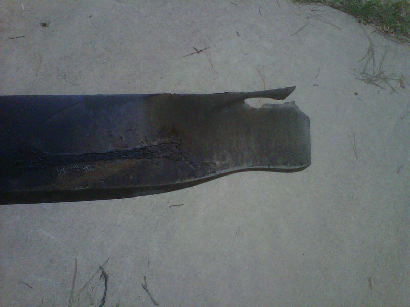

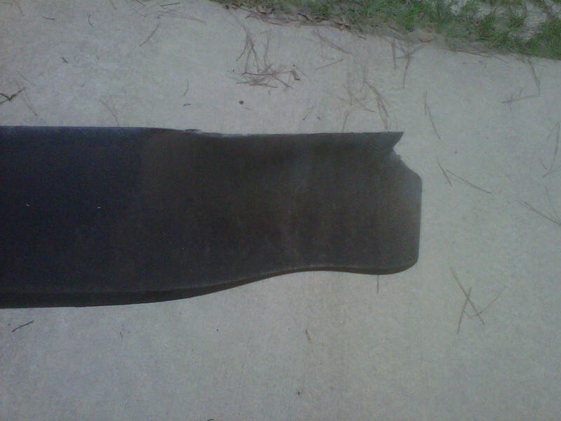

I dunno about mulching, its a standard Hustler Fastrak 54" mower. Nothing fancy. Only cut about 30 hours this season and they are toast.

pics of my blade ends

Mower blades have become a big liability. Think about it - how much would it cost to buy the steel, form it, heat treat it, and grind it if you wee doing them by the thousands. The actual cost of the blade is negligible compared to the cost of the insurance. Lawn mowers used to have blades that were fully hardened at the tips but these are brittle if you hit a rock or something. Consequently blade manufacturers have taken to hardening just the cutting edge so you can only get 2-3 light sharpenings and stay in the hardened zone. The trick is to re-harden these edges as you grind them back. It is really quite simple if you have an Oxy-acetylene torch. Just heat the edge of the blade up until it is a dull cherry red color and dunk it in water. The rest of the blade will not get hardened as long as you heat only the edge and do it quickly. If you heat it too slowly you get the rest of the blade hot and then you can create a brittleness situation.
Steel basically does not harden unless it gets hot enough to be in the red range. There is no reason not to use a grinder on a blade as long as you keep it moving. You should not let the blade get red and keep cooling it while you are sharpening by dunking it in water a time or two. you can tell if the blade is hard if the grinder is putting out little sparks. If it is putting out big sparks the blade is soft.

Why on earth would you replace a blade that looks like new? A quick touch up on the edge and it would be ready for mowing. Heck they arent even dull enough to require sharpening yet. At over $20 per blade for my mower (x3) I use it till it wears out the lift tabs.
