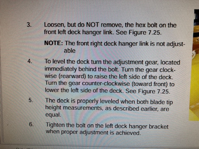

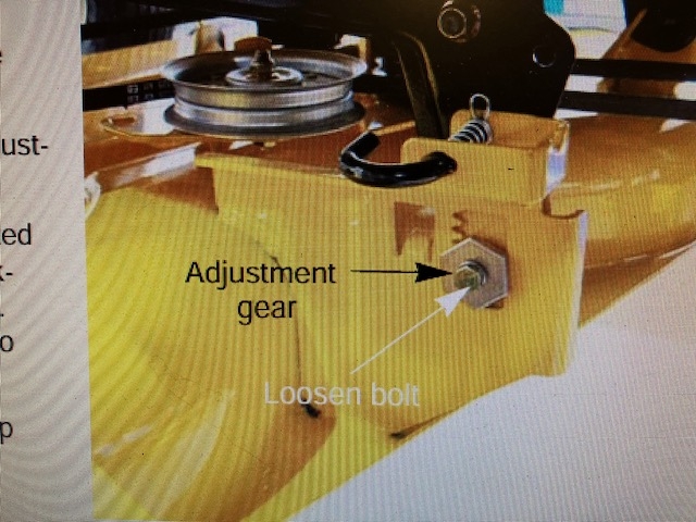

Mine is a Cub Cadet zero turn and was doing the same thing. It wound up that this adjustment gear had worked loose and fell out. I had to get another one. See the photos - it could be something along these lines
