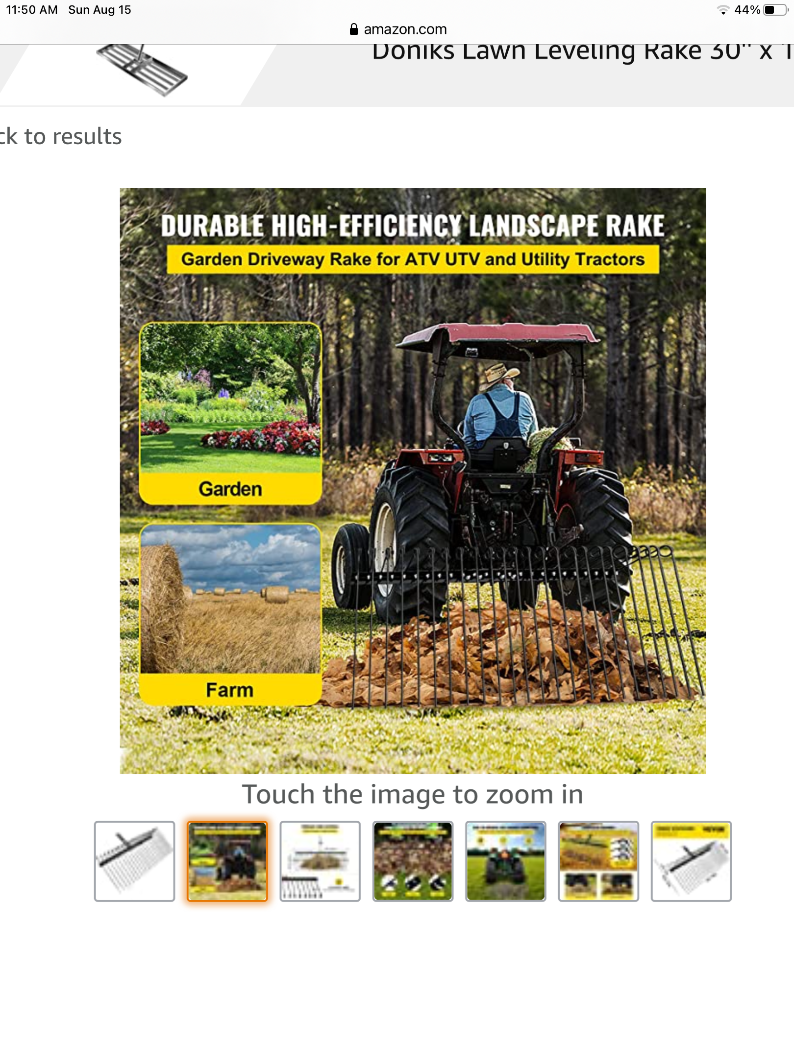

The different pictures at the bottom make it look like an odd 3pt implement. In one it appears they have it on a 3pt trailer mover. It doesn't look to be actually attached to any of the tractors, just photo shopped in behind them.
How could it work with an ATV as well? I don't think it actually has a true 3pt connection. I hope it works for you, but I would be very leery of it.

Alright. Sorry for the delay. I received this a week ago, but only now had a chance to put it together.
The thing is very light duty. Like Craftsman mower type duty, as you can see in the pics. For the cost and intended application, I guess it could be made to do, but don't expect it to last very long.
The angle iron is 2" x 2" x 3/16" and the hardware supplied is metric 4.8.
The link holes are suppose to be 5/8", but were actually 15mm so needed to be reamed out with a proper 5/8" drill. Also, the bottom holes are not extended enough to fit my lift arms. I guess these are the 'modifications' talked about on Amazon.
A QH will not work due to the top link being so high. Even trying to use the brace instead, things just don't line up.
