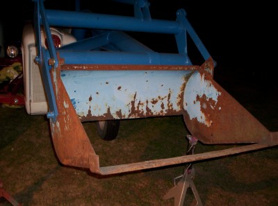

I got some more 90' angle adapters today and re-routed 2 of my hyds hoses that were in the way of my brake and clutch pedals.. with the new adapters, the hoses lay almost perfect.
I did have to make a 'standoff' out of a piece of 1" x 1/8" flat stock, drilled with a 3/8 hole at one end which I mounted under a tranny cover bolt, on the left front of the tranny. I also drilled 2 smaller holes near the end o fthe stock so i coul lay a hyd hose across it then use a zip tie to hold it. This keeps the hose for the big SA lift cyl from rubbing the gear shifter.. looks pretty decent.
I also had time to cut the rotten floor out o fthe bucket. I ende dup cutting a 36" piece out ( bucket is 39.5" wide.. so my piece to stitch in is about 37" x 39.5" )
I'm looking forward to that on friday morning perhaps.
I don't have a big torch bottle set ( just small ones ).. so i used a 4" angle grinder. i was prepaired for a long haul.. but it pretty much cut the rusty 1/8? metal like butter.
Took 2 4" 'cutting' blades, and about an hour to cut the floor out, plus the 2 brace strips and angle across the bottom of the bucket.
slowly but surely she is coming along.
I think i have the hyd leak at the unused 'drop' port on the valve fixed. i had originally used a short 9/16 bolt and oring to plug the port.. but it tended to dribble.. so i got a real 3/8 orb fitting for it with a male jic nipple, and jic cap.. so leak should be gone now.

I got up early this am and went and got some bales of hay for my horses. i normally get 700-850# coastal bales.. but we had some tifton 85 come in.. and were around 1000-1200# and only 4$ more. I decided to try my luck with them
After I got home I remembered that my loader only lifts a max of 1200 or 1300 #.. so i got kinda worried. The 700-850# bales seemd bad enough.
Well.. the old 660 lifted it... grunted hard and nearly flattened the fronts.. but lifted it so i could drive the trailer out from under it, then just drop it on the ground .. I'm very impressed by these 1-arm loades.
After that i cleaned up the bucket a bit with the grinder so i had all good clean metal edges in prep for welding in the new floor.
I spot welded the metal floor to the back of the bucket, and then used ratchet straps to curl the metal down along the contour of the bucket sides. I then used a hi-ligt jack and a piece of timber to get the metal edges smooth and flat, and then spot welded every 6" or so.
Had to go to work after that, but as it stands.. the new floor is spot welded in.
I used my 70a arc welder and some 6011 1/16 rod for the spot welding as I was out int he barn close to my tools doing this ( no 220 at barn...welder plug is in garage. ). This weekend I'll pull the tractor up tot he garage and buzz the floor in with soemthing that looks good.. like 7018ac or 6013 on a 3/32 rod and my big hobart arc welder.

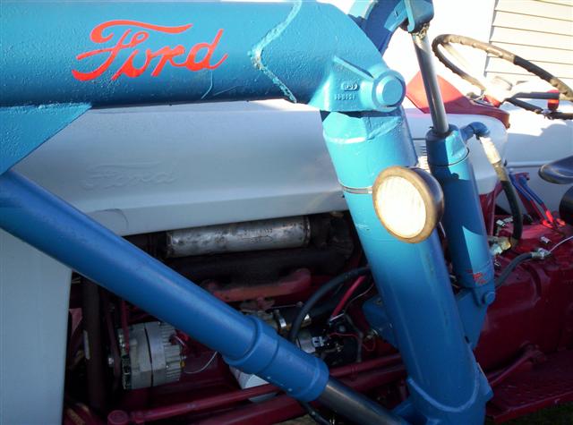

Well today i got the right headlamp installed, along with a left ? uh head/work lamps, and a rear fender work lamp.
The 711 loader frame blocks the normal left headlamp location, so I mounte dthe left lamp on my loader itself, similar to what I did on my 660. ( On my 660 I mounted the lamp to the holder that used to hold the hyd filter for a 722 loader. ) the 711 has no such bracket, so I did some creative bracketry ( read: cheap ) and came up with this... It's a large band clamp around the loader frame support, and holds the lamp on real good..
With one headlamp in the 'normal' position and one offset to the left, it actually gives you a real wide angle view of the world when it is dark..
I also installed a light duty but decorative front bumper / grill protector much like my 660 had. Not super bbfy.. but should keep things off my radiator and front grill.
Would also like to note.. For people with a fel... you might want to slide an extra bolt thru the front axle on each side considering the load we are puting on these 'leaf' style front axles.
