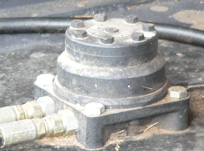

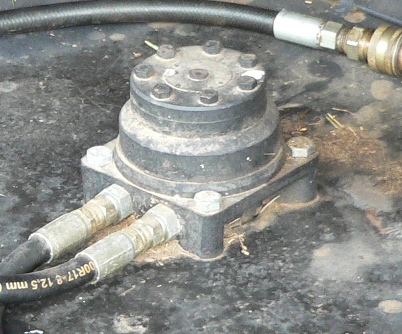

At some point, Power Trac made a significant change to the brush cutter for the PT-4XX series. The older model has the motor mounted up high with an obvious Lovejoy coupler above the deck. The new model, which I have, has the motor sitting right on the deck.
We have info from Moss Road on what he found when he took his old style cutter apart, but as far as I know, there hasn't been anything on the new style's internals. Has anyone taken the new style's drum assembly apart? Are they still using an automotive hub under there? I would love to know before I have to tear into mine. :)
/ Late Model Brush Cutters #2
I'd like to see a shot of the motor area a little closer and from the front.
I'll snap one a post it later today, if someone doesn't beat me to it.

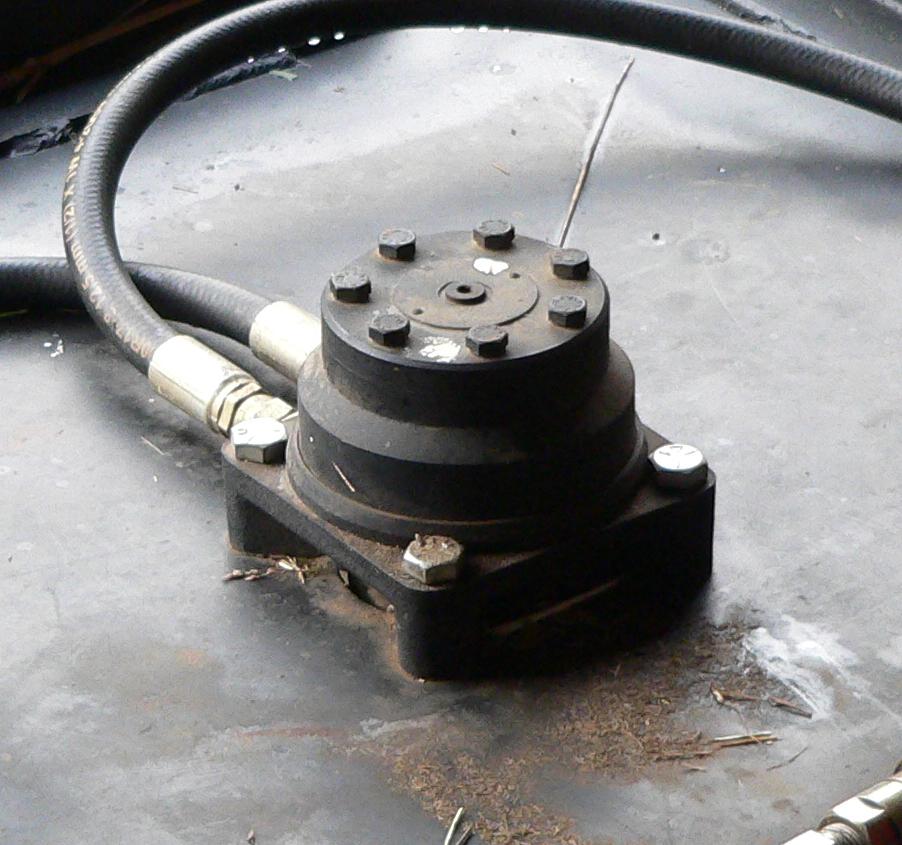

I guess it is later. :) Three views attached.

Mine is about a year old, but it looks a little different. The motor looks "taller" in my pic.
The quick attach is different, too. Yours looks lighter, and it is bolted instead of being welded.
Which model PT is that, 418 or 422?

Notice how it has those two straps bolted on? They look like guides so that the unit can tilt side to side, but not flex the pivot joint fore and aft too much.
They replace the welded on stops and let them use a lighter weight pivot shaft, you think?
/ Late Model Brush Cutters #13
I know that I appreciate the rubber Lovejoy in the drive coupling on the old ones... otherwise any shock to the blades is transmitted directly to the bearings and seals in the motor...
The limiters on the new QA/pivot do seem like a nice touch, though...
