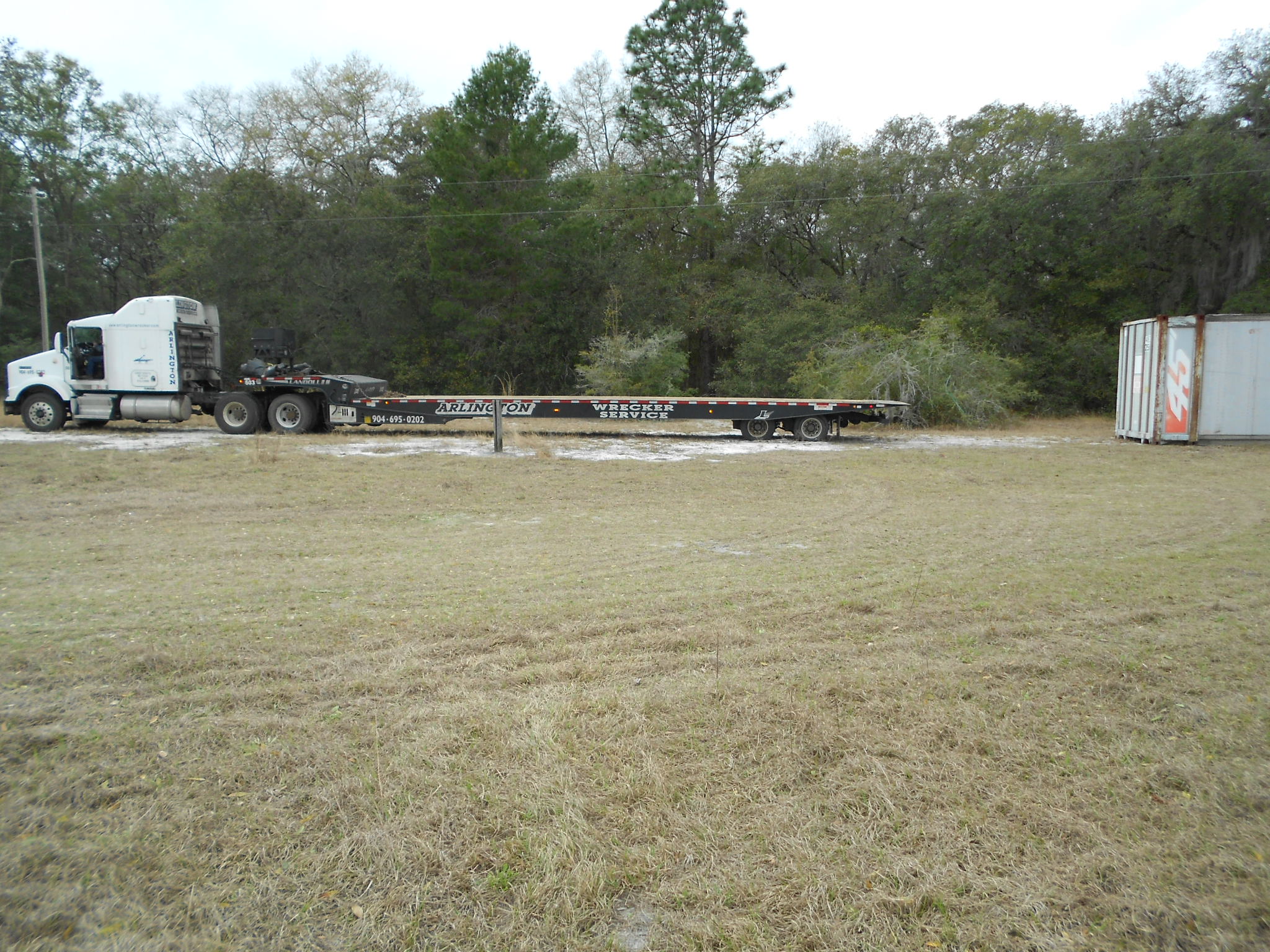

I bought this 48'er for $1500. off of CL and it cost me $450. to have it delivered 60 miles to my property.
I have worked on, moved and stored in containers for over 30 years.
After delivery I needed to build my shop so I had to move the container about 90' and turn it 90*. I hooked to the bottom pockets with chain and drug it to where I wanted it.
I stored my tractor in it until the shop was built, now a lot of misc. "Stuff".
They can be securely locked if they have the no tamper lock box.

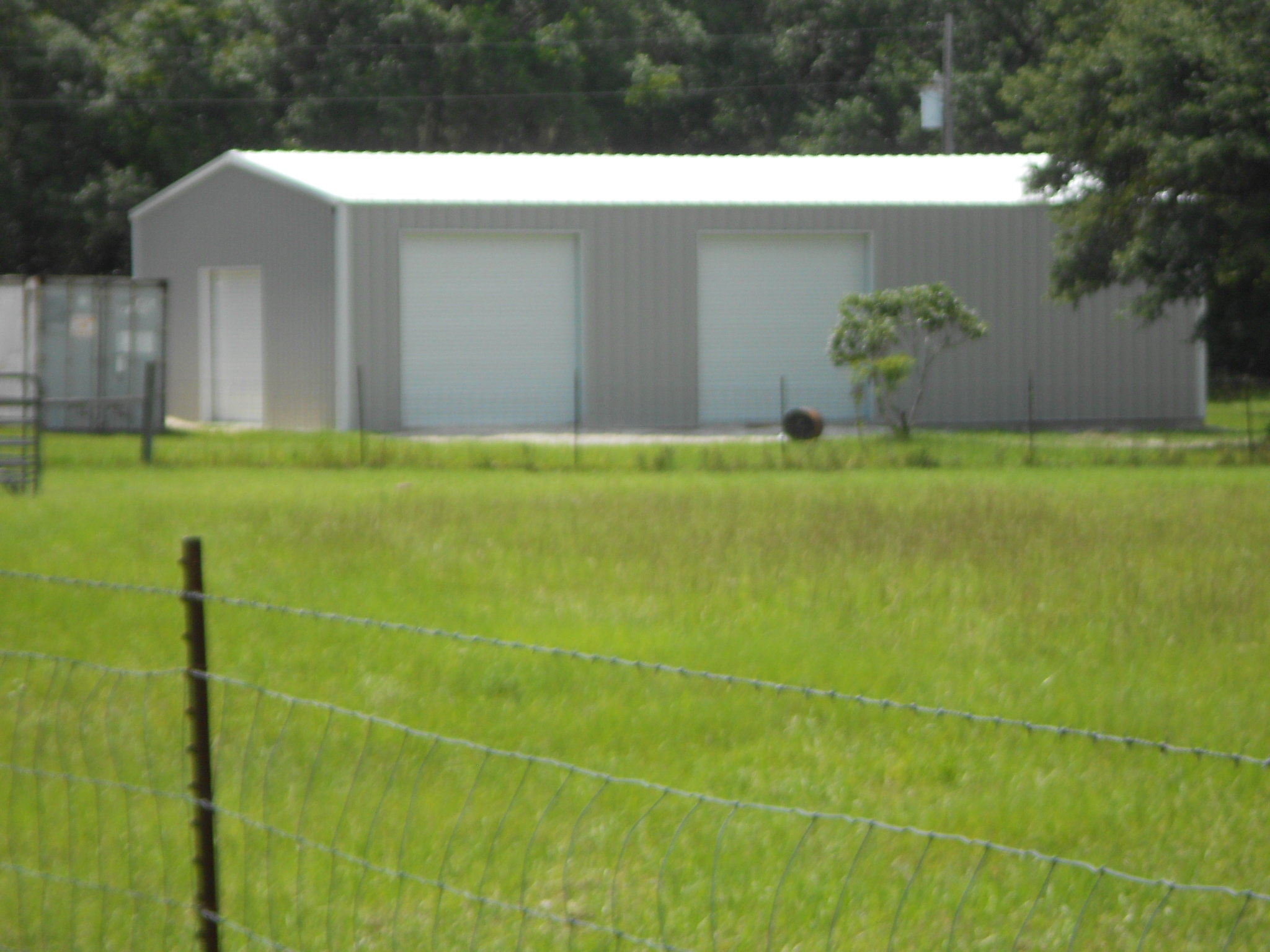

Appreciate the recommendations, I really like the modular truss system, I have found whenever I have an idea I google it and someone has already provided a better solution. The condensation issue is simply a result of warmer moist air being trapped in the container when the exterior cools. Thinking on this I am curious how containers shipped from the southern hemisphere at not dripping wet inside when they are opened up north. Venting would mitigate the problem but I always assumed the containers were air tight. Anyway...
I think I am leaning to just building a framed barn/shed, Kirk, I also was unable to contact the Multibox company. I will need to check with the county inspector to see what options are approved, anything larger than 200 sq ft requires a permit.

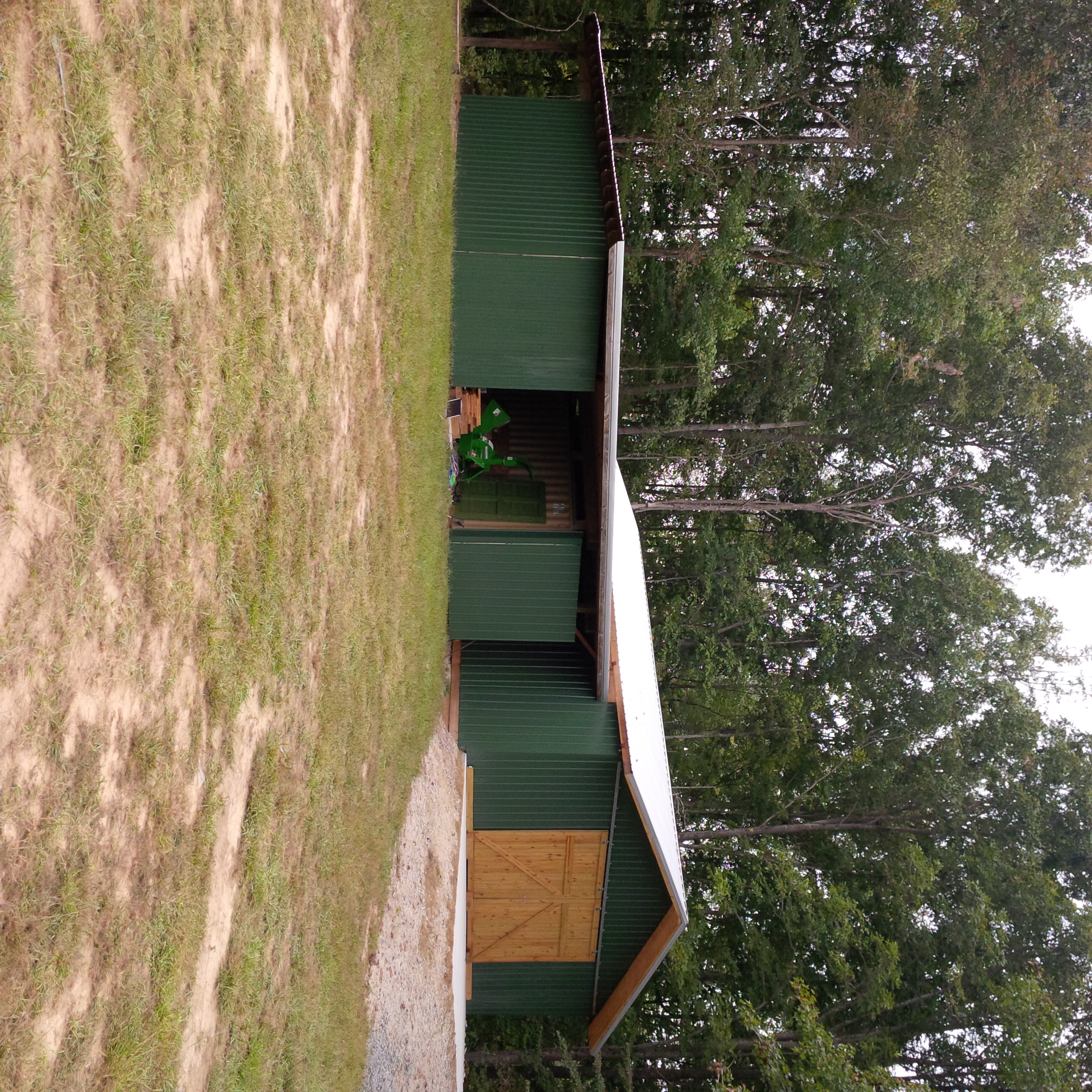

I used two containers on my unoccupied property for storage before I built my shop or barn. For me they worked great. The shop came later which is why I went with a lean-to roof versus trusses over the containers.
The small solar panel in the picture powers two small exhaust fans I installed in the containers. With the roof and the exhaust fans, I have not had a condensation issue.
