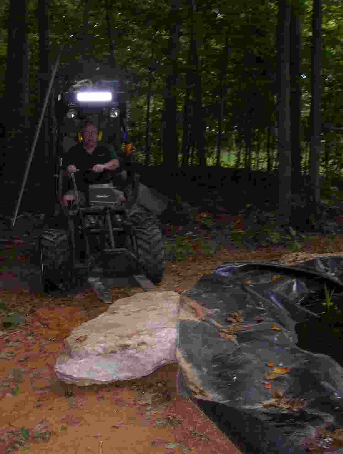

I lifted an 814 pound rock with my PT 422 using the forks. I did have to have somebody stand on my bumper on the back to keep it on the ground.
If you need to, flipping the rock with the forks can work. For final positioning I pushed the rock with the forks. This worked very well on a muddy surface.
