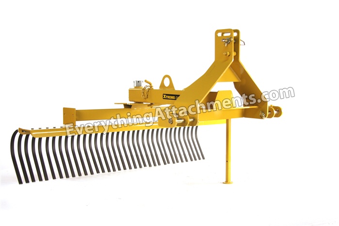

Can anyone point me to a web site or explain the proper way to adjust a landscape rake. I have a 7' Landpride with caster wheels. For the most part I use it to dress up and grade a sandy beach. I always seem to dig in too deep. Thanks for any help.
RPK
/ Landscape rake #2
lengthening the top link will make the angle of the teeth more aggressive or tend to dig deeper. You will need to balance the top link adjustment with the gauge wheel height to obtain the best results.

If you have caster wheels you can easily set depth with the caster wheels and height of your lower 3-point arms and let top link float.
/ Landscape rake #5
Do you need to run with the rake angled?
If not then I would suggest this:
  • Attach rake to 3pt hitch and raise up such tines just touch ground. You may need to remove pins/loosen bolts controlling wheel height.
  • Adjust top-link to level rake fore and aft.
  • Determine what depth you want the rack to go down. Grab a couple boards that match the depth. A 2x4 gives you either 1.5" or 3.5" for example.
  • Place boards under the already loosened gauge wheels and then secure wheels in place.
  • Do a short test run.
  • Adjust top link fine-tune depth.

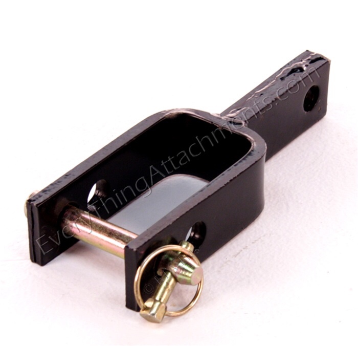

You can install one of these between rake and top link to get "float".
2x ...again, Rick! I actually discovered how well that works by accident when I installed Pat's Quick Hitch on my lower lift arms. They effectively make the arms about 4" longer and I got tired of screwing the top link out 4" so I made one of those 4" between pin centers. It wasn't until I hooked up the landscape rake that I discovered if I lift the 3ph just enough to rock the rake back onto it's wheels and pick the teeth up to the point they just touch the ground, the rake didn't follow what the front wheels of the tractor was running over.
