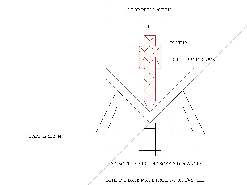

GuglioLS said:
J.J.,
The channel is 4" wide. The die I made is 4" X 4" square. Do I think it would bend 1/2" x 4"? On a 20 ton press it would be close, maybe right on the edge of it's limits. You are correct in that it did bend 1/2" x 3" hot rolled flat bar, the 20 ton air over hydraulic bottle jack was straining a bit. 1/2" x 4" would be a close call. If not, the width of the die could be increased to 5". I think for sure it would bend 1/2" x 4" that way, but of course the radius of the bend would increase a bit.
In the video you quoted me on, that was a test piece of 1/2 x 2.5" if you go back and listen to the sounds of the air motor on the test piece and compare it to the sound on the 1/2" x 3" wide bar (page 7 reply# 63) there is a noticeable difference in the load on the press motor. If I had a scrap piece of 1/2" x 4" I'd try it out for you to find out for sure. Did you still want me to make you an Anvil? if so I need a picture of your press and the O.D. of the stock anvil so as to machine one to fit.
Larry
LARRY, Can you do something like this?
/ Landscape Rake Build
#142
J.J.
How about something like this?:
The base plate is 6" x 6" x 3/4" thick (1/4 the size and weight of your proposed 12" x 12" base plate). It would still do job, be less costly in material and shipping plus more manageable to machine. Gussets could be welded on the ends just like I did to make my el-cheap-o die out of 4" channel. Is the 1" ID counter-bore at the top of the anvil correct? or does your press have a 2" OD stock anvil? OH and your idea to use a 3/4" Bolt to set bend depth / angle is a really good one. This design will produce a 90* bend without the depth bolt screwed in. I think this anvil and die combination will work just fine on 1/2" x 4" flat bar stock and smaller. I would still back it up with press plates underneath it. Let me know what you think........
Larry

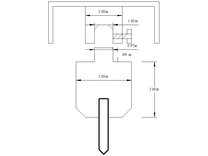

GuglioLS said:
J.J.
Larry
This is an update on the anvil after our talk this morning.
#145
J.J. - Hey your starting to get good at AutoCAD. OK I see exactly what you need now. Thanks for clarifying that. I will get right on it. I might make a few small mods to your design for ease of machining. I will post that after I draw it up for you to take a look and work at getting your stamp of approval. I told J.J I would call him around 9:00 to discuss the anvil he needs, well I got carried way blasting, it was 9:20 am. J.J. must have thought I forgot all about him, so he called me while I was right in the middle of this mess, it was time for a break and I'm glad he called so we could introduce ourselves and discuss the bending anvil design.
