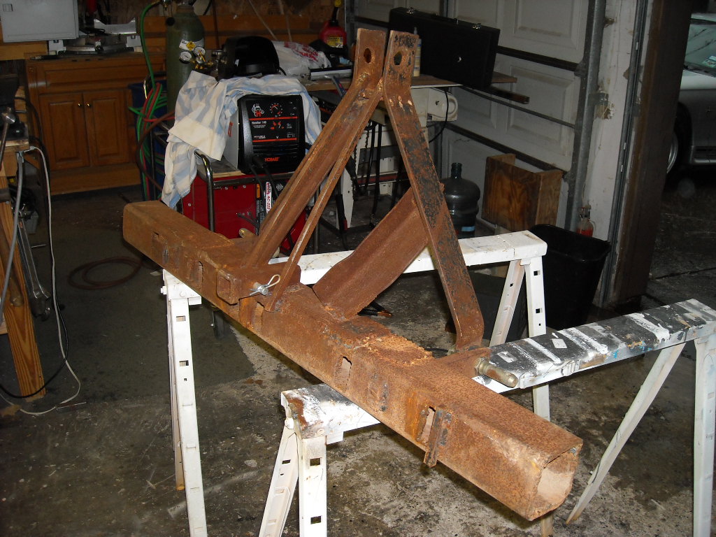

But this has got me thinking and I'm now building a rake, not near as fancy but it'll probably rake all the same. I already have the tines from Agri supply and some of the fab work done. I had a nice 5" piece of thin web channel left over from my trailer build, 5' long...perfect! I'll post some pictures soon. Mine will not swivel, still not sure I see the real need for that in my case, but it will fit into my multi implement tool bar!!
