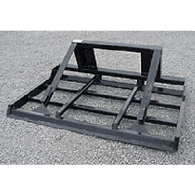

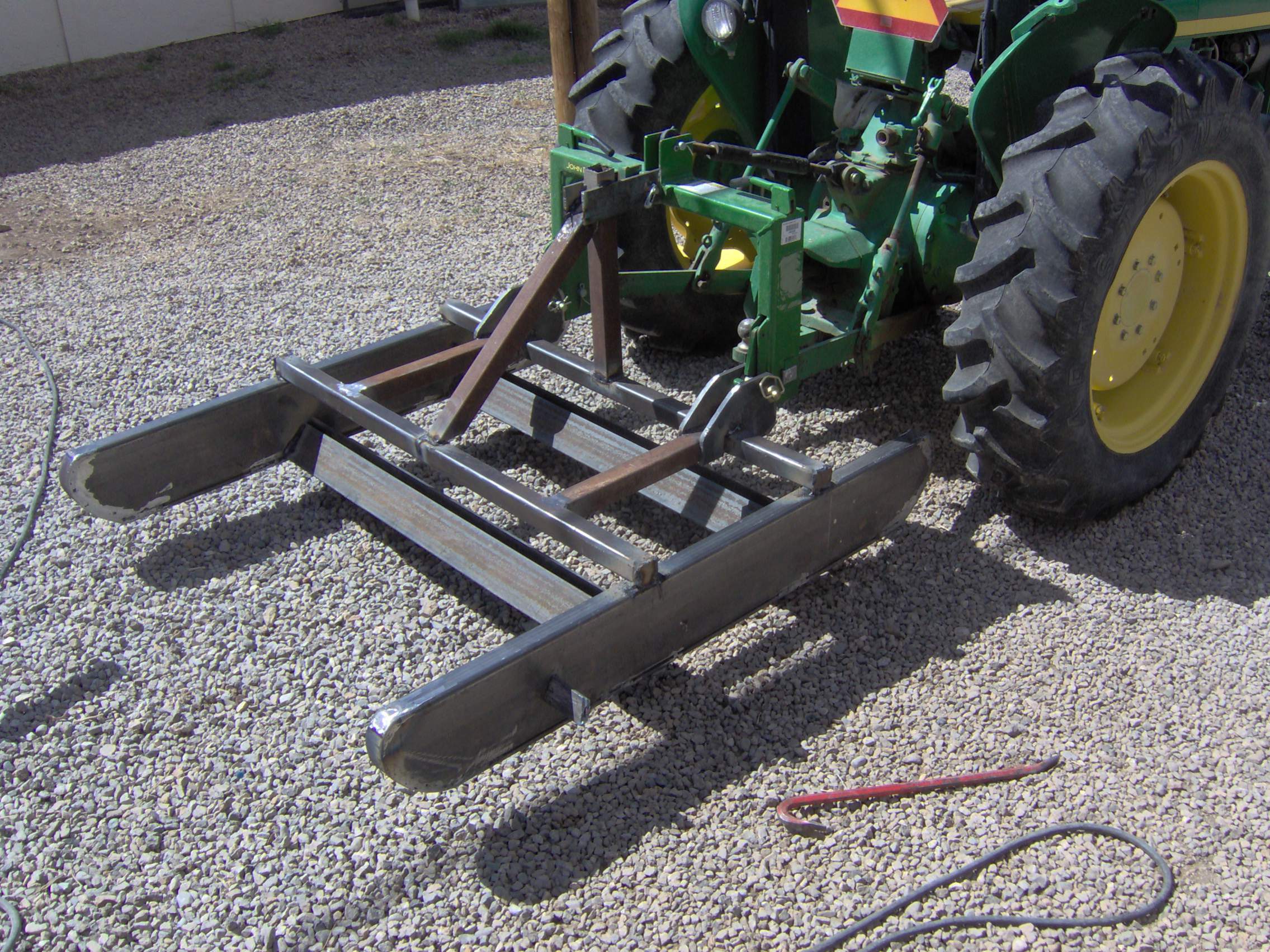

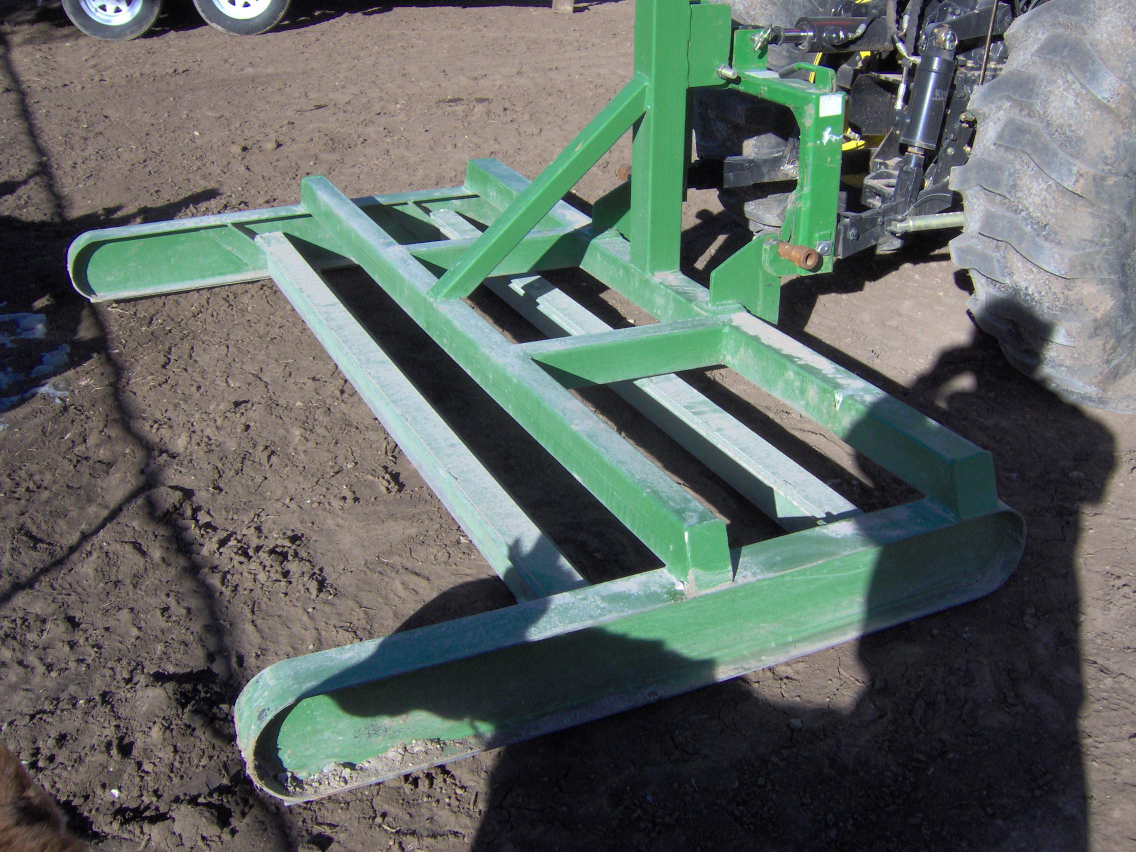

I have a heavy duty 72" woods box blade. Works good but I reall feel a landplane will be way better for maintaining my roads. So here are mybuestions and happy to take all comments? I am going to build this implement.
Anyone have one?
Push or pull? I am so tired of pulling butt think the pt arms are going to be an issue and oushupingbwill never work. But my runners should be quite long 5 ft at least.
I can pull the box blade unless I am on a slope and the box blade really loads up. I am thinking about an 84 inch wide landplane.

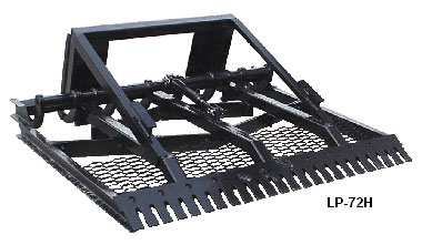

I'd look at some of the commercial ones available and copy their design.
(I ain't too original or creative, if you haven't noticed over the years :laughing: ).
I was always interested in the D.R. brand for smaller tractors. Perhaps a good place to start looking.
/ Landscape plane questions #4
Do some searching, lots of threads on this, bought and home built. Build it as heavy as your tractor will handle and don't get greedy with the width. You are better off with a heavy 6 foot unit than a lighter 7' unit. You are best off with no less than 150lbs per foot of width. Heavier is better, but your tractor will only handle so much.
Good luck

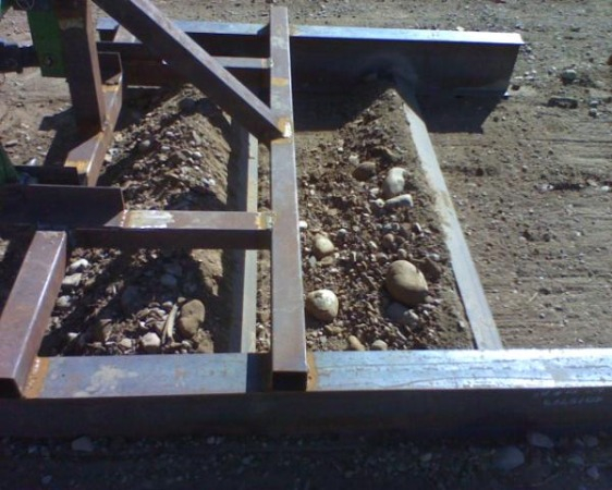

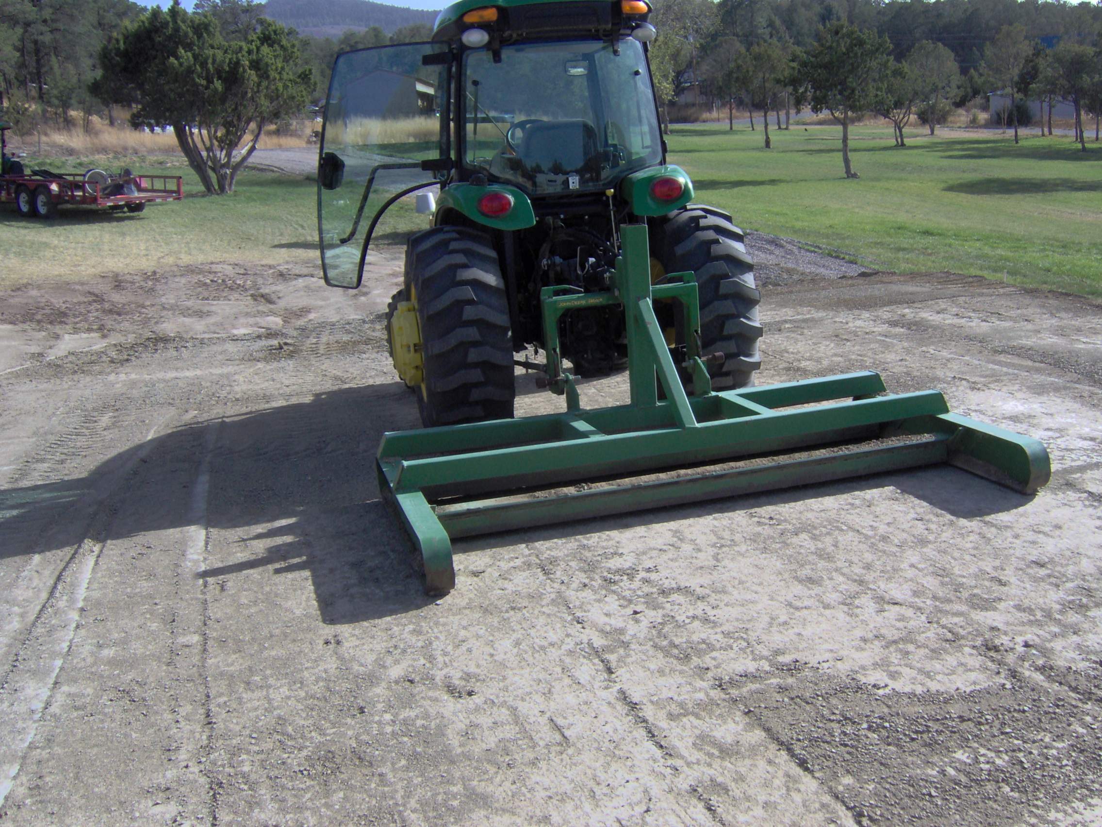

Thanks everyone. I have my design for the most part (Still struggling on wether to angle the cutting blades or have them run parallel, no one seems to have the straight answer on that).
But the killer for me is push or pull. Box blade will not work in push mode, I would love it if the landscape would, but I think that if it gets hung on something I am going to push over top of it. Probably better to pull it but this will make for a miserable mile of road I have to grade.
Carl
As far as I know of, every commercially built unit has angled blades. The home built units are common to have the blades straight. Why do you think that may be? It sure wouldn't be because it is easier to build with the blades straight, now is it? :rolleyes:

Based on my experience, I think that you want the cutting blades in a multiple chevron design <<>>. This will redistribute and level the material the best. As suggested by MtnViewRanch, keep it heavy enough to dig in. To break up bad ruts or potholes, you may need to scarify a bad section first before using the land plane.
Finally, a little clay or fine rock dust will go a long way to permanently keeping your roadbed solid, and keep potholes from reforming. Many people make the mistake of filling the potholes only with larger aggregate, which then creates a holding space for water that vehicles dislodge, carrying the binder (rock dust/fines/clay) out of the roadbed, making the pothole worse.

If the commercial ones were built both ways, and both types stocked by dealers, I think most buyers would buy the angled ones, thinking it will build a crown better. But some users of angled ones say there is almost no sideways movement of material.
Others build straight ones because they intend to use it for leveling and don't want sideways movement of material.

Because your going to use it on a P/Trac, there are a lot of differences over using it on a 3pt hitch on a tractor. I can understand why you would want to push, but have my doubts on it preforming the same as behind a tractor. Sooooo.... why not look at it like a Pond Scoop and make it reversible? It would only take a little extra material to make it reversible, I would think, though I haven't looked closely at the P/Trac attachment points.
Just a thought...
David from jax
Mine was built with angled blades, and I am glad of it.
/ Landscape plane questions #14
#16
I assume it is the odd geometry that the PT has, but pushing has issues. Iwill indeed make mine reverseable, and aim to push but the PT tends to climb up a pushed device. Not sure why, but box blades end up being a pita.
I found most of my steel in my neighbors junk pile, along with stuff for a welding table so I am pretty stoked.
More to come as I move forward on this project next week.
Carl
/ Landscape plane questions #17
One of the reasons that the PT does not push well is that the push points for the loader arms are about 36 in off the ground, and tend to ride up.
I believe if you push low or pull low you will accomplish more.
I have a push point on the bottom front of my PT, that is used for my flail.
If you put the two angle points down, you should be able to push or pull equally as in my third picture above.
