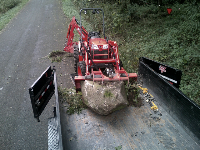

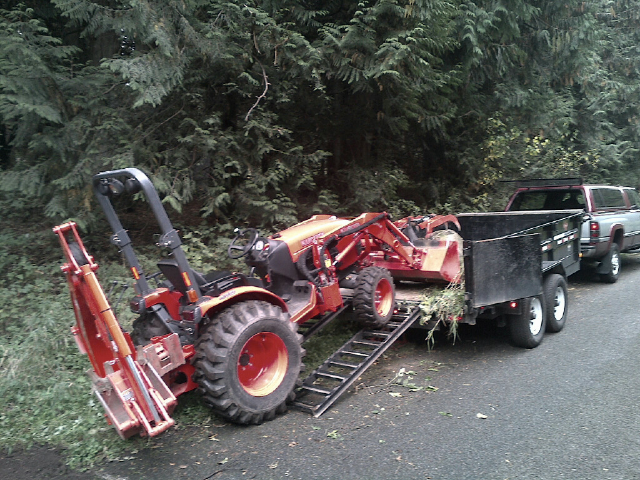

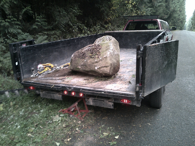

Shatter... that is awesome! What size tractor? And could you lift that boulder? Any idea of its weight?
B3300SU, I was barely able to lift it. I think my spec is 700 and something for lift capacity so probably right around 700 lbs and then if you use one and put to hard work like I have you will bend a tooth every now and then. To help control heavy loads in my bucket I will usually use some chains to keep it tight while moving large items.
   / Landpride grapple for SCUT? #56
Very impressive! :thumbsup:
That bent tooth just gives a wider grip. :D
