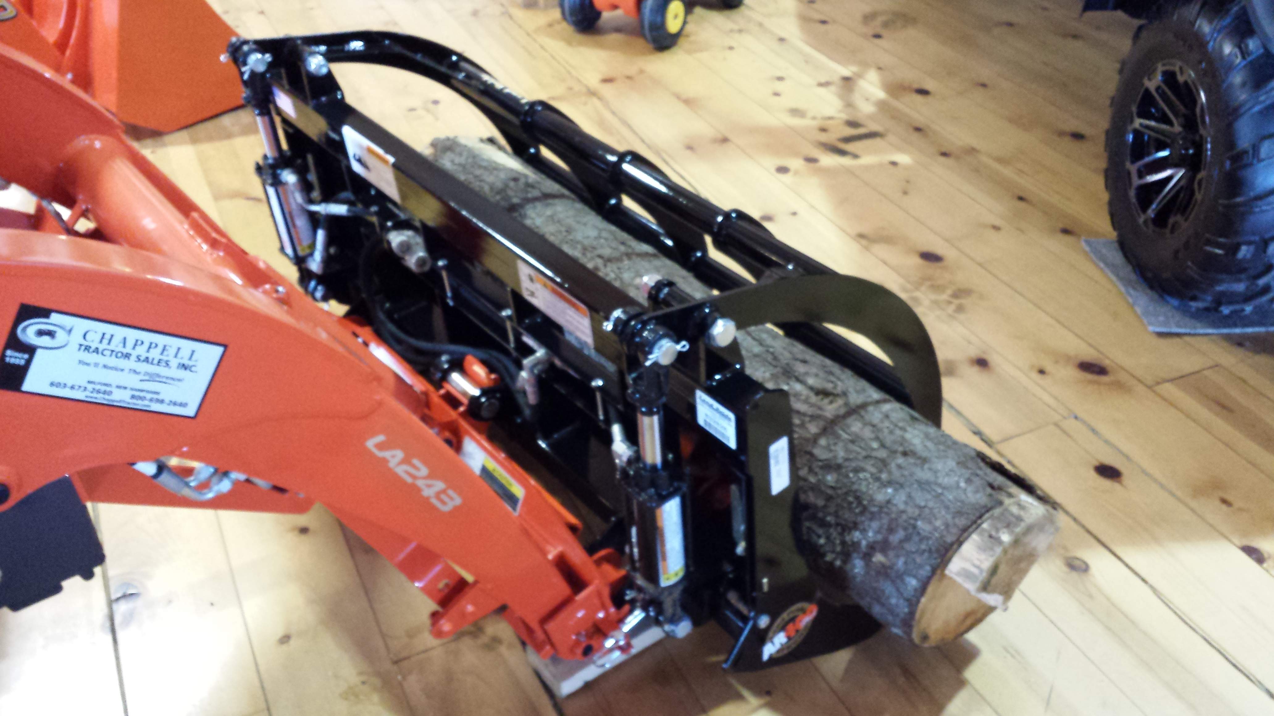

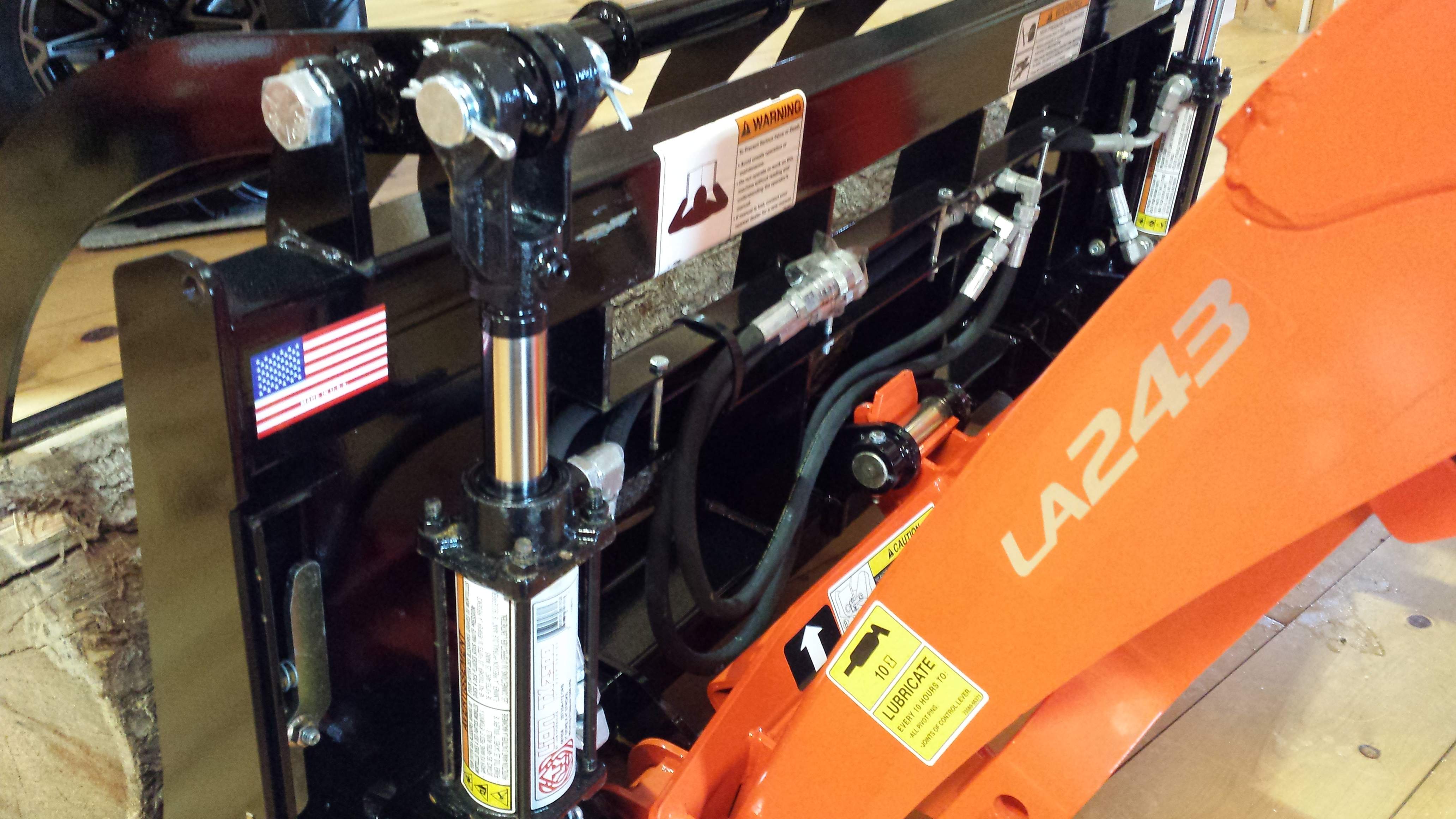

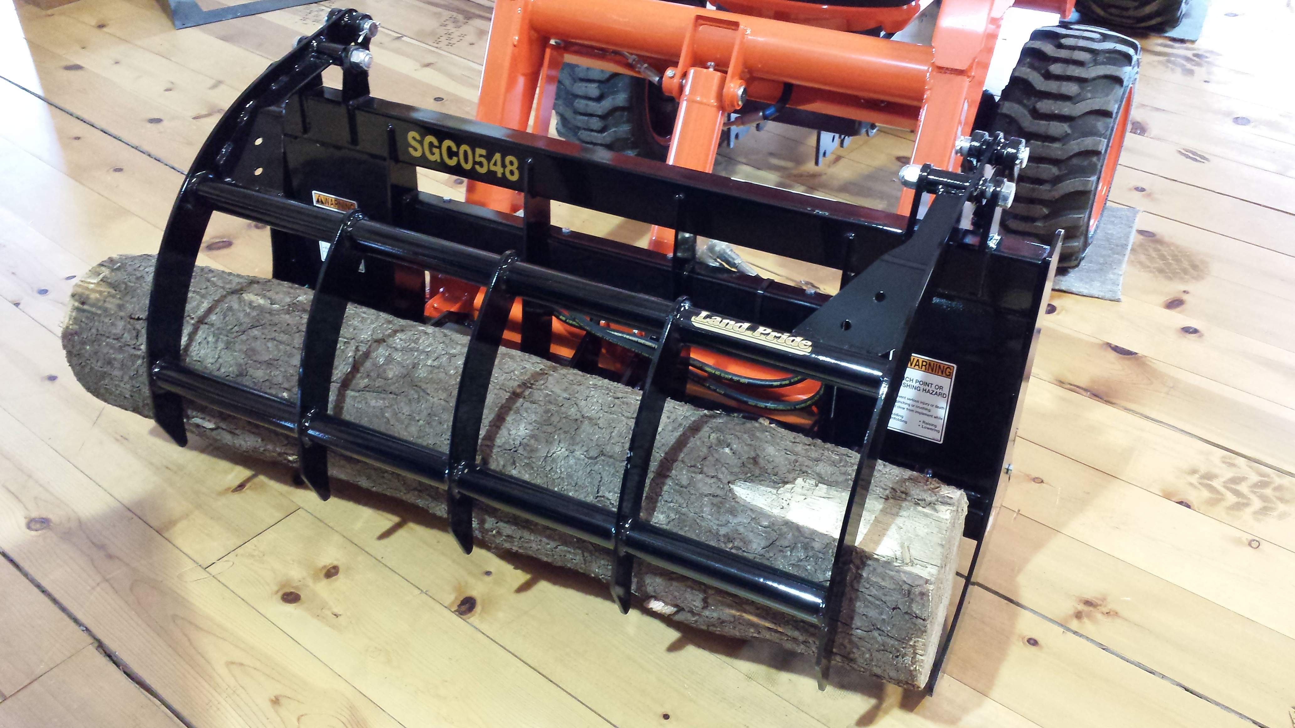

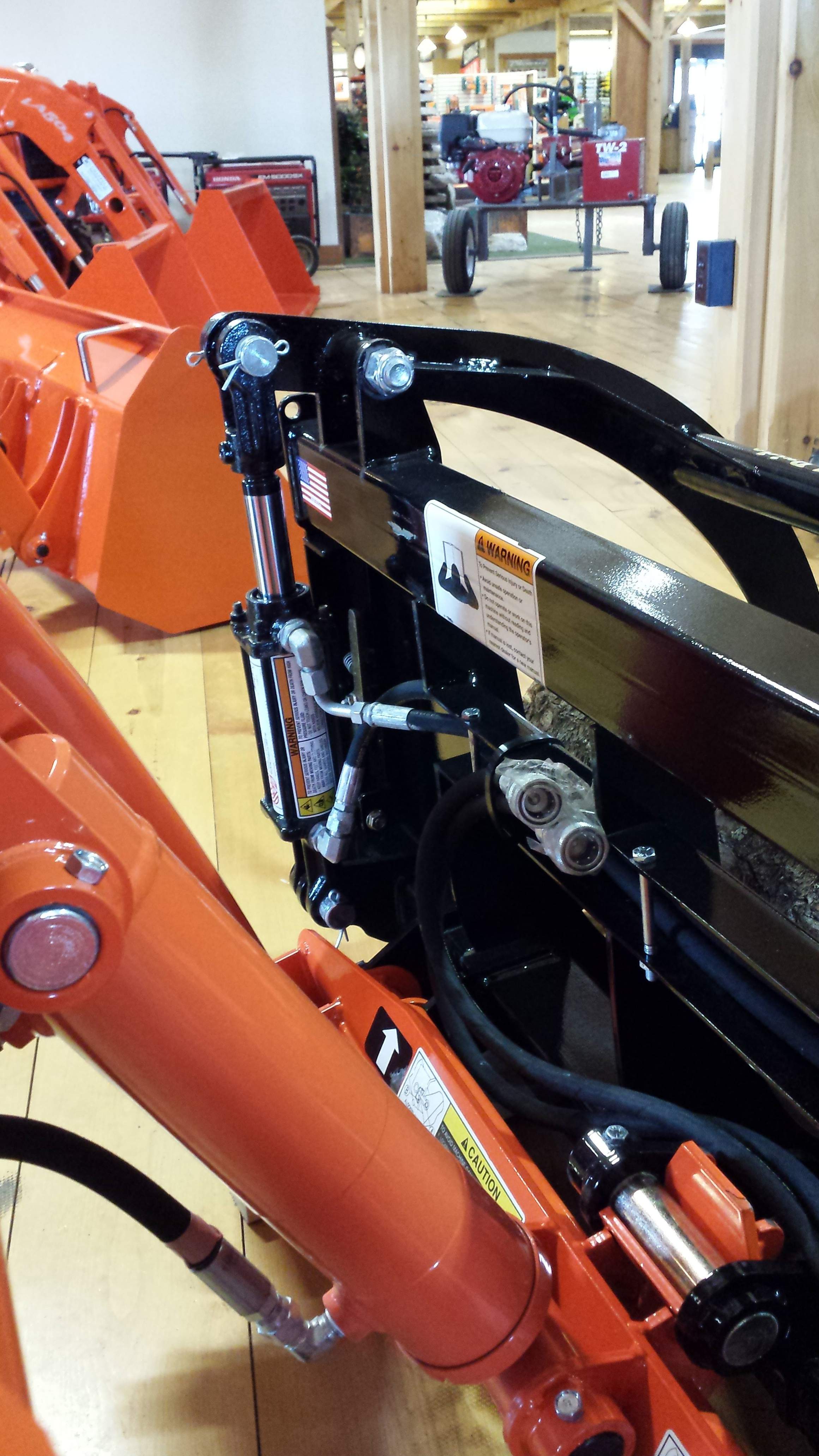

Well, bought the first Landpride BX-compatible grapple in New England today. That was what the salesman told me after talking with his regional LP salesman today, who was apparently on prem at one point while I was there. Anyway, right now it's sitting in the bed of my truck since I need to switch out my frame mounted snow plow for the FEL so I can get it out of the truck. It'll be a while before I install it since a) it's **** cold right now and I don't have a heated shop/garage, and b) looks like I'm missing some parts now that I have it home and have looked it over.
Along with the grapple itself comes a burlap-type bag with the hydraulic hoses, directional valve and joy stick control. For sure there's no owners manual/installation manual included, and I also think I'm missing two male QC's that install on the top of the directional valve. The hoses that route out to the FEL torque tube have female QC's on them for hooking to the valve, but there are no male ends on the valve itself. You have to have QC's there so you can remove the FEL and have the hoses go with it. Will be calling the dealer back tomorrow. Also, the on-line instructions I downloaded look a little confusing at points now that I have the hydraulic components in front of me, but more on that when I get into it I guess. Oh, one other observation - the two hydraulic cylinders on the grapple don't have any zerks for greasing the pins. Thought that was odd, but we'll see once I have it operational. Guess I'll just take the pins out and grease them before I use it.
And now for some pic's! These are of the grapple mounted to a BX on the dealer's showroom floor. It was only mounted to the FEL via the Kubota QC adapter - no hydraulics hooked up or the new joystick, which is a shame since I wanted to take some pics of those hookups to help me with installation. Still, these should add to interest here in this new BX toy, er, tool.

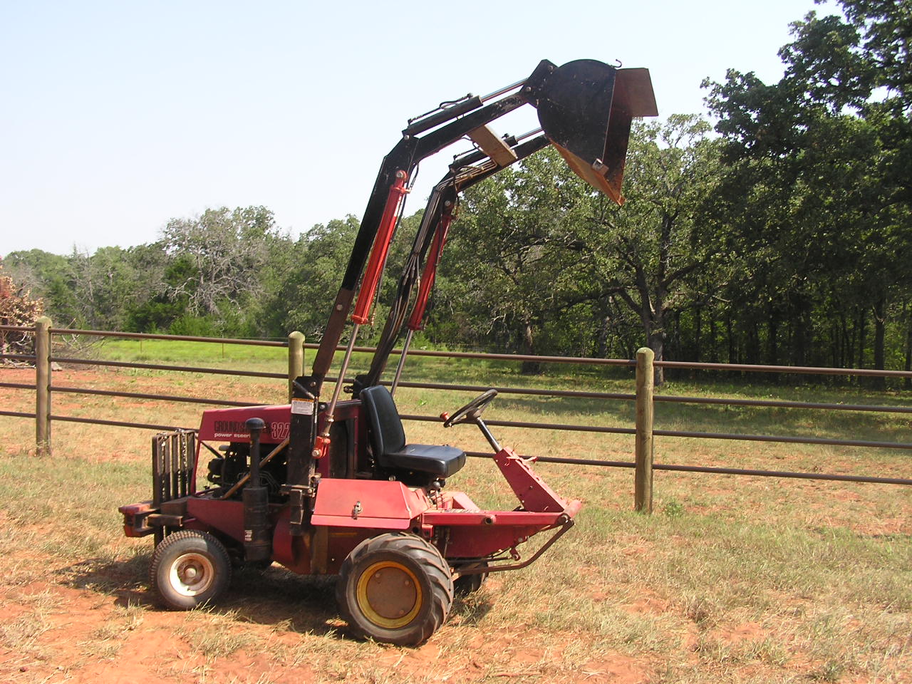

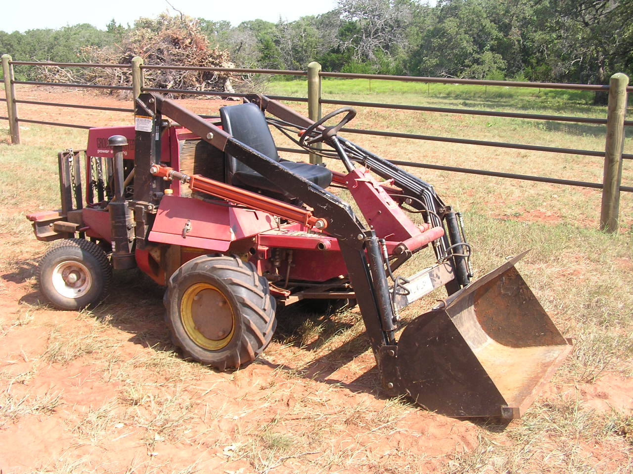

I demanded a pin on subcompact grapple for my TORO+Loader last year (http://www.tractorbynet.com/forums/showthread.php?t=283444&page=2&p=3361844#post3361844 ), but the demand was ignored! :shocked: :laughing:

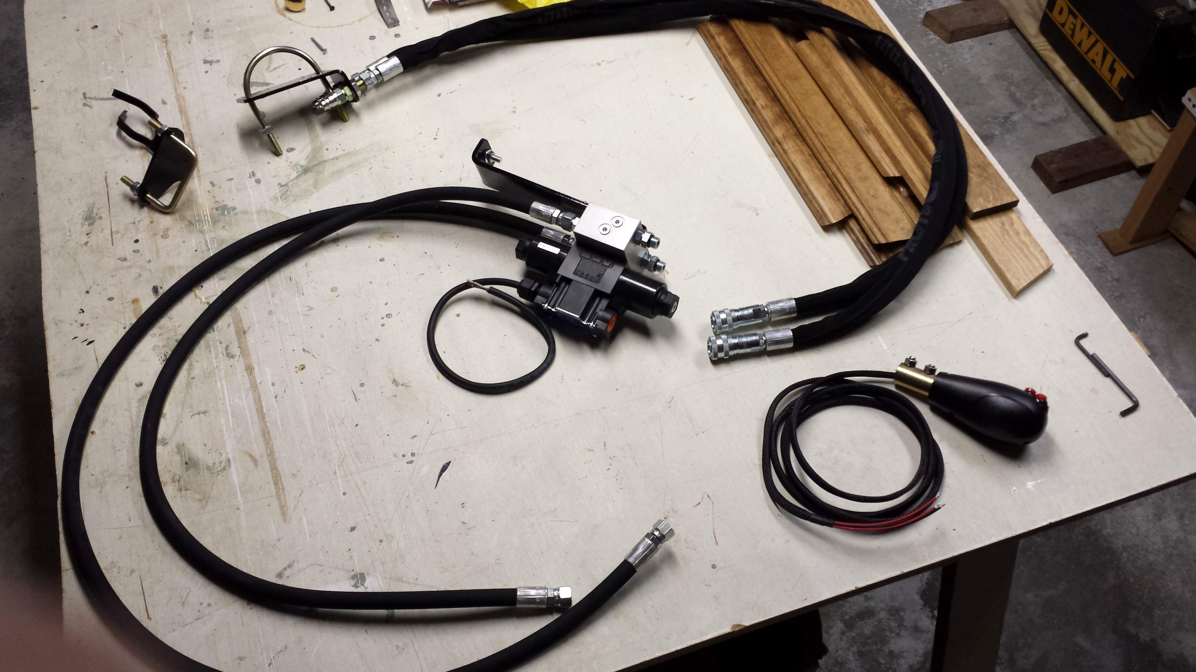

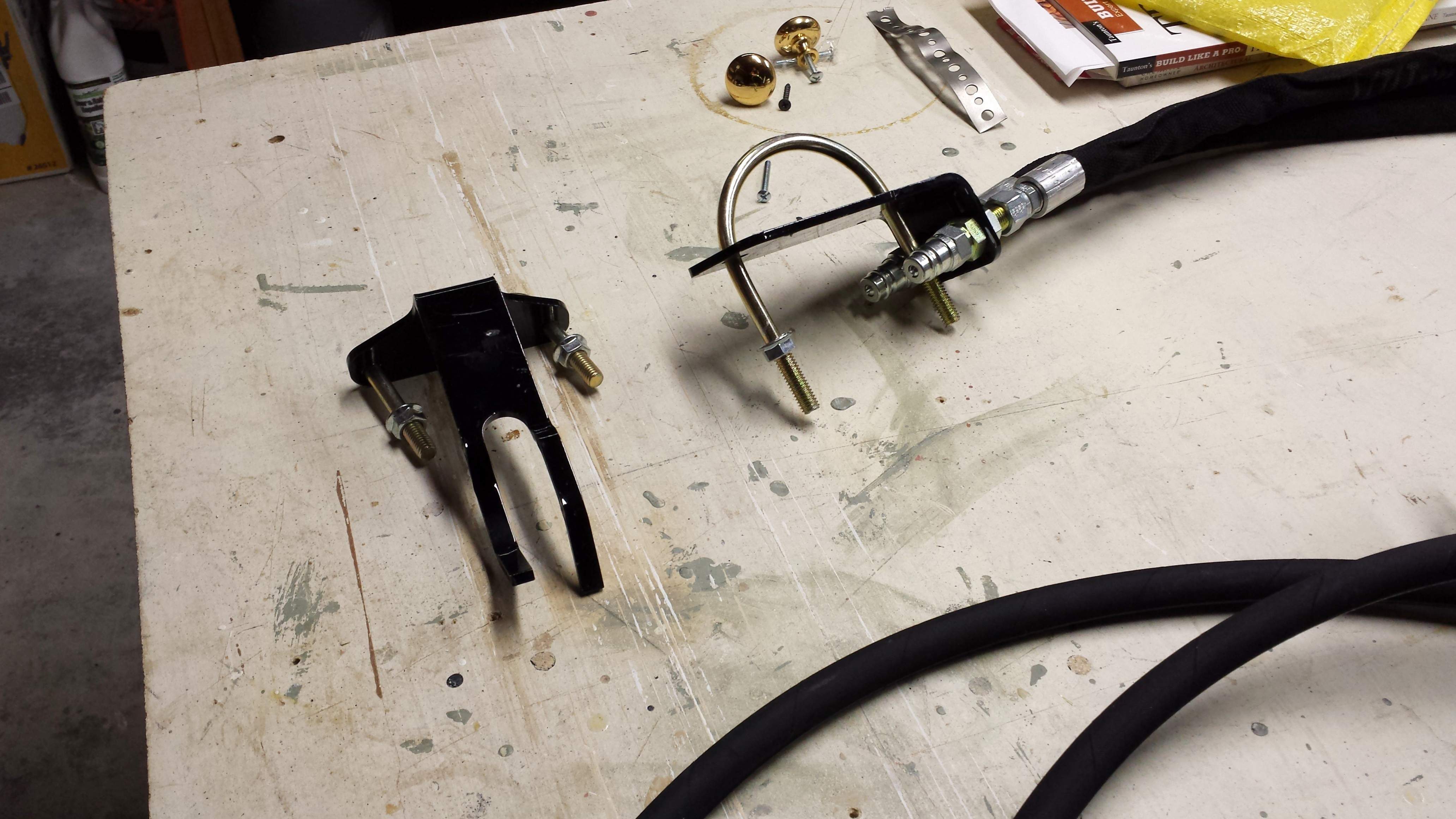

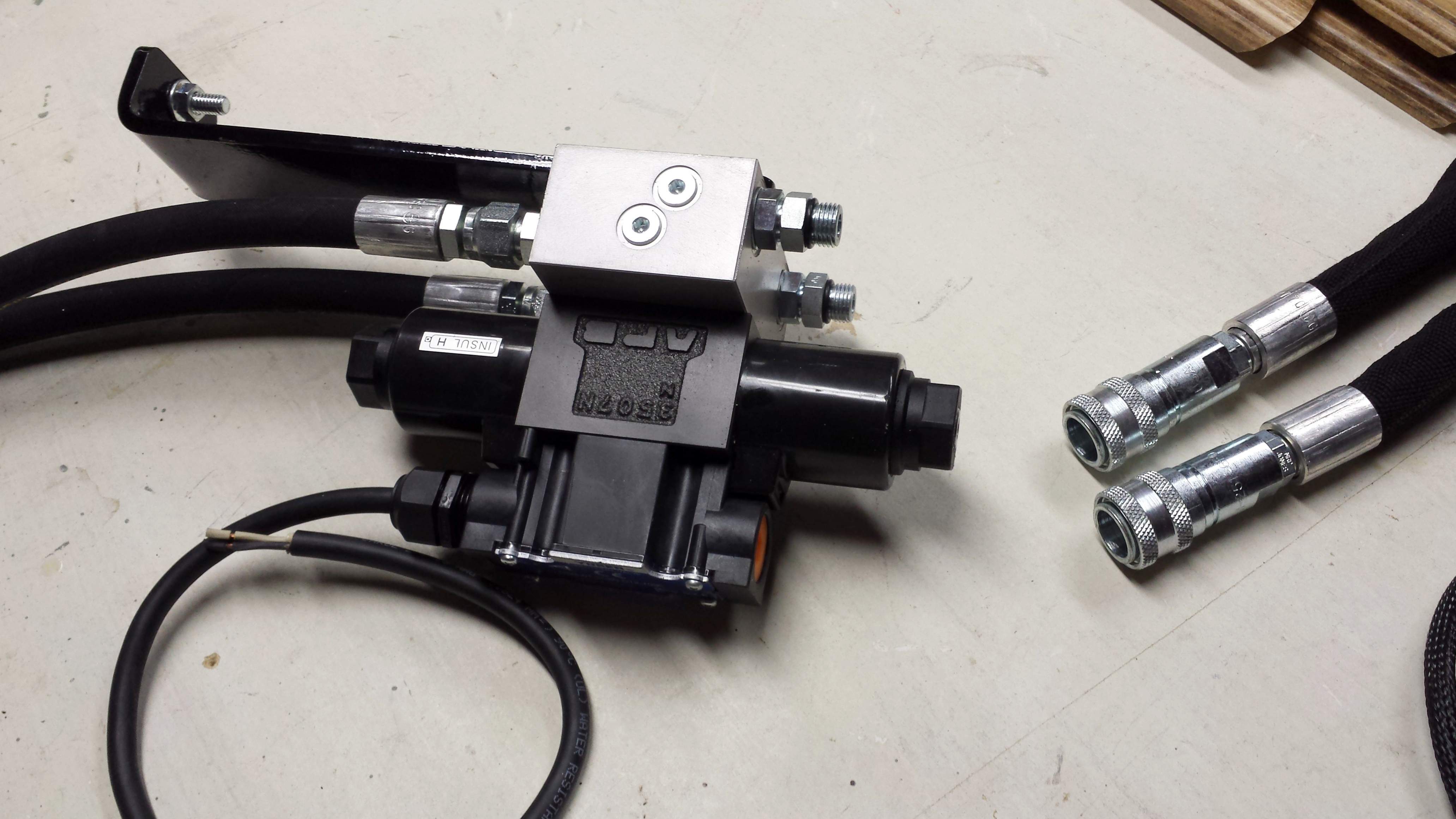

A few more pic's for your enjoyment. Here's all the hydraulics, valve and mounts that need to go on the tractor to operate the grapple, plus the new FEL control handle with the two buttons to open and close the jaw. In the first pic, you can sort of see how the hoses connect. The hoses with hose protectors and female QC's on one end get hooked to the top of the directional valve, but as you can see, there needs to be male QC's on the valve itself - these were missing from my parts bag but the dealer is having them drop-shipped this week to my house. The other end of these hoses mount to the FEL torque tube with the rounded U-bolt. The other bracket with the square U-bolt gets mounted down the end of the loader boom and those scissor-like forks hold the hoses from the grapple in place.

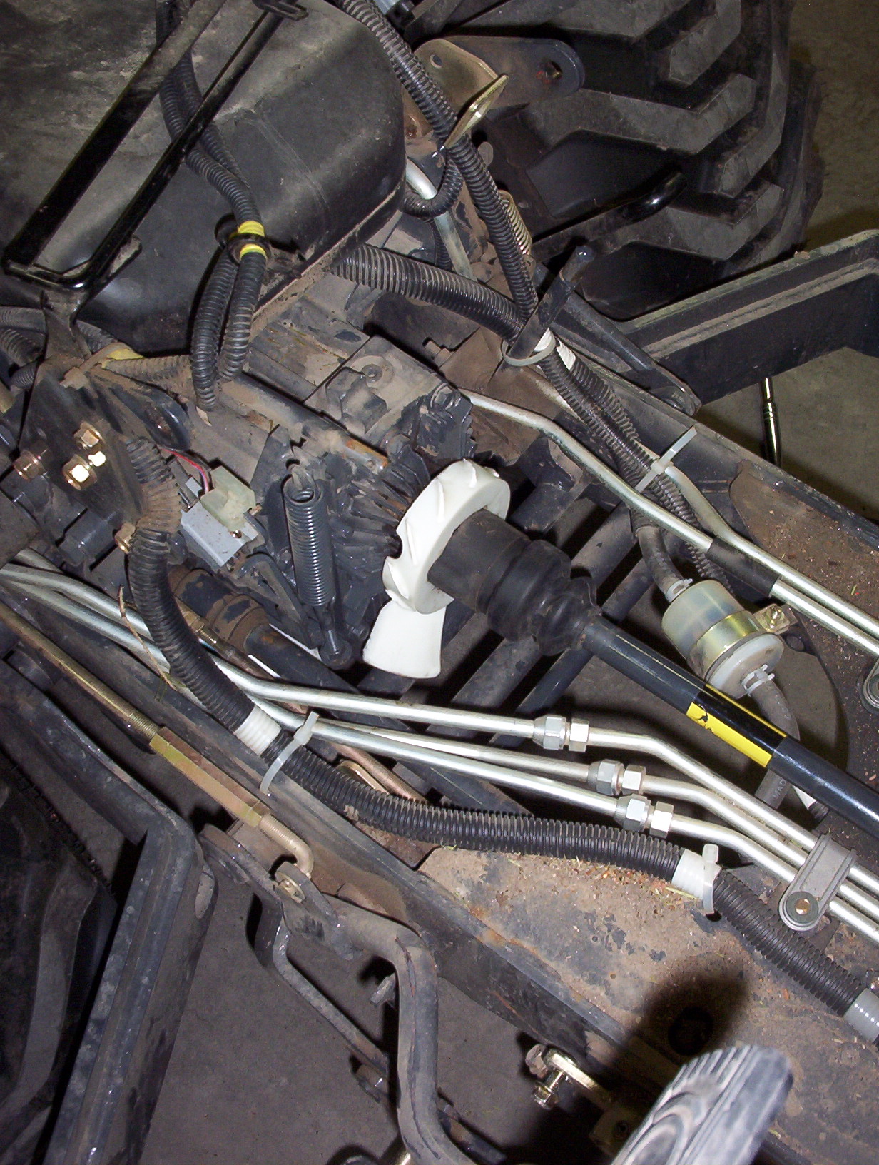

Now as for hooking the valve into the power beyond circuit, this is looking more involved than I hoped. The manual only says to remove one of the pipes on the PB run and connect the two hoses (without hose protection) into each end - one end at the hydro block, and the other onto the PB pipe that remains on the tractor. Unfortunately, from this pic I found elsewhere on TBN (thanks dmacneil) it looks like I'll need to remove the floor board to get to the other end of the pipe. You can see the pipes have a "splice" under the tractor, which is inside the frame and not very accessible. I'll take a look to see if I can get at this pipe from underneath, but I have the Bro Tek skid plate on which may have to come off anyway. Anyone know if the floorboard/pan can be removed easily? Never tried to remove it - no broken fan blades so far thank goodness.

Chris, how many $$$ do you have into it so far and do you think you have everything needed for install (including the male QCs you are waiting for)?
