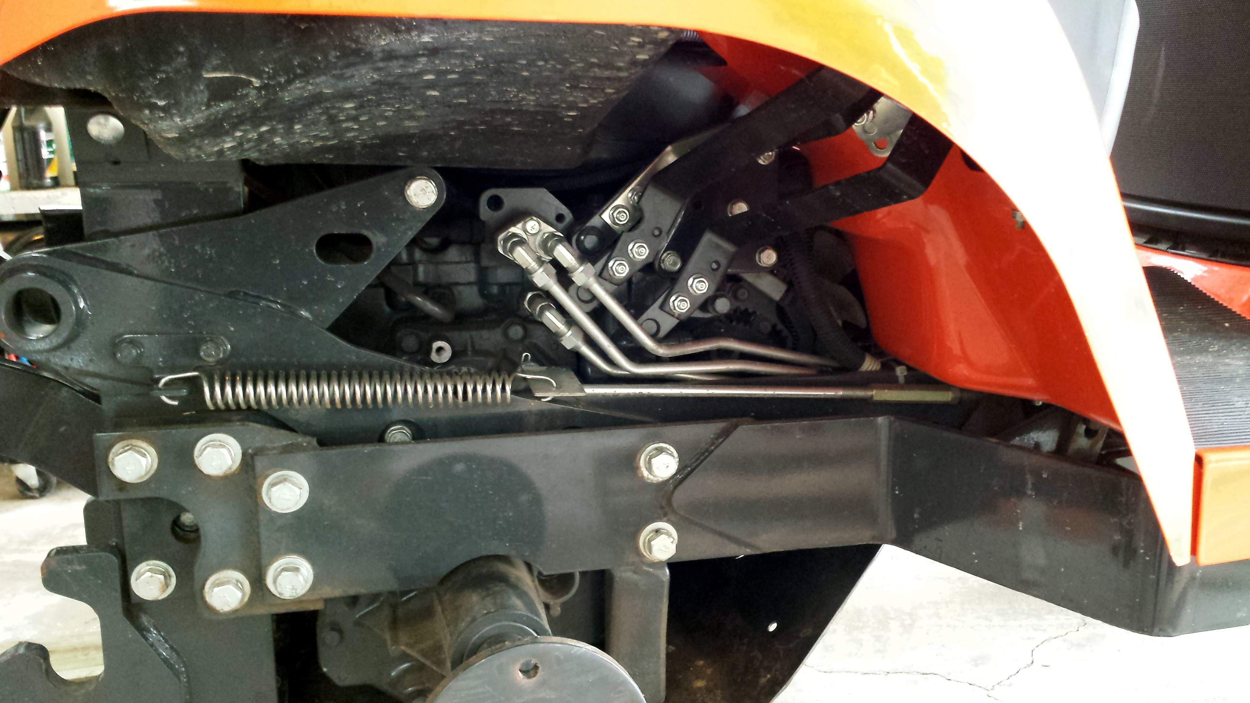

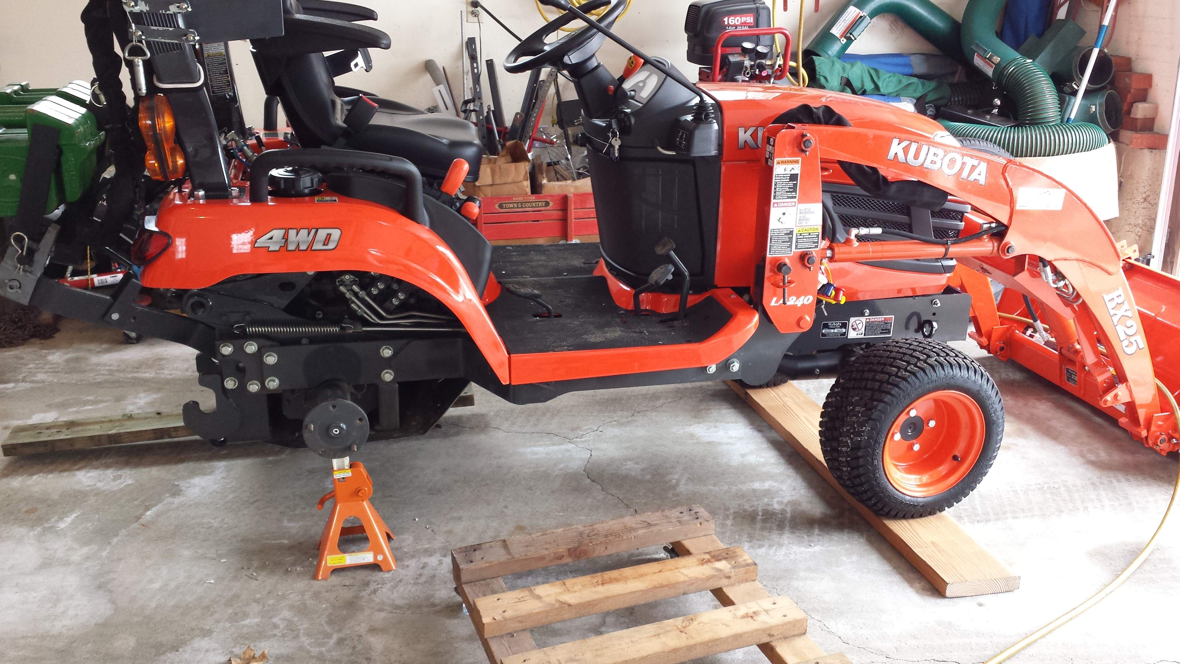

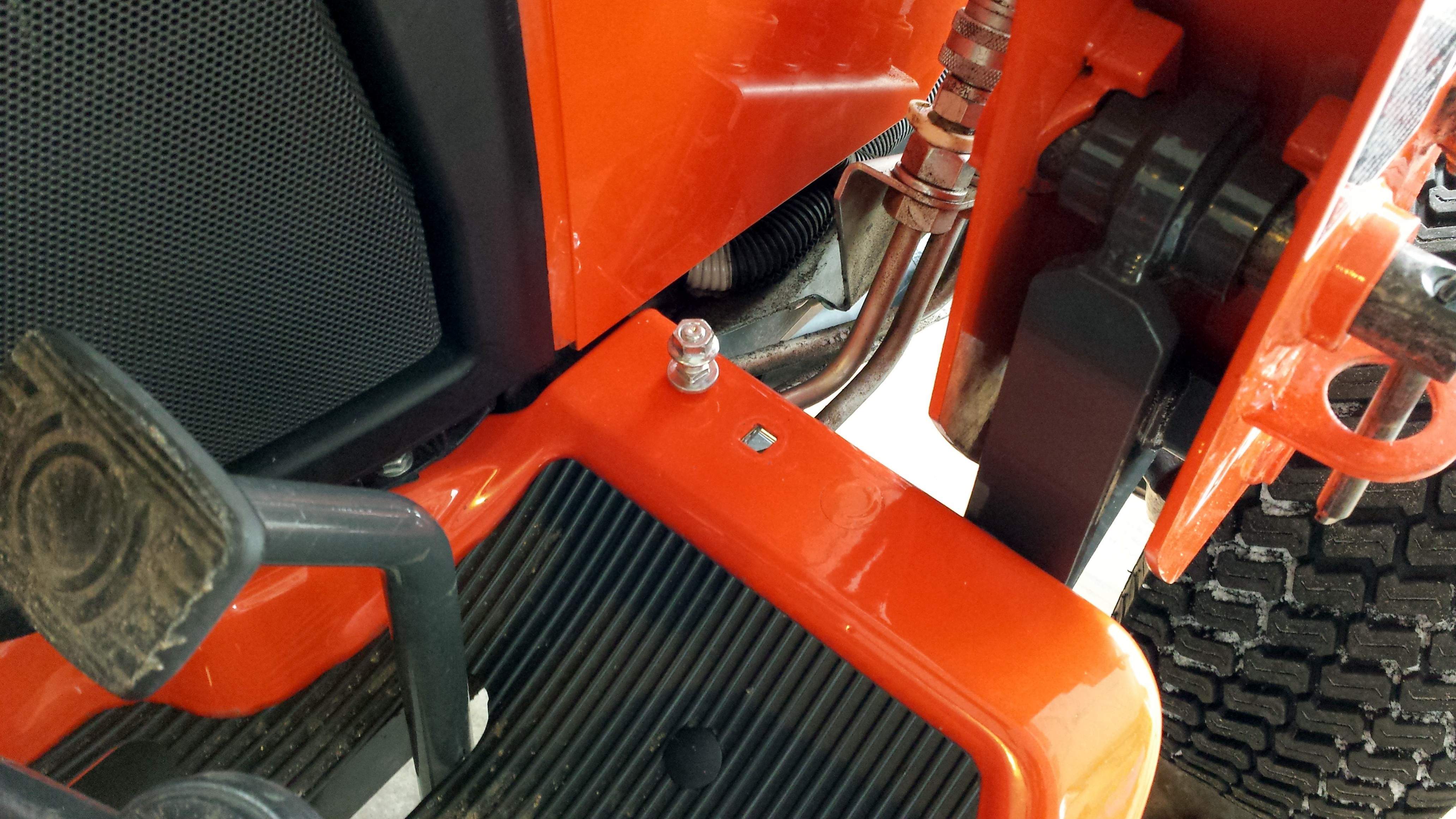

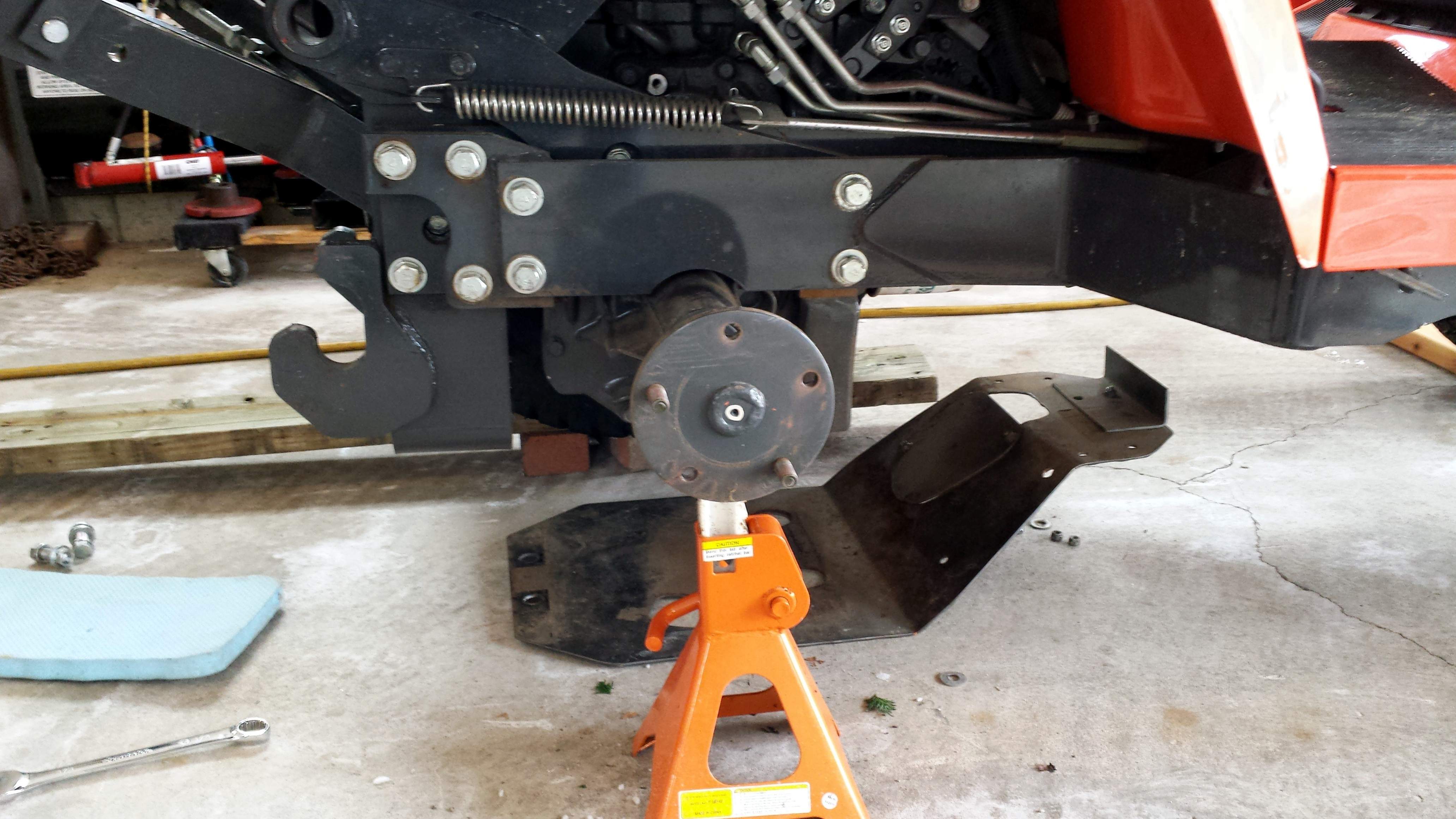

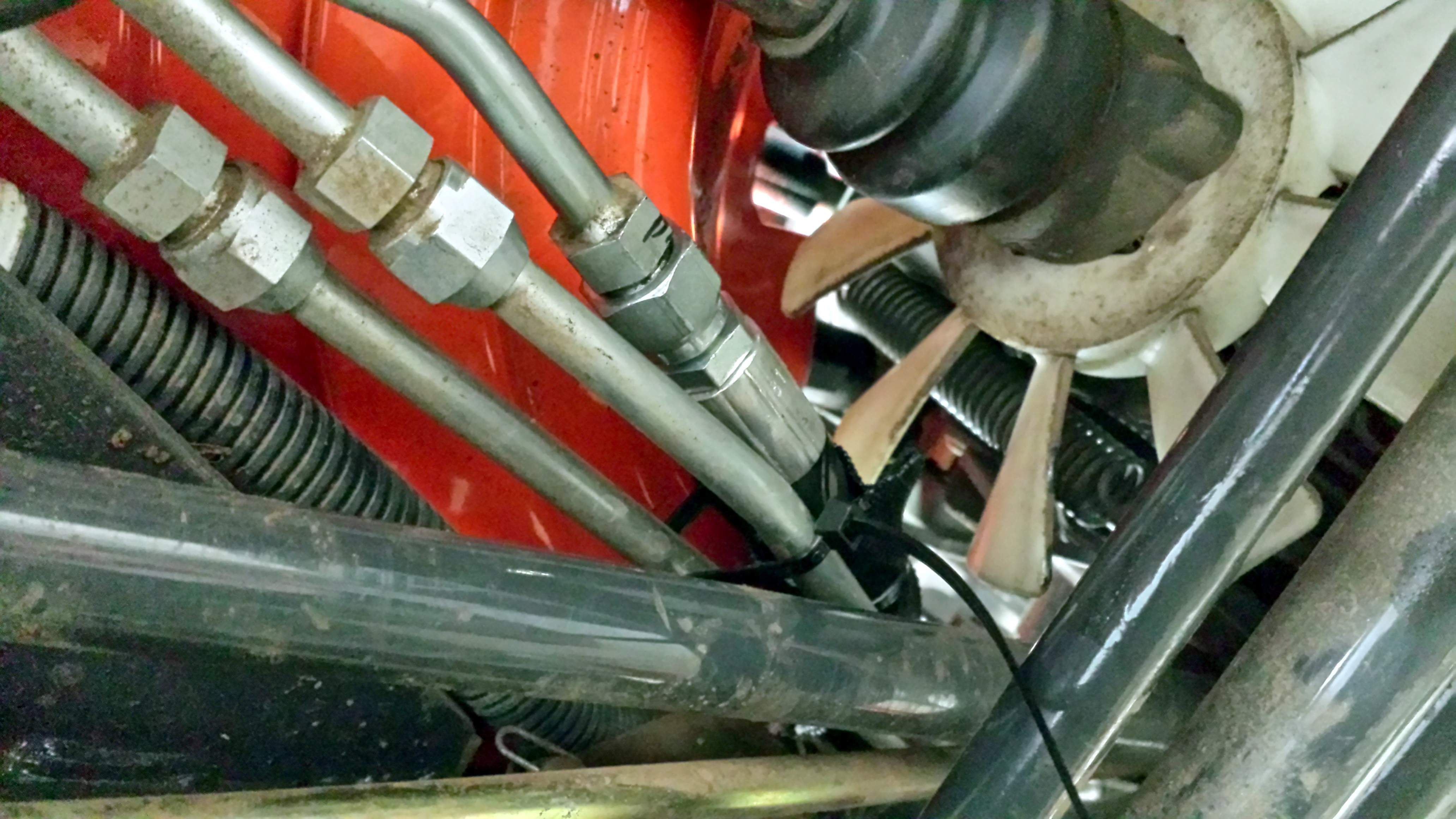

Well, since it was above freezing today (about as good as it gets these days), I decided to attempt the valve installation. It went pretty well on the whole. Maybe three hours of real work involved. Started off by blocking the tractor up as high as I could so I had some room to get under it to remove the skid plate, and also, later to remove the PB pipe and hook up the new hoses. Maybe the hardest part was routing the hose around the valve and down under the tractor. The hoses are relatively stiff (good quality I suppose?) and while they tell you to route both between the valve body and engine side panel, I just couldn't get the valve mount to sit down flat on the deck in order to get the bolt through it. Ended up routing one on each side of the valve mount and also, I reversed the valve mount so it moved the valve body further away from the brake pedal.

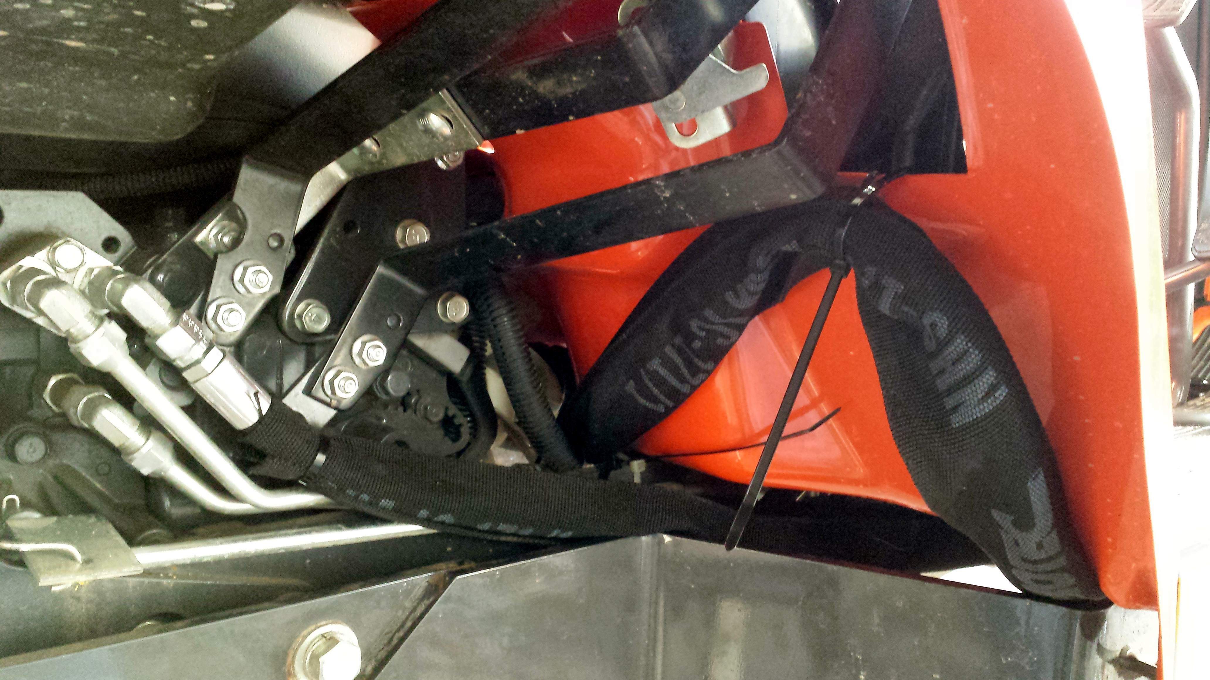

As far as which hose goes where, you have to pay close attention to the diagrams in the instructions and rotate them in you head so you get a picture of which hose is which based on how you're actually looking at the tractor. Having said that, let me cut to the chase for you. One of the hoses is longer than the other. The short hose hooks up at the hydraulic block and the long hose hooks up to the PB pipe under the middle of the tractor. One thing to watch is how close the long hose comes to interfering with the cooling fan. It's a tight fit given the hose has a much larger diameter than the pipe you remove. I had to zip tie the hose real tight where it routes past the fan to make sure there was no contact. The hose protectors I put on actually compound things a bit right there, but I got it secured with no interference.
After mounting the valve and making the connections, I tepidly started the tractor up hoping not to hear any unusual hydraulic noises, or see any leaks. Started fine, sounded normal, and the FEL and 3PH moved like normal, so I think I'm good to go. Of course, I won't know for sure until I have the grapple on and actually go to use it.

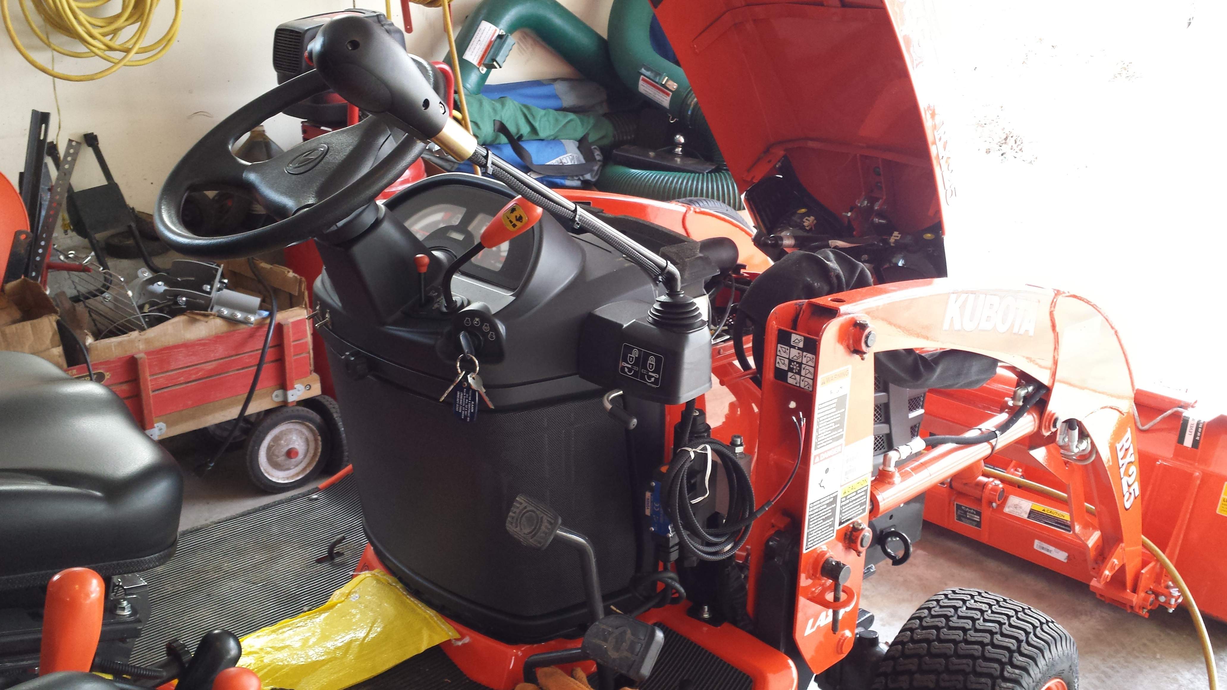

I also mounted the new joystick handle. It's noticeably larger than the OEM one, so I had to cut about 1.5" off of the joystick rod. I do like to be able to get back on the tractor from the right side now and then, and I can just make it with the new JS. However, after some use, I may cut off another inch or so. I still have to make all the electrical connections and hook it up to the battery. May get to that this weekend. Anyway, hit me with any questions if you're contemplating buying one of these LP SCUT grapples.
